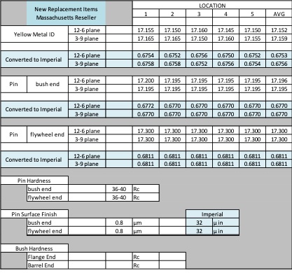

Here is something some may find interesting, others will go 'ehh'. This was from the work Ralphie and I were doing, never made it to publish...
APPENDIX # 1 New replacement Pins and Bushes
As an adjunct to the forensics testing done on the used NOS and used NORS pins and bushes in the blind test organized by Ralph Ricks, it was decided to buy a set of new pins and new replacement bushes and perform full QC testing on the as received in order to have a modern comparison. Only one bush and one pin were tested this way.
The vendor is ‘nameless’ however the pins were bought in 2012 and the new replacement pin is the type having grinding centers and the ‘step’ in the pin diameter with the larger flywheel end. There is no rim as on original pins. The bush is the type with a spiral oil groove with ends broken through, that does not match the original Ford drawings on groove specification.
The testing was done at one of Chi-com highest level tier #1 test centers certified to do direct testing for Ford Motor Company, TRW, Mercedes and Brembo in a standard format to the third decimal place, metric.
The results are shown as Figure #1
figure 1 pins.jpg (79.55 KiB) Viewed 11914 times
Conclusion-
• The pin inspected is as near perfect and flawless as possible to basic dimensions. The pin is manufactured to the lower limit (bush end) specified on drawings for the T-3315, factory number 715 pin on original Ford drawings, however that is not a bad thing.
• Run-out and coplanar (out-of-round) tolerances were not checked as a sample of 1. However, due to the way the grinding centers were made and the 4th decimal place (Imperial measure) absolute control ‘to size’ in planes 90 degrees apart, these pins are at least as accurate, if not more, than original pins made by Ford.
• The hardness although shown 36-40 is the lab way of bracketing hardness reporting when slice and dice photo micro-sectioning is NOT performed. Nominal is Rc 38 which needs to be compared to the original NOS and NORS forensics when completed.
• The surface finish is 32 on both the flywheel end and the bushing end. 32 is definitely correct for the press fit into the flywheel and some may question the 32 for the bush end as being too rough and further shoe shine of the surface would be required for a bush to self-hone.
o The reporter holds that 32 is probably the finish that Ford originally intended in spite of lore that micro-lapping to get ‘wrist pin’ smoothness was the way to go. The report in the forensics of NOS & NORS will explain why the author believes the 32 probable.
o The vendor has been asked to inform their supplier that shipping pins built to this precision open and loose in bags of 3, or shipped in boxes without sleeves from the maker causes small bumps and nicks, some almost microscopic however a simple care in handling, storage and shipping would allow these pins to be used with no further attention to detail once received.
• Since these are the 2 diameter pin a calculation was performed which shows the flywheel end to be EXACTLY 0.0041” bigger than the bush end and this value, when using this maker’s pins needs consideration when determining the press fit into the flywheel.
• The bush was sent out for metallurgical content and grain size analysis and will be reported on in a further supplement.
George R. Mills
