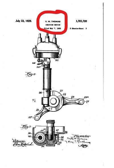

Should be pretty impressive. What dissy are you running, I had a simular issue with a engine I outfitted with a Thomas on the run stand. Come to find out the point cam was not concentric. Two lobses opened the points correctly the others where one to little & the other to wide. so the dwel was all over the place. So the timing was off on two cylinders. Swapped out the dissy & alls fine. Just a thought.
Craig.

Post by ewdysar » Thu Aug 19, 2021 6:49 pm
Craig Leach wrote:
Thu Aug 19, 2021 6:03 pm
Hi Ian,
Has this back fire issue just come up or is this a fresh build and just getting going? Other than the back fire how does it run?
Craig.
Some times Ockhams razor is the best tool in the box.
What you observed may, or may not, have been intentional…
Thinking way back to my VW days, if I remember correctly, most of the air-cooled VW distributors had a funny thing about their timing:
(from landracing.com forum) “ And a VW high performance enthusiast...Most VW distributors that I know of, had the lobe for #3 cylinder retarded because of the fact its cooling air passed through the oil cooler before cooling the cylinder...retarding the cylinder timing sorta/kinda/was supposed to help keep the cylinder within reasonable cooling specs...Well, in practical applications (meaning every air cooled VW I know of) it didn't work, #3 cylinder was famous for dropping its exhaust valve.”
Just something to be aware of for modern conversion distributors…
Eric

Craig Leach
Posts: 2035
First Name: craig
Last Name: leach
Location: Laveen Az
Re: back fire
Post by Craig Leach » Thu Aug 19, 2021 11:52 pm
Eric.
I think I see the confusion here.
Please don't take offence I thought it was very ironic that a distributer built a year before Ferdinand Porsche designed the Volkswagen would get confused. ;)
Craig
