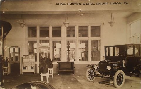

Charles Huston12644746_774556356007535_8596332285775933879_n.jpg (29.77 KiB) Viewed 4364 times

Yesterday I saw a rendition of the Ford Universal Car sign. The motto under it was something like "Successfully putting oil back in the ground for over 100 years". Model T oil leaks are so common that they are often considered a normal part of the car's operation, and folks say if it isn't leaking it's out of oil. That's an exaggeration, and it's possible to make a T leak-free. I've seen it, but so far I haven't achieved it. As in your picture, period photos sometimes show new Fords in the showroom with drip pans under them.

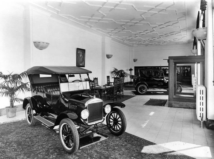

Post by Been Here Before » Fri Aug 20, 2021 10:02 am
Looking back at indoor dealer photos, would be safe to state that Ford supplied drip pans with every car delivered?

Post by TXGOAT2 » Fri Aug 20, 2021 11:37 am
I'd guess fancy dealers used pans, or hired a kid as a wiper. More typical dealers probably used sawdust, cardboard, or just let 'er drip. Frugal dealers probably used pans or old oil cans to collect the oil for use in shop oil cans. About a hundred things on a T need a few drops of oil from time to time. A little motor oil cut with a little kerosene and mixed with dry sawdust made a good floor sweep compound.
