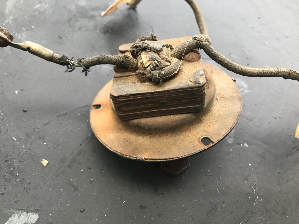

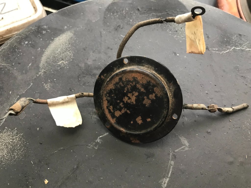

Hi everyone,
Dad recently dropped off a box of stuff that I'd long forgotten that I had. In it was a switch panel with what I think is a voltage regulator? It's got 3 wires, Bright, Dim and unknown.
Several questions.
1. Is it a volt regulator?
2. Is it worth salvaging?
3. Can they be repaired?

This is an inductor that is used with MAG headlights on non-starter cars.
I would help keep the bulbs from burning out.

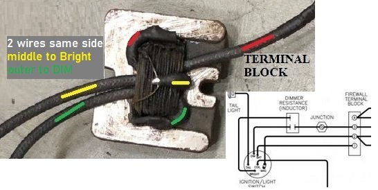

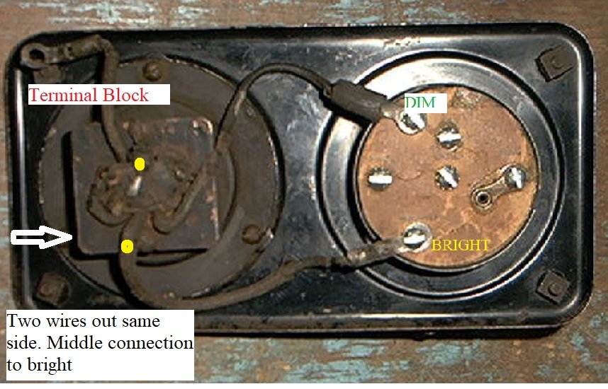

It is worth saving and a member is looking for one. The contact wires can be repaired and then it can be tested. A MTFCA member came up with this
Note the insulated wires are thread underneath the wire core, soldering to the windings easily when pulled through. After soldering seal the joint with Flex Seal or Plasti Dip and rethread as shown. The threading is just to protect the wires from pulling loose

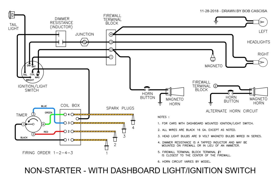

This might help.

Identifying the wires to the schematic

Here are the links to the Schematics and Harness Diagrams on the MTFCI web site
