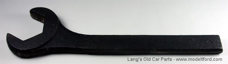

That's right, for the reasons stated. There is a wrench made specifically for this. I was lucky enough to buy an old one for $2 at a swap meet. Unfortunately, new ones cost a lot more.

I agree on the wrench. You need to beg, borrow, or steal the correct open-end wrench. It has been my experience over many years that Propane doesn't help much in freeing frozen nuts and bolts. MAPP gas is a bit better, but if you are serious about loosening the nut without damage, you need Oxyacetylene.

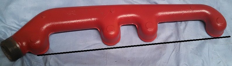

I have seen two very strange gaskets during disassembly, each one is for three holes in the engine and they look like a punched sheet of aluminum.
I will try to use original copper gaskets instead, with this little sheet metal guiding rings inside. Looks better.
If the manifold is warped, I still can use this crazy gaskets instead, they did fit well before, so why shouldn't they do their job again. Of course, new ones.

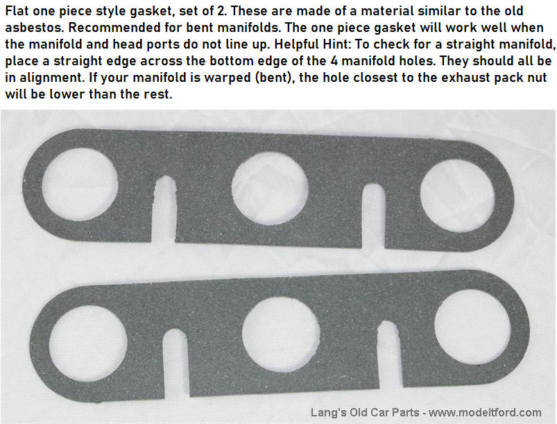

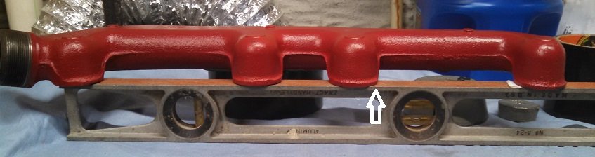

Before you order the gasket, check for warp. If you need a new manifold you'll save on shipping cost.
or you can try to ix it http://www.mtfca.com/discus/messages/17 ... 1307053275

I had glands inside and this glands don't appear to look damaged. So the manifold cannot be warped very much at all.
I had a close look, my manifold is almost straight, less than 1 mm difference. This should cause no troubles and also explains why the old glands are still round. if it does not perfectly slide on, I will grind a bit from its hole.

Use a back up the best you can and then get a ball peen hammer to tap on the different flats of the nut. Spray WD-40 while you are doing this and it will eventually break the nut loose. BUT if it was cross threaded you may have to pull the manifold to get it off. A last resort would be to use a small cut off grinder and split the nut.

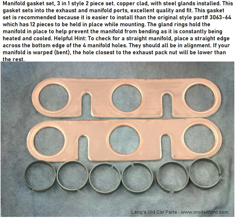

Rainer...those gaskets you showed in the link are junk. IMHO the best ones are the copper rings that also ha e the flat flange built right into them. I believe they are even made in Australia! Not cheap by a year means, but really work well. I ha e them on all my cars and my engine rebuilder also uses them and cusses the one you showed. Just sayin!

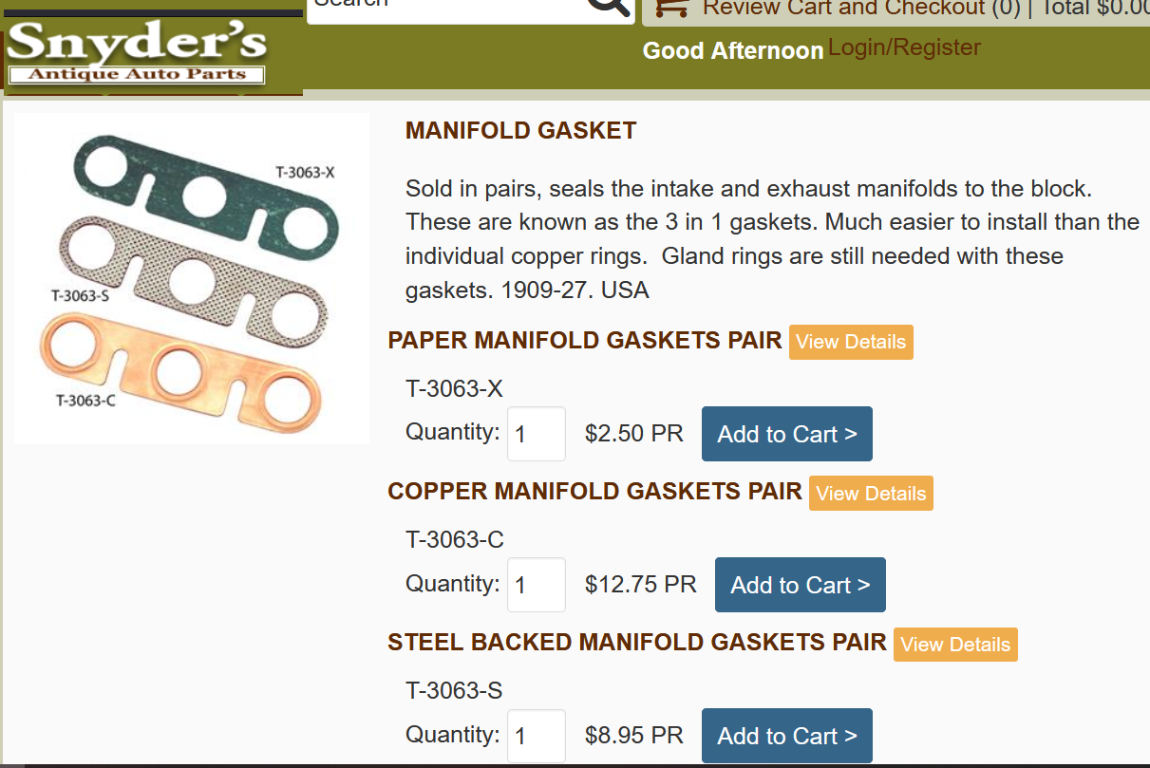

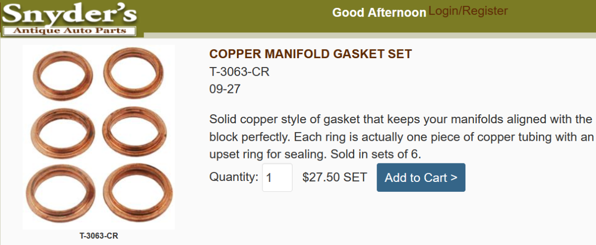

I don't see the gaskets i mentioned above in Langs catalogue but Snyders shows them...# T-3063-CR...$27.50 per set.

Gasket choices in no particular order

Rainer, the copper ones Tim mentioned are made in Australia. They are an excellent product, and can be used more than once. Check out this site, Info @ftrs.com.au If you buy from them, you will save heaps on postage and the mark up in prices others need to add.

I have 2 Model T's and on both cars had an occurrence where the exhaust pipe came off the manifold. On both cars the nut loosened up. I tried plain pipe clamps, and they did not hold.
I bought the wrench, $40. I also bought the exhaust nut clamp, $6. That tab really makes a difference. I have not had any problems since. I also keep the wrench in one of my cars. Maybe another driver will need it someday.

I currently have bought the gasket set of 6 copper rings + 6 gland rings as I knew that I will have to remove the manifolds. Such ones as shown in the last picture. I will try them first.
So I will try first to insert back the still assembled exhaust pipe + manifold, it came off without any force, so it should also reinstall without force. If not, I will try to use my propane torch to loosen the nut. Hope it can produce enough heat.

Allan wrote: ↑Sat Aug 21, 2021 7:42 pmRainer, the copper ones Tim mentioned are made in Australia. They are an excellent product, and can be used more than once. Check out this site, Info @ftrs.com.au If you buy from them, you will save heaps on postage and the mark up in prices others need to add.
Hope this helps,
I could not agree more about the solid copper gaskets, absolutely excellent. I bought them years ago (ad in the MTFCA magazine at the time was the only way, I think) and have not any any leaks since. The best part, my grandson collects stamps and I asked that in lieu of printed postage would it be possible to use some Australian stamps instead so he could add them into his collection, they said they would do "their level best" to help. When the package arrived, no stamps on the outside but packaged up nicely along with the gasket sets was a very nice commemorative stamp set from Australia Post. Someone took the time and effort (not to mention money) and went to the Post Office to be nice to someone half a world away. Not just a great product, but also great people.
- Posts: 8665
Re: Trying to loosen the exhaust pipe nut - how? - Solved meanwhile
I suspect that the copper gaskets, besides giving a reliable joint, might also prevent exhaust manifold warping by providing a better path for heat to migrate from the manifold to the water jacket than would a fiber or composite gasket.
- Posts: 7304
Another benefit of the Aussie made copper gaskets is the heavy weigh of the material. They can even be filed a little to make a taper on one side which will make lining up and installation easier, and even compensate for a little warping downwards of the rear and front ports.
