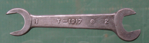

There are two Ford tools for adjusting the brake and reverse bands. If you don't have either yet, you can put them on your Model T shopping list.
The #1917 band adjustment wrench is plentiful and cheap because it was one of the tools issued with every car. You are practically guaranteed to find it at any swap meet with Model T stuff. I see them at Hershey, usually priced well under $5, many times for $2.
