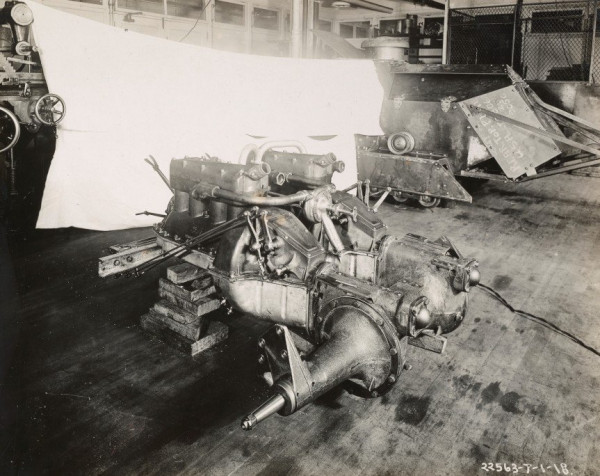

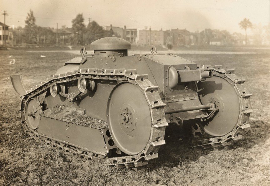

And what was the method of keeping two engines, inside an un-vented iron box from over heating?
The photographs of the tank begs an answer as how the motor was cooled and the operators comfortable.
Say is that a water pump between the two motors?
Water pump, no thermostat, 100% glycerol.

Yes, it's a water pump. You can see the drive shaft running forward. It would have to be a waterpump considering the downward turn to the block intake.

The operators were not comfortable. The design requirements of the vehicle made using the thermosyphon principle to circulate coolant impossible. A thermosyphon system is a gravity system, and gravity on Earth has but one setting, and even the Department of Defense has to respect it. High and almost continuous engine loading, radiator shielding, etc would have required a pump or pumps in any case. I would expect that all liquid-cooled aircraft engines had water pumps of some sort.
