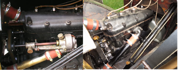

I see a lot of speedsters run water pumps. What's the thinking on these higher HP T motors?
- Posts: 4479
Re: Can of worms: opened
Speedster guys like accessories and do-dads! My speedster has one. In fact, all my T's do! AHHH! The horror!!!
Pump or no pump: enjoy your T's folks!

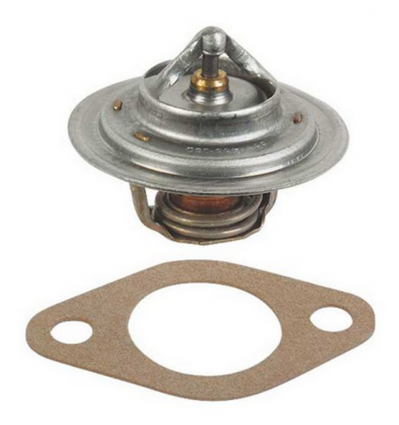

what does a thermostat look like?

If you encounter a thermostat on a T, it will probably be one of the very common type used from the early 1950s thru the 70s. It will probably be located in the hose between the water outlet on the head and the inlet to the upper radiator tank, or else sandwiched between the cylinder head and the water outlet casting. It will look a little like a flying saucer, and exactly like a thermostat. In my opinion, a Model T without a water pump has no need of a thermostat and is better off without one unless you live at Point Barrow, and probably not then. If you run a water pump, I would recommend using a 180 F thermostat with a bypass modification. In a system with a water pump, the thermostat will allow the engine to reach and maintain operating temperature in colder weather and will act to prevent pushing too much water up into the upper radiator tank, assuming the radiator isn't plugged up. Restricting the pump's action at higher engine speeds at the water outlet will avoid pulling a suction on the lower radiator hose, which can cause steam pockets and promote leaks at the pump seal. A water pump seal can leak water out, and it can also leak air in at higher engine speeds, which is very detrimental. A proper thermostat installation can prevent this. It will also put a slight pressure on the engine block and head at higher speeds, which is all to the good, since it prevents steam bubbles. I'd say a water pump and thermostat are optional on a T or near stock T. I would NEVER run a flathead Ford V8 without thermostats and good water pumps.

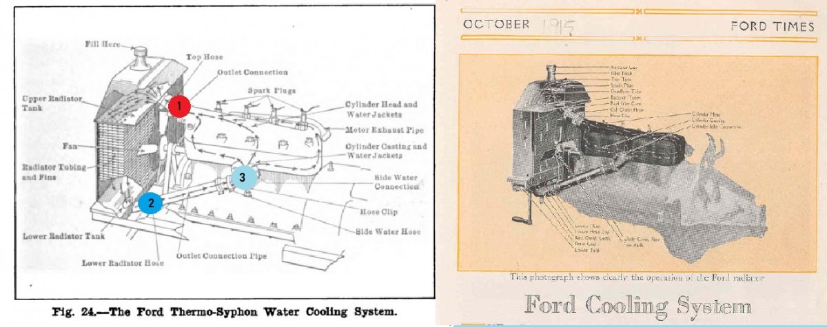

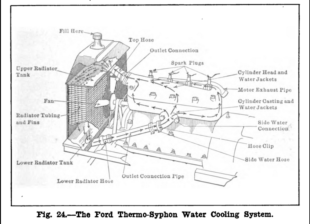

There are many things that come into play to keep a Model T running at its most efficient operating temperature. Most would say that is between 160°F and 180°F in order for the Model T thermosiphoning cooling system to circulate fluid through the system. A thermosiphoning system is intended to cause circulation without the need of a "pump" (more on "pump" later). So how does the fluid flow?
I'm sure your familiar with the saying "heat rises and cold air falls" and that is basically how the Model T cooling system is design to operate.Think of the system as a loop shown in the picture below. The hot fluid being less dense than cold, rises to the top of the system and in a sense is pushing the cooler fluid down in into the radiator, likewise the falling cooler fluid is drawing the fluid down causing the circulation. The function of a thermostat is act as a valve to block the flow of the fluid until its designed temperature is reached (lets say 160°F). There are two basic reasons to cause the coolant fluid to reach that temperature more quickly - one is for efficient operating temperature especially in cold weather, the other applies to modern car's hot water heating system (not applicable to a Model T).
PUMPs
Modern cars don't rely on Thermosiponing cooling. They have a pressurized system (and a thermostat). A Modern car's water pump uses centrifugal force to send fluid through the system while it spins, causing fluid to be drawn from the center continuously. The inlet to the pump is located near the center so that fluid returning from the radiator hits the pump vanes. The pump vanes fling the fluid to the outside of the pump, where it can enter the engine. The fluid leaving the pump flows first through the engine block and cylinder head, then into the radiator and finally back to the pump. Here's a look at the impeller of two Model T water pumps. Now what is in question is how these would enhance the flow of the coolant when it was already in movement from Thermosiponing? Also if there was a blockage in part of the radiator core would moving the coolant through the system faster make it any cooler or would it reach a point of equilibrium? Personally, I don't see Model T era water pumps capable of moving coolant any faster once operating temperature is reached and the Thermo action kicks in. Once last point. The fan is only intended to pull air through the radiator while the car is at rest. Once the car gains speed the engine compartment is designed as a closed box to cause a low pressure system with the hood louvers pulling the air through the radiator core out of the compartment. Altering the compartment by removing the engine dust pans (splash pans) or hood defeats the design and less engine cooling.
In summary
Model T radiators went through a series of designs to improve their cooling capacity. Dusty roads may have contributed to clogged fins on the cores. The use of local ground water containing unwelcomed minerals could have also ruined a few. Many owners swear by Berg radiators as the solution to heating issues. If you don't have a problem stick with what you have.

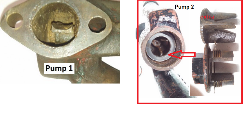

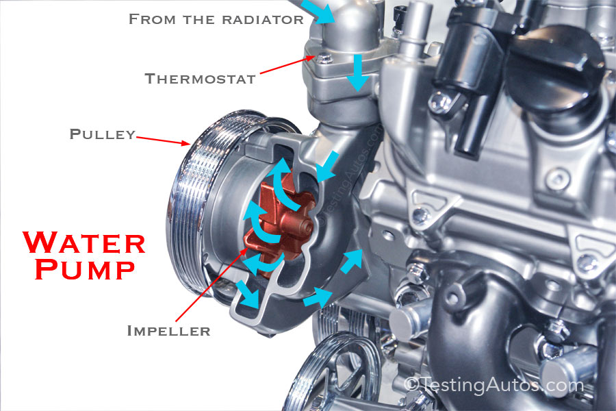

My2C: I have a problem with referring to a vintage Model T water pump as a "pump". The expectation is that such a device would enhance the delivery of coolant in a problematic radiator by causing the coolant to move faster through the system and somehow even push it through. Consider the placement of these designs as shown in the diagram. Understand that the Model T cooling system is not pressurized, so the only way for coolant to get to the bottom of the tank is either by gravity or thermosiphoning.
In reading the following consider the coolant flow to start at a temperature below that needed to cause thermosiphoning and then ....
Position 1: Only has access to coolant that was already delivered to the head's water jacket by thermosiphoning. The position of a water pump at this location is too high for gravity to have much of an affect. It delivers coolant to the expansion tank in the upper portion of the radiator.
Position 3: Only has access to coolant that has been delivered to the water inlet position. This aligns to about the middle of the radiator so both thermosiphoning and gravity would cause coolant to be available and both of these forces would cause water to enter the water jacket in the head. Again it can't deliver more coolant than is already available to it. If the coolant in the radiator was low and below the input to the pump it couldn't cause more flow than what thermosiphoning was providing.
Position 2: Conceptually, placement of a "pump" at this position would be the most advantageous position but again it would only be able to contribute to the flow of the coolant that was available to it. Even if the coolant level was below the water inlet it might be able to push coolant into the water jacket
All of these "pump" locations are entirely dependent on the amount of coolant that is able to pass through the radiator core either by gravity and thermosiphoning. At most they might cause coolant to enter the expansion tank more quickly, but after that where back to gravity and thermosiphoning. Things would be different if it were a pressurized system
