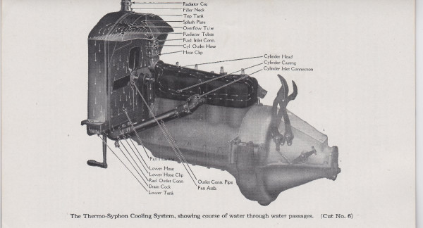

Pep C Strebeck
- Posts: 646
- First Name: Joseph
- Last Name: M
- Location: MI
Re: One more radiator question
At what point on this illustration do you fill it up to? What point do you consider to be the top?Jonah D'Avella wrote: ↑Mon Aug 30, 2021 6:43 pmOk, when I fill it to the top, it lowers until I can see the tubes in about 10 miles.
Duey_C
- Posts: 1558
- First Name: Duane
- Last Name: Cooley
- Location: central MN
I shouldn't. The upper water level to me is at the overflow tube.
