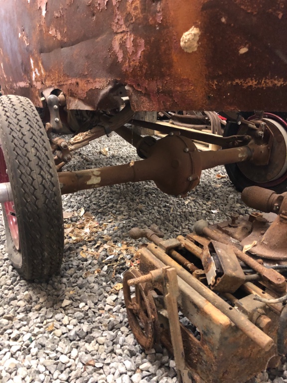

Rob I have an odd 2:75 to 1 in a 1930's 3/4 scale sprint car project. The only one I have ever seen.
Hank
Hank

Hank,
Is it a T diff? I’m curious, did they have to add to the pumpkin to accommodate a large pinion? I have this photo of the large (389 ci at that time) Ford special at the 1911 Algonquin hill climb.l. The diff is extremely wide, and the racing program said Ford was running a 1.5:1 diff.

Probably the same thing Hank Lee has in his project. A good friend fifty years ago had a 13/36 original set made by Ruckstell.He had it in his speedster with a Rajo and Ruckstell and loved it!
I have only seen a very few others since then, so they are quite rare. I would imagine some sets must still be around in private stashes. I would hope someone having a set they have not been using would make the sacrifice and sell one at a decent price?
As I understand it, the 13 tooth pinion gear is the same as the more common Ruckstell 13/40 set. So you should grab a good one of those if one comes along. The 36 tooth ring gear is configured to run against that regular 13 tooth pinion somehow. I never got to see the set my friend had in his car. The original Ruckstell gears are sometimes overly hardened, and tend to be brittle. I would NOT suggest matching an era Ruckstell ring with a new replacement pinion!

Rob,

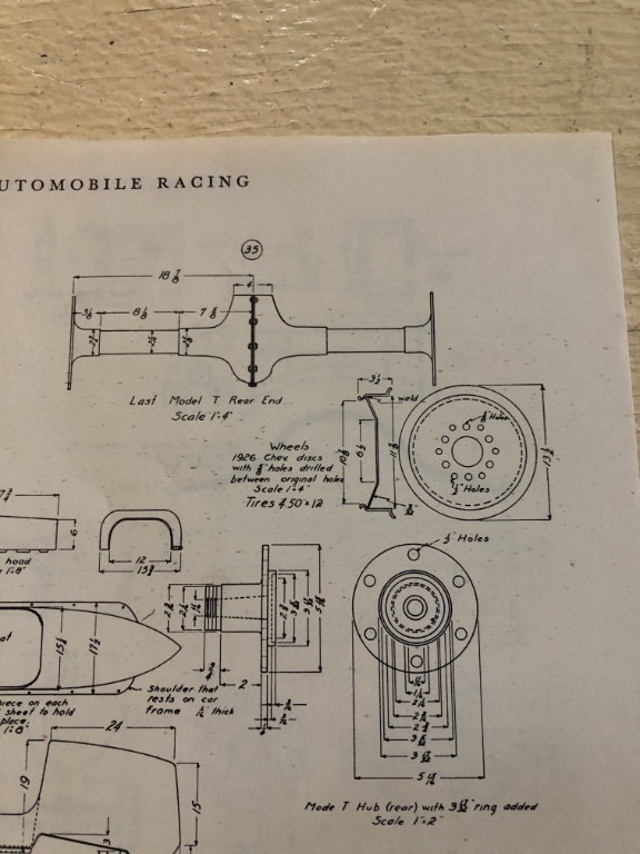

This fits in a conventional Model T rear end housing. The car has 12" tires on it, 13" removed from the width (6 1/2" from each side). Pictures and plans are in The Complete Ray Kun's Auto Racing Book. Should have taken pictures years back when we replaced the bad housings. For the like of me, cannot remember exactly the gear counts but came out to those ratios.
Hank
Hank

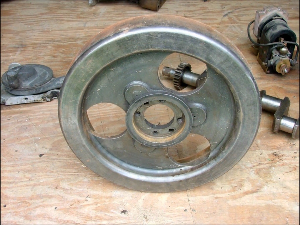

Tony, I recently separated the flywheel from the output shaft on our Ford Special racer. This isn't a Ford Model T motor, but one of six specially built and raced Ford motors built between 1910 (probably begun in 1909) and 1912. Our motor began as a 298 cu in four cylinder. The motors had auxiliary exhaust ports (ports at the top of the piston in the downstroke position) with a slide that can be opened and closed with the right foot while driving. When open, the motor breaths (and runs) much better, but the carb must be richened as the slide (ports) are opened.
For whatever reason, this motor accelerates extremely quickly (reminds me of a small block Chebby, of which I had a few in my younger days). The flywheel (I'll add a pic or two below) is nothing link a T, but a large, smooth 65 lbs. pure flywheel. Ignition was provided by a dual spark Bosch magneto, and the engine has two plugs per cylinder.
The flywheel left the company of the output shaft when I was driving about 60 mph, still breaking in the motor. I suspect the four bolts, threaded into the flywheel, and two index pins may have had some "slop" that we had not detected, and when she let go, that was the end of that. Now the racer sits forlornly at Dean Yoders shop, waiting for another performance T motor builder from Oklahoma to pick up the motor and line everything back up.

Older photo of the flywheel. This was taken before I acquired this project, and the motor was together. In hindsight it looks to me like the flywheel may have already been damaged:

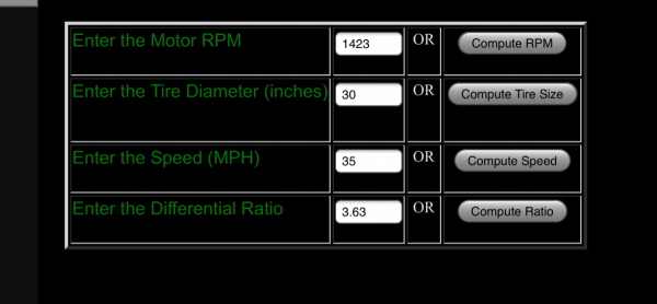

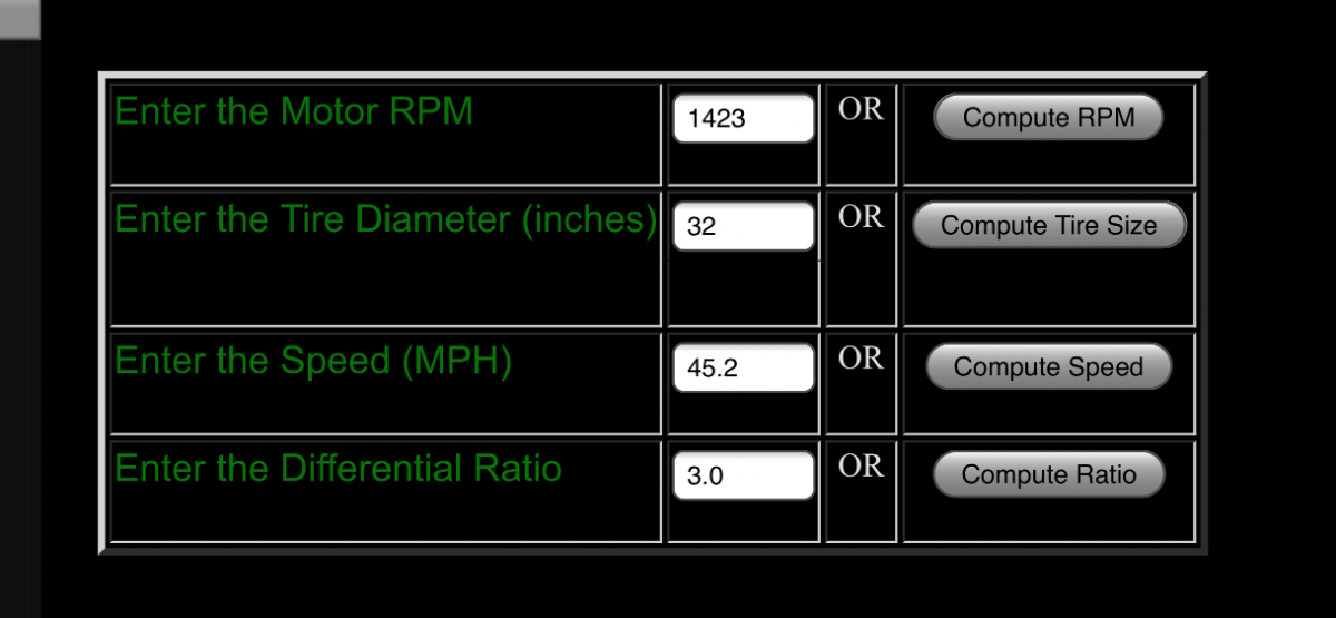

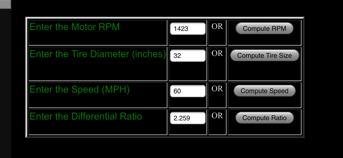

A little more "into the weeds."
A Model T with 30 inch tires, 3.63:1 diff ratio should be turning about 1400 rpm at 35 mph:
Our racer has 32 inch tires (Ford drawings specified 32 inch wire wheels for this motor, although photos with what appear to be 30 in wood wheels were also used). With our 3:1 diff ratio and 32 in wheels, the racer should travel about 45 mph at the same 1400 plus rpm:
With a 2.26:1 ratio, the racer would travel 60 mph at the same 1423 rpm:
