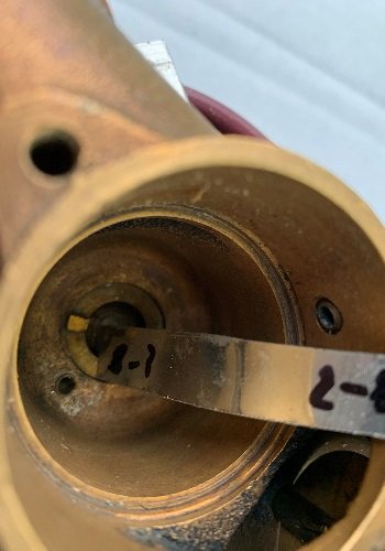

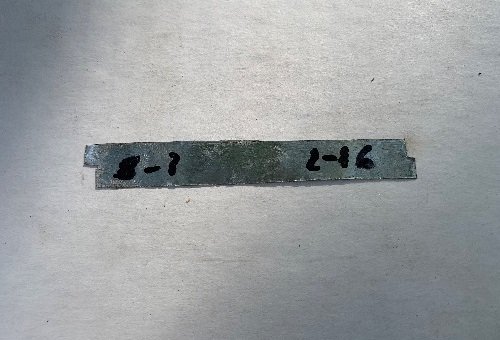

There are several posts on this site with good information on Holley G carbs. One post has a drawing of the "tool" used to measure the float level. You set the float, fill the bowl and then use the tool to check the depth of the fuel in the cup. Then, remove the bowl and repeat about a dozen times. As noted, you really need to have a fixture to avoid removing the bowl after each attempt. It didn't make sense until I tried it, so I am including a picture below.
There are many different depth recommendations, generally between 1/16" and 1/8". Fahnestock book shows 1/16". I have not seen a specific depth recommendation from Stan Howe (RIP). He did note that the pool had to cover the end of the idle tube, a car can be hard to start if the level is too low, and if too high the car will "slobber" when starting. My depth is set at about 1/8", the car runs great but does require 3-4 choke pulls when cold.
Other ideas:
Examine the idle tube closely. Mine had cracked near the bend, the car ran but not great. I soldered the crack, then later found a good replacement.
If you want a bigger project, you can remove (unscrew) the main jet cup and clean under there. There are some tiny holes that can get plugged up.
