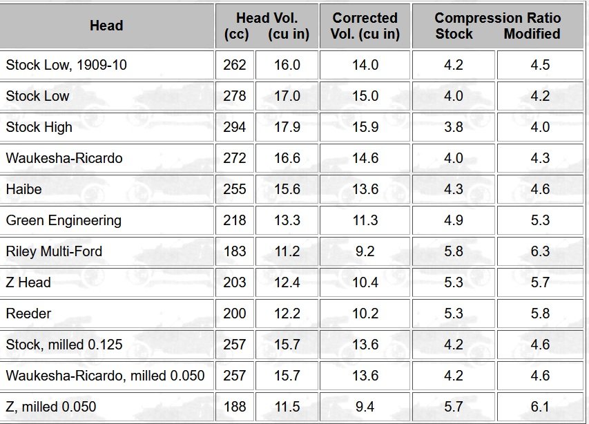

Good place to learn about Head Design http://mtfctulsa.com/Tech/head_design.htm and other Model T tech
http://mtfctulsa.com/Tech/head_dyno_testing.htm
http://mtfctulsa.com/Tech/index.htm
I don't see the Prus on this chart. How does it compare to the Z head?

Re: High Compression Heads
Post by speedytinc » Fri Aug 27, 2021 2:47 pm
JBog wrote:
Fri Aug 27, 2021 2:42 pm
TRDxB2 wrote:
Fri Aug 27, 2021 12:28 pm
Prus is a little bit higher. The CC numbers I have are not with me now.
CC's on the Z head I ran (after re-machining 3 combustion chambers) was 223 5.4-1 They can vary a bunch.
Prus head CC'd @ 220 5.38-1

speedytinc wrote:
Fri Aug 27, 2021 9:03 pm
So it sounds like the two are close, but the Prus is better quality from the outset.
