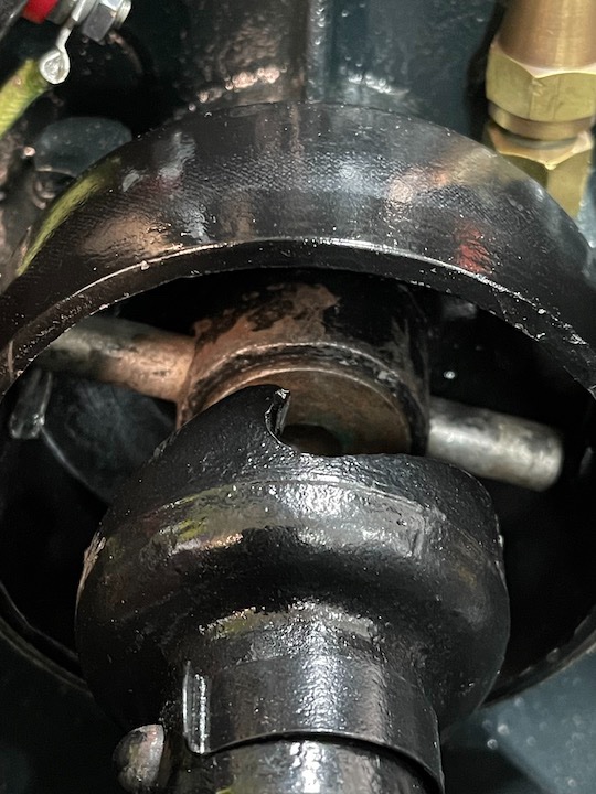

Mopar_man
- Posts: 1191
- First Name: Robert
- Last Name: Govoni
Re: Anderson timer: setting ignition timing?
So this is what I did. I got this info from John Regan. You are correct the pin facing 9:00 to 3:00 puts one of the pistons at TDC.
1. Took the radiator and headlights are off the car. I've got a 26/7 with a bar so that's why my lights are off.
2. Got a new timing rod (and throttle rod) from Lang’s. Don't try to use a bent up one from the past. The one from Lang's put the timer in almost a perfect position.
3. Installed the timing rod and saw that the outside oiler was rubbing so I took a large punch and tapped over the oil line so nothing touches the rod. This is important. Never bend the rod around anything (oiler, water pipe/hose)
4. Placed the timing lever all the way up (Retarded)
5. Took out the spark plugs but left them connected to the plug wires. Never fire a coil without it having a place to spark.
6. Hooked up the battery and checked to see if anything was hot. (Happy the first time I put power to the car it didn’t go up in flames. Ha!)
7. Had my daughter turn the key to battery and one of the coils started to buzz.
8. I turned the crank slowly and got each coil to buzz when the crank pin was in the position in the attached picture. I'm trying to get it at the 3:15 spot so a little past the 3:00 position.
Now I'm still going to make an adjustment to the rod to get it a bit closer to 3:15.
The only place you should bend the rod is at the arc. Close the arc and you will advance the timing spread the arc out and you will retard it. You have to look at the pin at eyeball level. My picture is looking a bit down on the pin.
That's how John taught me. I might add that he is a great guy and I am so grateful that he took the time to help out a new guy like me.
