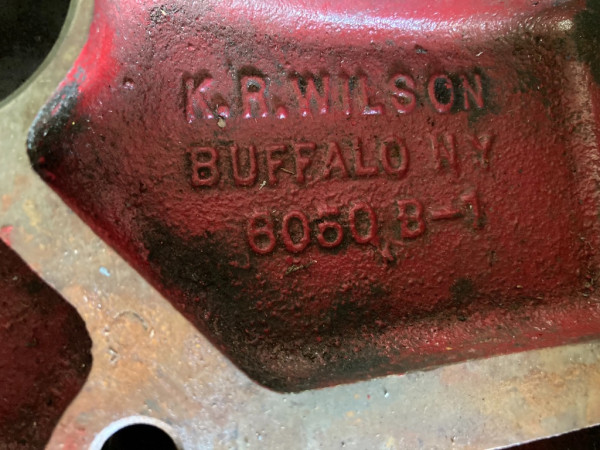

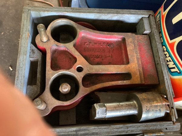

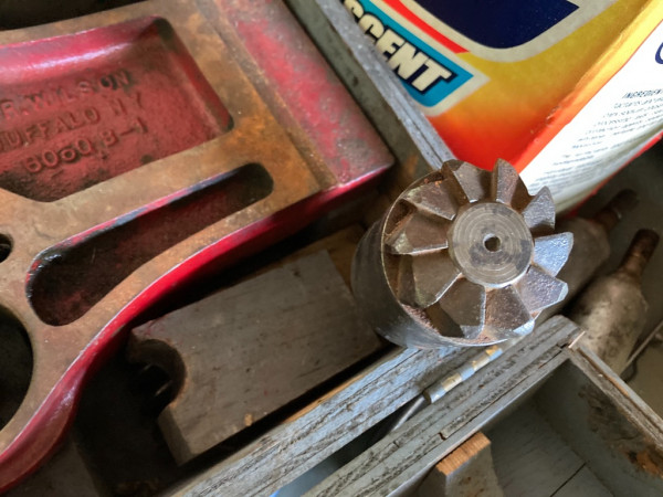

I have this tool/cutter. I can’t tell if it 6060 or 6050 B-1. Cutter and a jig. What’s it for ?

For cutting valve clearance into the cylinder heads that have been milled (flat heads), 6050-B-1. I believe that the B-1 suffix would make it later V-8, and if it were just the B suffix it would be earlier, but do not quote me on that.

Thanks Joe ! Doubtful that anyone would mill a T head that far anyway.Pep C Strebeck wrote: ↑Mon Aug 30, 2021 7:44 pmFor cutting valve clearance into the cylinder heads that have been milled (flat heads), 6050-B-1. I believe that the B-1 suffix would make it later V-8, and if it were just the B suffix it would be earlier, but do not quote me on that.

Tool for cutting valve relief in prewar heads when put on postwar blocks.
