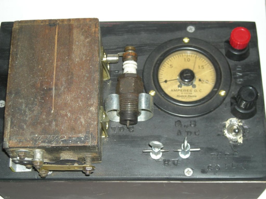

I am curious. If I should forgo my method of adjusting coils with the attached buzz box and not depending on the HCCT that I received years ago from an early Ford Dealership to set coils, what benefits would I feel or see?
With my methods of using the box and making certain the cushion springs are free, I can travel at 30-35 mph with no bulking or misfires. I can engage forward gears with no problems. The motor at idle is hitting on 4 cylinders. A smooth idle.
