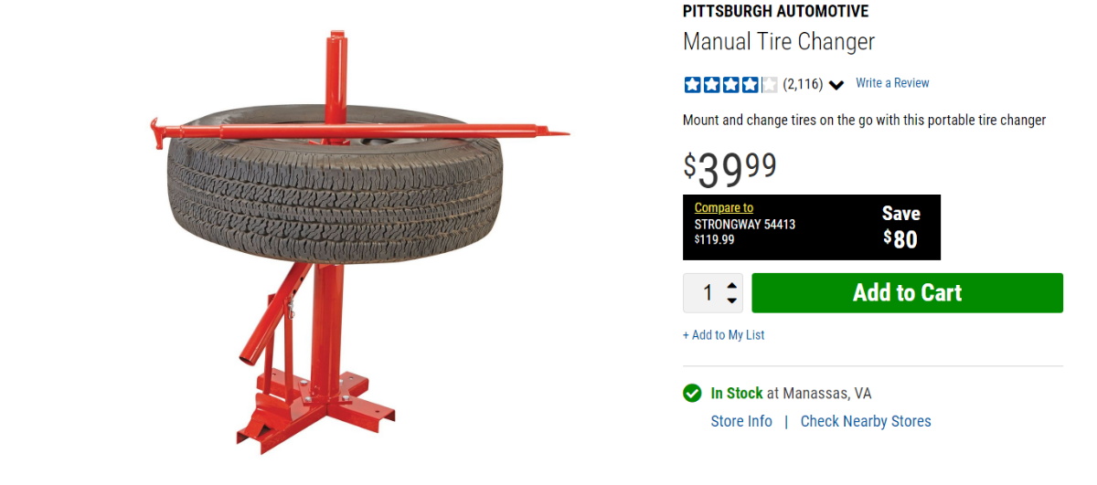

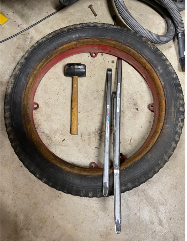

I’m trying to change the tires on a 1924 Tudor. Tires are old, dry rot and very stiff. I bought a few harbor freight tire irons but having a heck of a time. HF sells a tire changer tool https://www.harborfreight.com/manual-ti ... 69686.html but not sure if it will work. My rims are not the split kind. Anyone use this tool or any other ones that work well? Any tips or tricks? Thanks in advance!

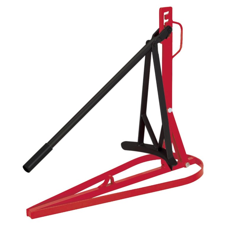

You need a pair of these: https://www.ebay.com/itm/265283474432?h ... SwYpFhJXDH
barring that, you need 2 large C-clamps to break the bead, push the tire in far enough off of the rim to fit a spoon/lever
barring that and you're at home and not on the road, Perry's method works just fine

Thanks for the suggestions! While waiting on responses I spent about an hour cursing and using brute force. Got one side off but now struggling for progress. I have 4 more to go counting the spare. If that harbor freight thing works I’ll buy it. Can anyone vouch for it?

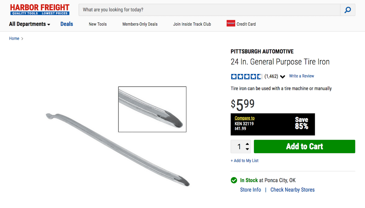

In my book the HF irons are a giant improvement over the stock Model T irons, which make changing tires the job from Hell. But even with the best irons, as you have found out, really hard old tires sometimes need drastic persuasion with a hacksaw.

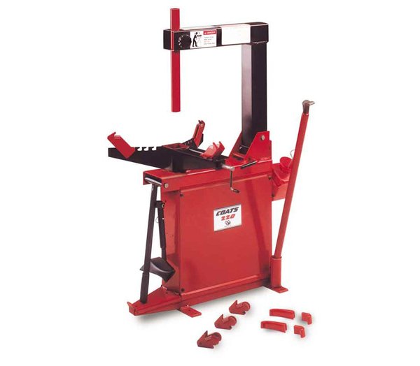

Doubt that will do the job. I have a Coates 220 I use for motorcycle tires and it handles wheels up to 21 inches. Clincher rims won't fit the machine, so if the Coates won't hold the rim, I seriously doubt the Harbor Freight unit will. Also the profiles of a clincher rim and modern rims.wheels are completely different. That said, it makes changing split rims very easy with the Coates machine. Just need a rim expander to finish the job.

Post by ecory0 » Sat Aug 28, 2021 9:52 pm
Woah, the coats machines are thousands of dollars!!!!

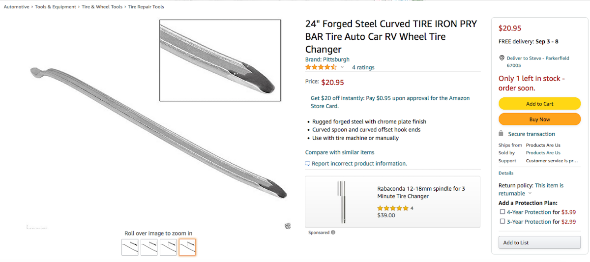

The type of tire iron you want has a curved cup on it like this one: https://www.amazon.com/Forged-Steel-Cur ... B01LZG3EVK
Once both beads are released from the rim, and two clamps have been applied like I stated above, the iron is forced under and past both beads and the entire tire (both beads) is levered off of the far side. Installation is pretty much the reverse, only easier with new tires and lubricant. You never want to do one bead at a time, even with the little short irons used in the '20s.

Post by Steve Jelf » Sat Aug 28, 2021 11:45 pm
It pays to shop around. :)

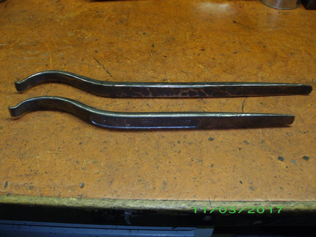

I have seen a lot of cheap tyre irons with that neat curved end broken off. It would seem some are cast rather than forged. Some also are rather thick at that curved end, perhaps in an effort to stop them breaking off. You get what yo pay for. My four are 18" Dowidat brand, three made in Australia, one in Germany. How do I use four? I work on a bench top a little above waist height. Two I can work with my hands, one I can park in an armpit, The fourth is usually left to fend for itself once I have one in hand either side of it.

I usually have nothing positive to say about harbor freight, and having no personal experience with that harbor freight tire machine I cannot provide any first hand useful information, but this being the MTFCA forum I will not hesitate to provide my opinion on this topic. Looking at the picture, as to the bead breaker feature only, I think it should do the job of breaking the bead, nothing more. It is cheap enough to try, and if you get a 10-25% off coupon, it IS worth trying. If you do, please let us know how it worked.

I take the rim and tire to a tire shop that has the type changer that squeezes the bead against the side of the machine to break it down. I have him break both sides down all the way around. Then lay the tire out in the sun to soften it as much as it will, before starting the removal. I lube the rim and bead with tire lube or dish soap all the way around. Next, starting away from the stem, insert the first tire iron in between the rim and the bead and lever the bead over the rim and hold it there. Moving a few inches to the side, insert a second lever, and again pull the bead over the rim, and hold it too. Insert a third lever again a short distance over and repeat, then remove the center lever, to start the next bead pull. Work around until you have the bead loose. Push the rim through, so you can pull the tube free, including the stem. With the tube out, pull the rim the rest of the way through, and from behind, insert a lever under the bead, and over the rim, and lever the bead over the rim from behind. Using a second lever work the tire the rest of the way off of the rim. I removed sixty year old wards riverside tires this way with reasonable effort.

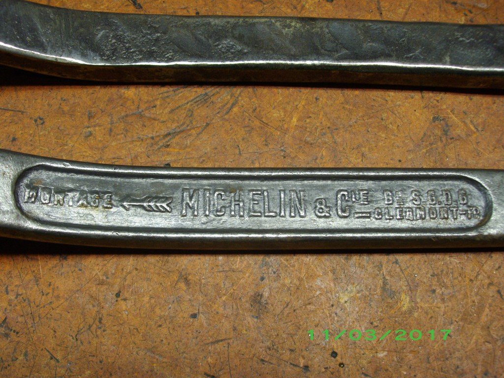

I Use this tools .
Toon
Posts: 6800
Re: Tire change tool, what do you use?
Post by Scott_Conger » Sun Aug 29, 2021 9:02 am
VERY nice tools Anthonie!
The Coats 220 is a manual machine that I purchased used.
