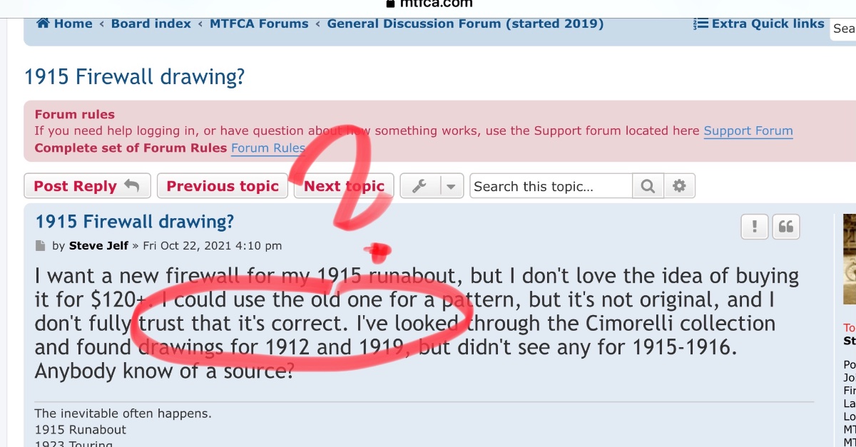

Post by Steve Jelf » Fri Oct 22, 2021 4:10 pm
I want a new firewall for my 1915 runabout, but I don't love the idea of buying it for $120+. I could use the old one for a pattern, but it's not original, and I don't fully trust that it's correct. I've looked through the Cimorelli collection and found drawings for 1912 and 1919, but didn't see any for 1915-1916. Anybody know of a source?

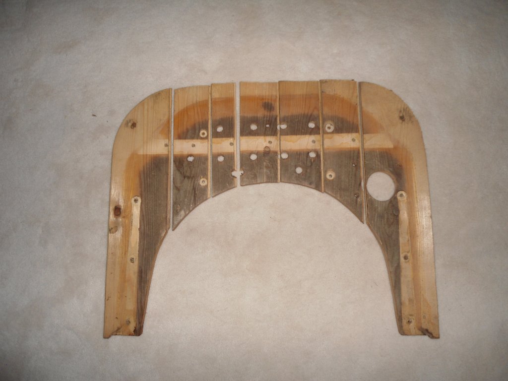

I had an original that I copied, the PO had braced the tongue and groove with a metal strap horizontally across the center. I made this sample however to be original I made a second unit with out the strap. I cut the pieces to match the original, I don't believe they were glued just sheeted with 1/8" cherry veneer, glued horizontally on the tongue and groove pieces. I think the reason for the tongue and groove was so that it could flex I don't think that plywood would offer much flex. The pieces are an odd thickness and require planning to fit.

The strap across the center with the 6 holes should not be there, I remade a second one with out that strap and holes.

If you have a chance, could you add some dimensions to the photo you posted of your 1st 1915-16 firewall? Yes, agree the strap was not original. But you made it from an original so It could at least give us a place to start working from. While I don't think the Benson Ford will sell us/send us a digital scan that we can ethically share with everyone (maybe that can be purchased? in addition to personal use?) But I think we can purchase a copy and use it to add the proper dimensions to that photo or our own drawing. John Regan did an excellent drawing of the 1909-1913 or so T frames (including where to locate the running board brackets that moved on the torpedo roadster and runabout). I'm sure he followed all the proper procedures and that a group of us could do something similar.

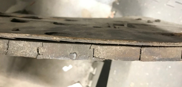

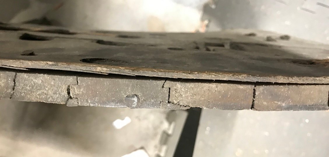

The original material of a Model T wood firewall was not like today's ply-wood. It was made of tongue & grooved boards with a veneer face, front and back. Not sure what year firewall I have (1919-22?) - need some dimensions (height & width). Its available for blueprinting.

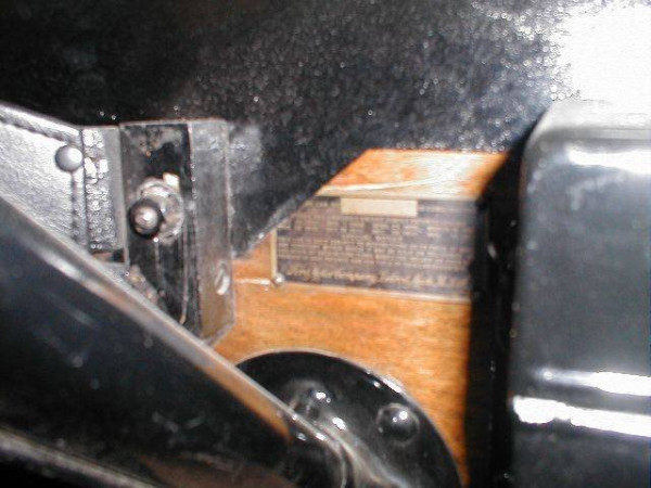

Note -- Jim Cook actually took his 1916 dash that had delaminated and the wood boards had all become loose and he cleaned it up, re-glued it (waterproof glue) and refinished it. He left it a natural look because it had come out so nice. It was missing the veneer face -- but looked so nice he couldn't bring himself to paint it black. But the old boards if solid and not warped can be reused -- or at least it worked well for him. (Note his car had been in the same family since new.) Below is a partial shot of his dash - (thanks Jim).

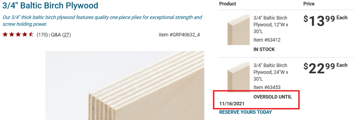

Post by TRDxB2 » Tue Oct 26, 2021 12:36 pm
Need to confirm actual thickness and dimensions (Rockler)
