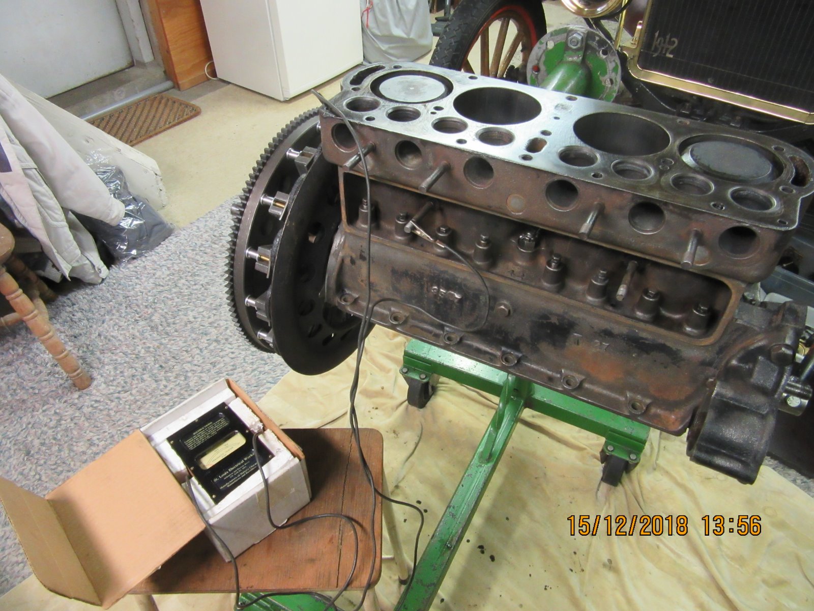

I have my engine out and partly apart to fix an issue with the clutch. The top terminal of the coilring was broke and now when that is fixed - how do I verify that there is no shorts to ground?
My plan is to set 6 or 12 volt to the terminal and ground and then test every coil with a piece of sheet steel to see if it gets attrackted to every one of the 16 coils. I may also use a compas. If the coils suddenly stops working there is a short to ground. If non of them works, there is a broken connection somewhere.

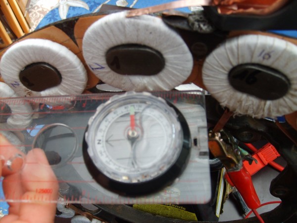

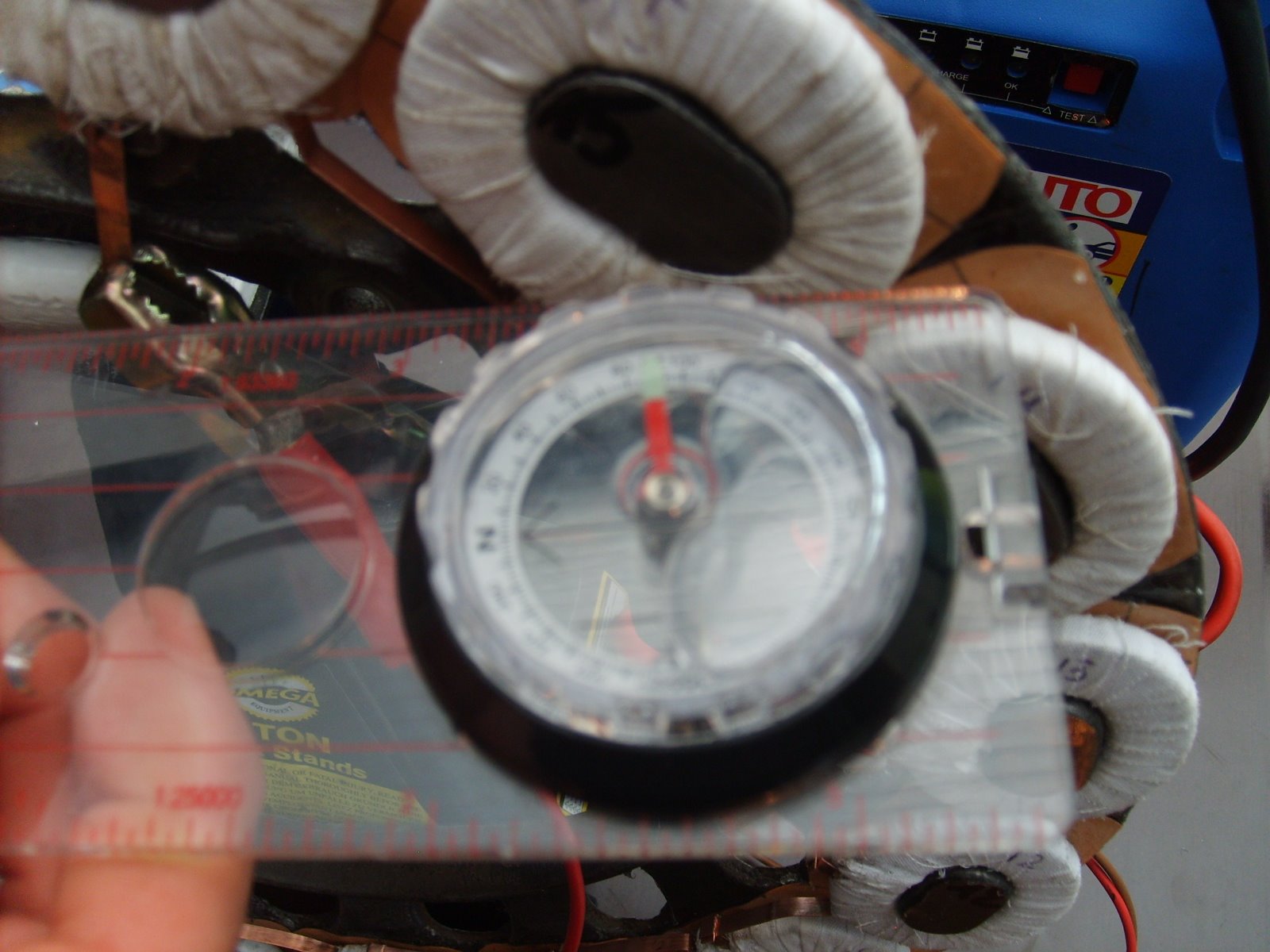

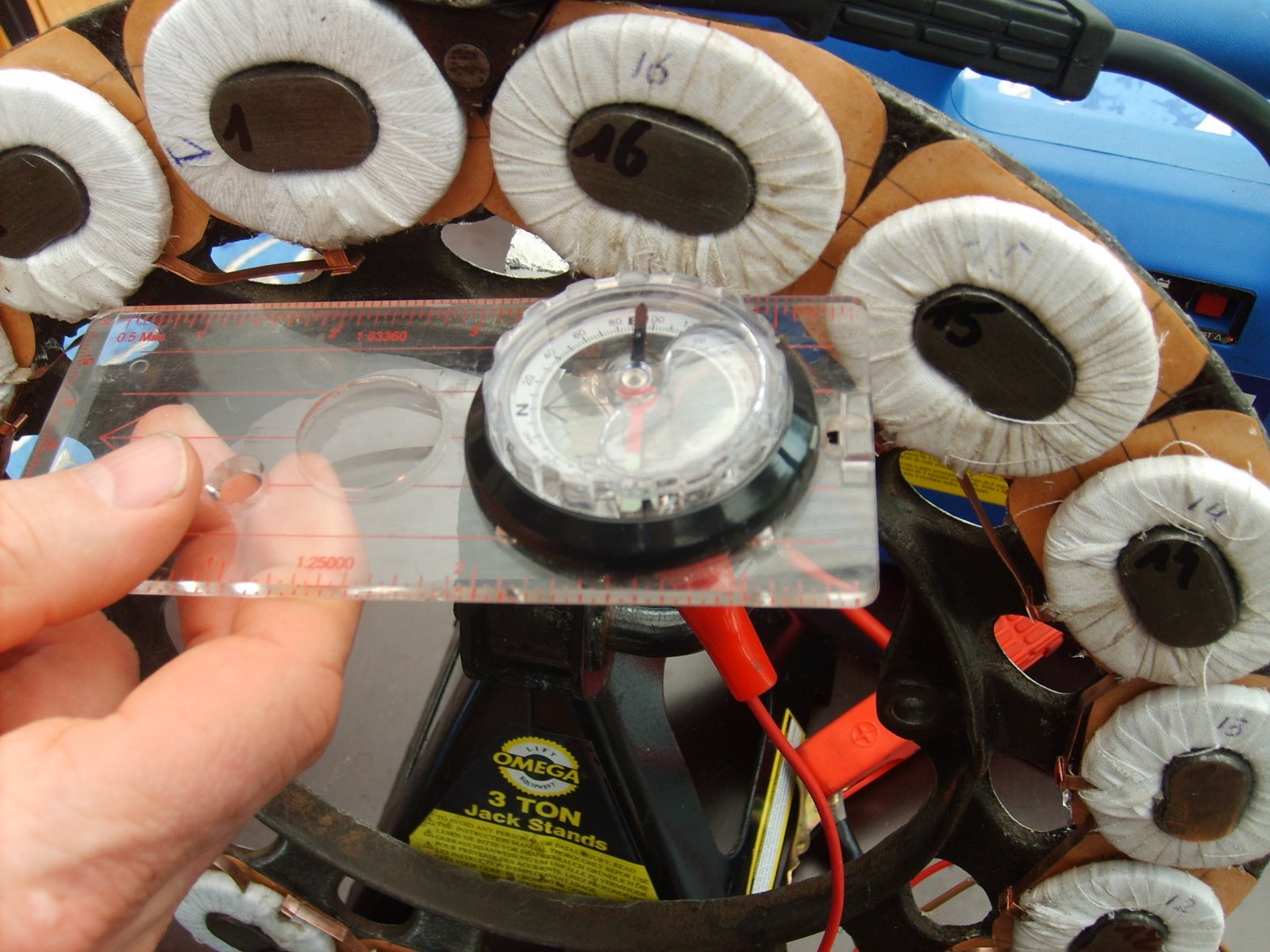

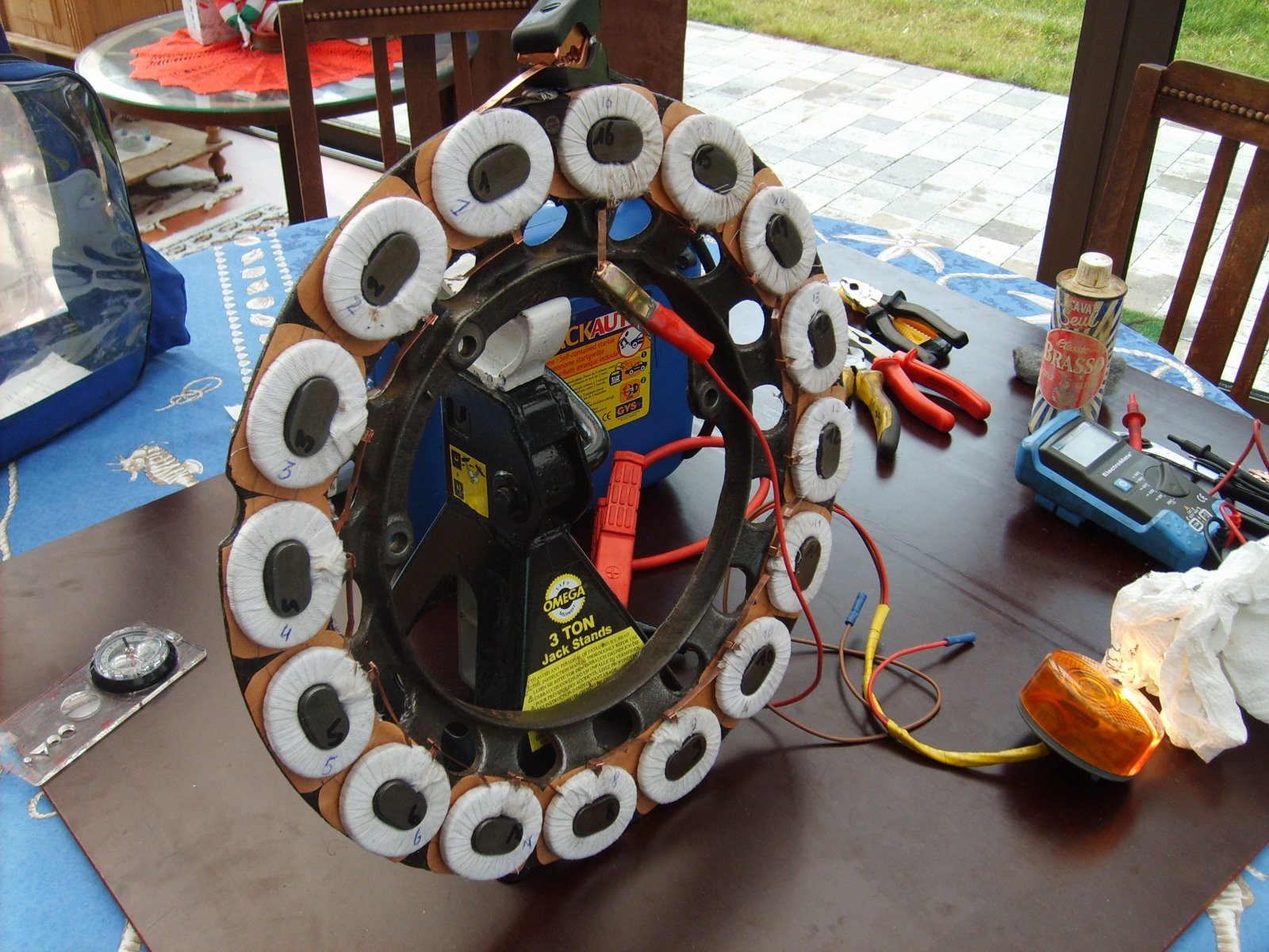

You not only need magnetisme on each coil but the magnetisme also need to change N-S between each coil.
To control this make a loop with a 12V 21W light bulb, your magneto coil ring and a 12V battery. Use a compass to check the magnetisme and the change N-S.
Good luck

Yes your compass idea should work well. I have done the same thing. After soaking my old coil in acetone and brake cleaner I used gasket shellac to seal it up again. In theory you could use that penetrative wood preservative used on soft boat hulls, but the guy who rebuilds the coil in the future might not appreciate that.
