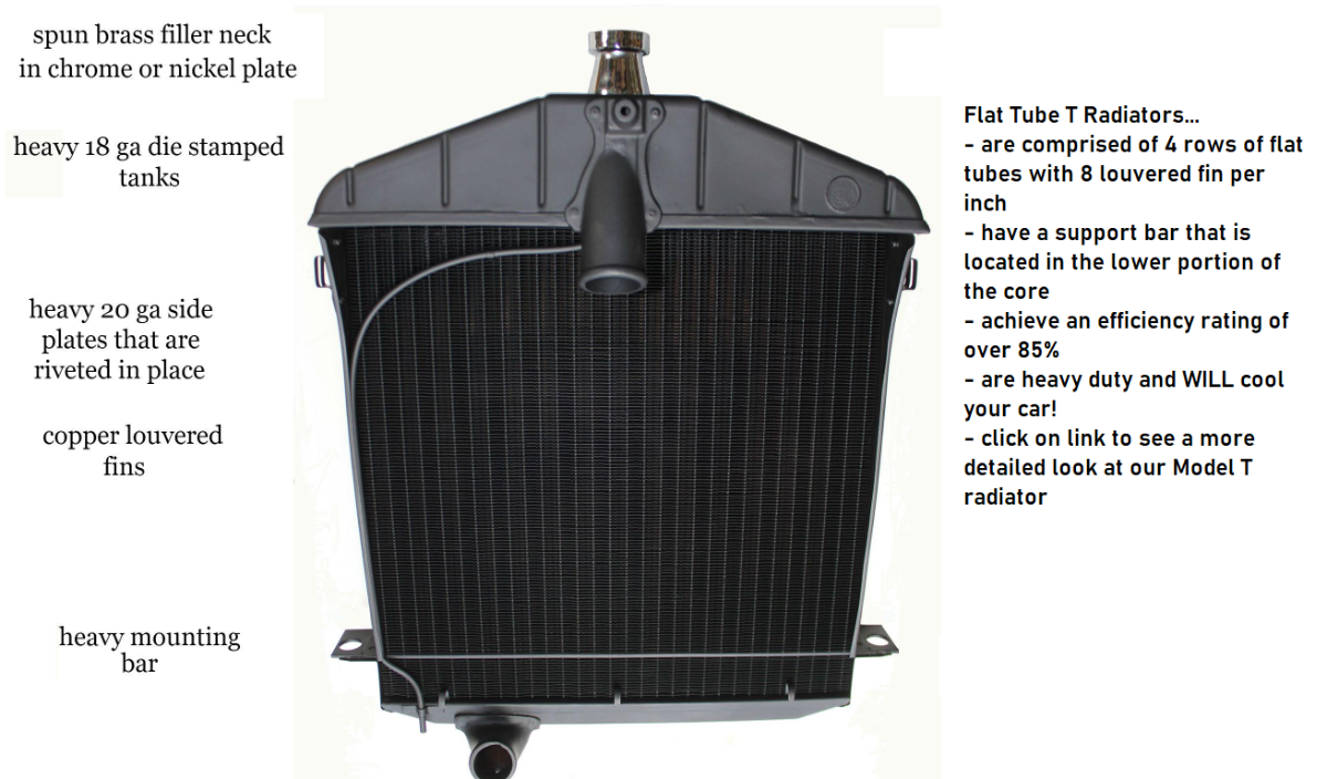

- Posts: 6391
Re: Radiator problem found
The vinegar to use is cleaning vinegar no salad vinegar. But time is money and trying to get an old radiator "working" again just isn't worth the effort.
Berg's are best and built well http://www.bergsradiator.com/modelt.html
