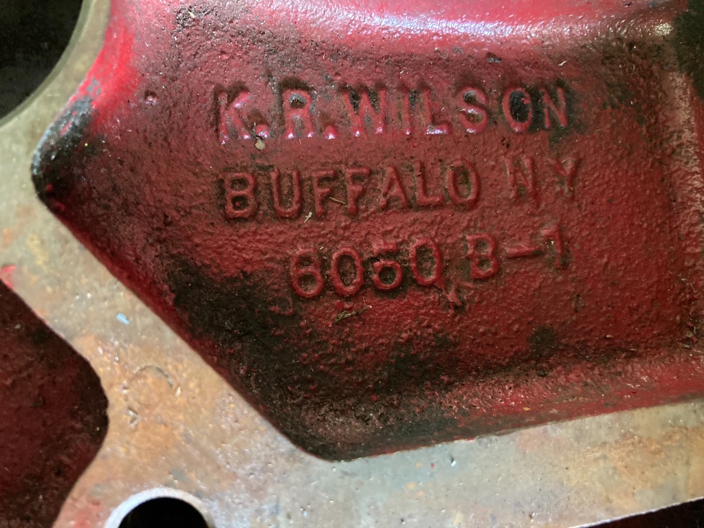

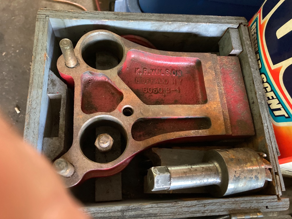

I have this tool/cutter. I can’t tell if it 6060 or 6050 B-1. Cutter and a jig. What’s it for ?

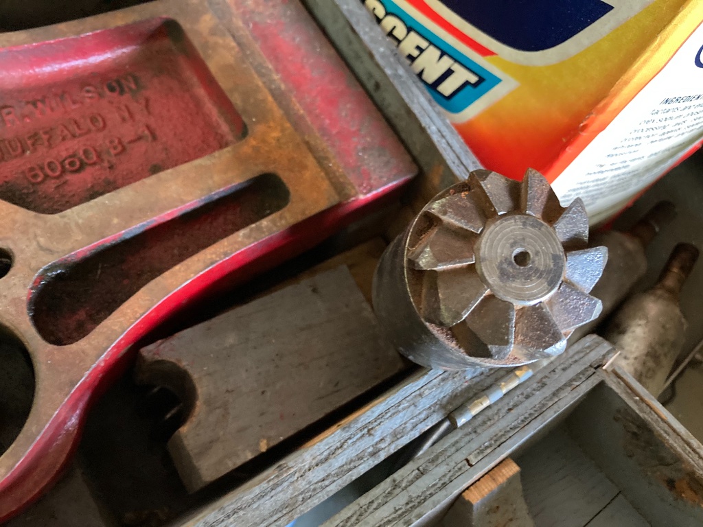

For cutting valve clearance into the cylinder heads that have been milled (flat heads), 6050-B-1. I believe that the B-1 suffix would make it later V-8, and if it were just the B suffix it would be earlier, but do not quote me on that.

It is a V8 tool. Want to part with it?

Tool for cutting valve relief in prewar heads when put on postwar blocks.
