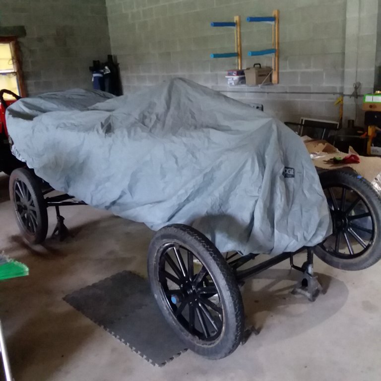

Did as you said. Car still won't run.
I'm covering it up and moving it off to a dark corner.
Moving on to other things as winter is approaching. I've got a list to get thru for the house..... no more time or patience for the T.

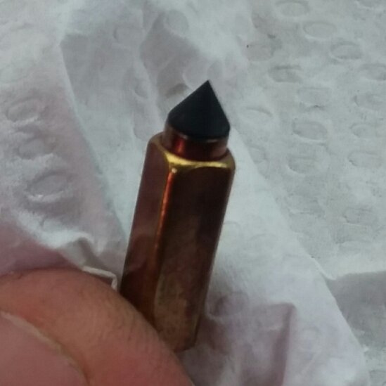

Carb is on the bench.
The float needle is sticking all the way up against the seat. The rubber tip is not letting it move freely up and down. Why is it sticking? The sides of the float needle travel freely up and down. It's the rubber tip sticking up not allowing the float needle full travel .
Also, the bottom of the spray needle has a ridge or slight groove around it. Not sure if you can make it out in pic..
Spray needle is clear as I can see right thru it
Thoughts?

Dan, the spray needle groove is from bottoming out but shouldn’t be an issue.
The float needle sticking is probably gum from the wonderful gasoline we get today.
Some carb cleaner and an old tooth brush on the needle and spray some on the seat, might take care of things.

Well, with the float valve sticking, it sure won't run.
The needle has been bashed into the jet one to many (hard) times and needs refurbishment before you'll get good control of richness and performance once the thing is running.
If the float valve has been forced into its seat, which can happen as the float is a great force multiplier if pressed on with a finger, then there will be some small damage/distortion to the Viton. Small amounts of varnish can also make things sticky, too.
I will stop with this advice: Float valves as bought from vendors, have a through-put of FAR less than the original valve. If there is any reluctance of the needle to release from the orifice, the pressure exerted on the needle by the fuel does not have the same area of pressure (compared to the original) to unseat the valve if it is anything less than perfect.

Swapped out the mixture needle for a new one, fixed double firing coils, and stopped coils from grounding out on coil box cover.
No wonder it wouldn't run.
It's all good now!
Thanks to all for kind help.

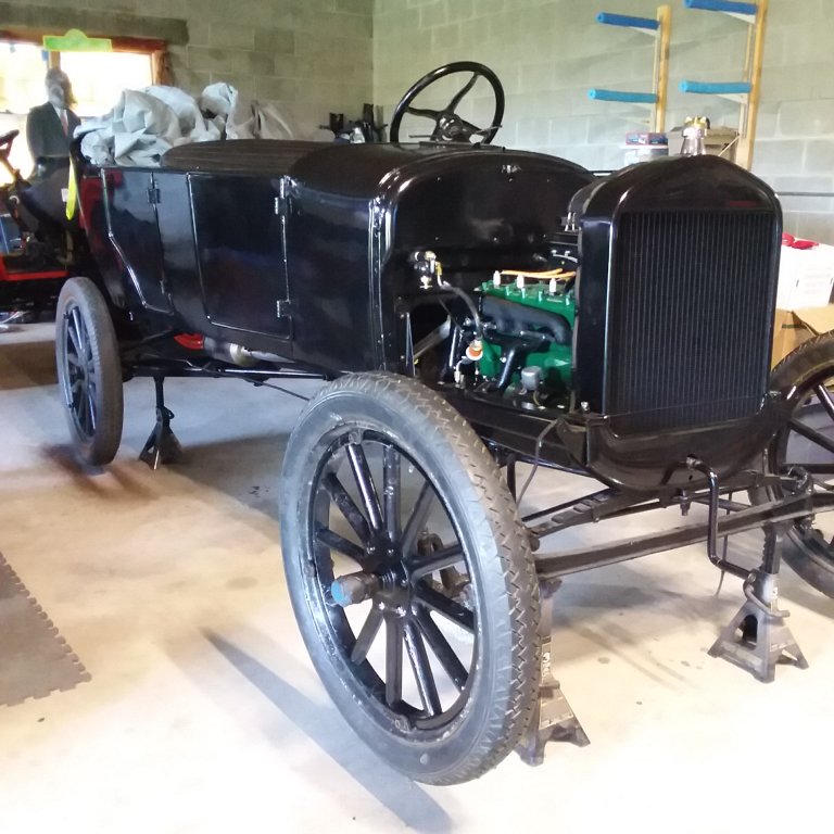

In addition to carb issues, I had a coil box cover shorting coils, three out of four coils were out of tune and double firing, and my ignition switch is still on the blink.
We fixed it all and ran a jumper to bypass the switch. My Al Clark rebuild runs like a sewing machine. It ran last night beautifully.
"HAPPY DAYS ARE HERE AGAIN!"
