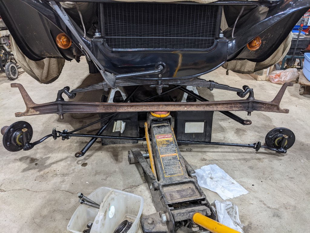

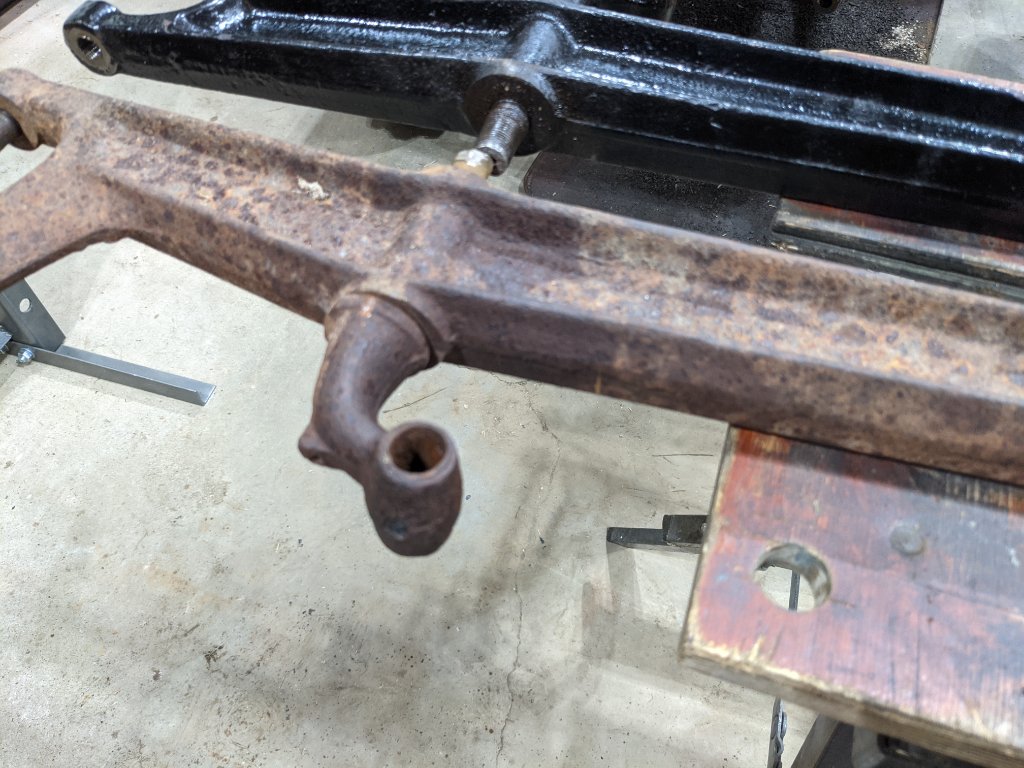

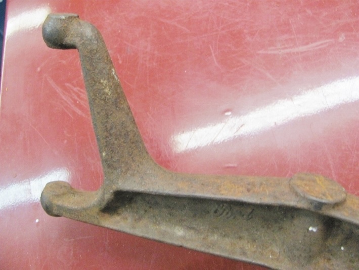

I recently rebuilt the whole front axle and steering parts on my Runabout. It was prone to a severe wobble at around 12-14 mph. I replaced the steering gearbox, gears, steering column shaft, pitman arm, steering bracket bushing, wood block behind the bracket, Anco adjustable drag link caps with solid, shackles, every bolt on the axle, wheel bearings, spindle- and spindle-arm bushings and a few other odd items I can't think of at the moment. There is no looseness in the assembly now. We took a short drive yesterday (about 15 miles) and we still had a severe wobble at low speeds whenever we hit a bump of any size. I would slow to a crawl to make it stop but it would return at the next bump. It was fine after we were on fresh smooth asphalt for the last 6 miles home but the wobble returned in my driveway.
I know that my left spring perch is not properly aligned with the spring. It's rotated slightly and the shackle is binding. That makes the axle assembly shift to the left when hitting a bump and initiating the wobble. That condition was not present with worn out shackle bolts. I need to get a hydraulic press to loosen the perch. It took weeks of fire, hand sledge and penetrant to remove the right perch. I was replacing that one and didn't care about damaging it. I don't want to do the same since I want to save the left perch.
Upon further study, I discovered that my right front wheel has 1 1/2" NEGATIVE camber. It's tipped in at the top and I did not notice that until now. I suspect that could also contribute to the problem of wobble. I want to straighten this axle if possible since I've put a lot into it, including Dan Hatch's repair inserts. Do you think the axle can be straightened with a press?
You can see a dip between the perch hole and yoke in this photo. I had not noticed that before. I'm having difficulty visualizing how I could support the axle in a press and get enough force to straighten it. Any thoughts you may have would be appreciated.

The dip may be an original flaw. The axle is more likely bent between the spring perch holes. Regardless, it can probably be straightened by working on the area between the perches, rather than the very strong short section between the spring perch hole and the end of the axle. Also, be sure your wheels/tires are in good shape.

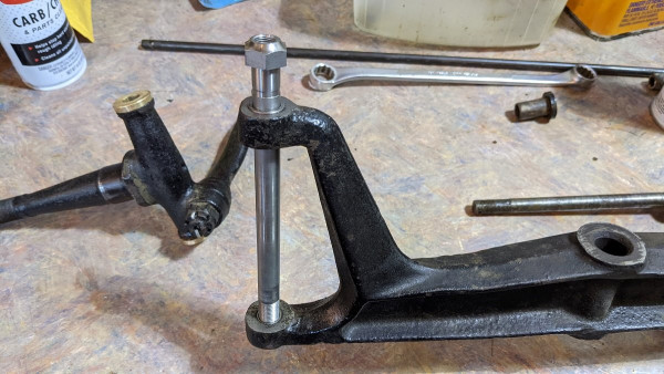

Scott, I used a 50" woodworking square to eyeball the angle of the spindle bolts relative to the perch mounting surfaces. I know, it's not alignment bars but fairly accurate and easy to use on the car. The left side spindle bolt is perpendicular to the axle, which it should be. The right spindle bolt is angled inward at the top noticeably. I don't need alignment bars to confirm. I have another axle that I will strip down and evaluate for suitability.

Post by Mark Nunn » Thu Sep 02, 2021 12:49 pm
After using heat and a press I was able to reduce the negative camber from 3.5 to 2 degrees. That was the limit of what I could do with my equipment. I decided to disassemble a spare front assembly. The distance between spring perches from what I removed and the spare is almost 1/4". I've never seen an axle drilled this far off. I will do a test fit on the car to see if this will be a problem. Wear in the perches and shackles is normal. I assume it's ok until proven wrong.

Mark, you may in fact have found two parts made different than each other, or you have just shown the result of a bent axle compared to a straight one. Impossible to tell without alignment rods.

Scott, you can see that the perch hole in the rusty axle is drilled off center.

Is it drilled off center or is it worn from running a loose perch?

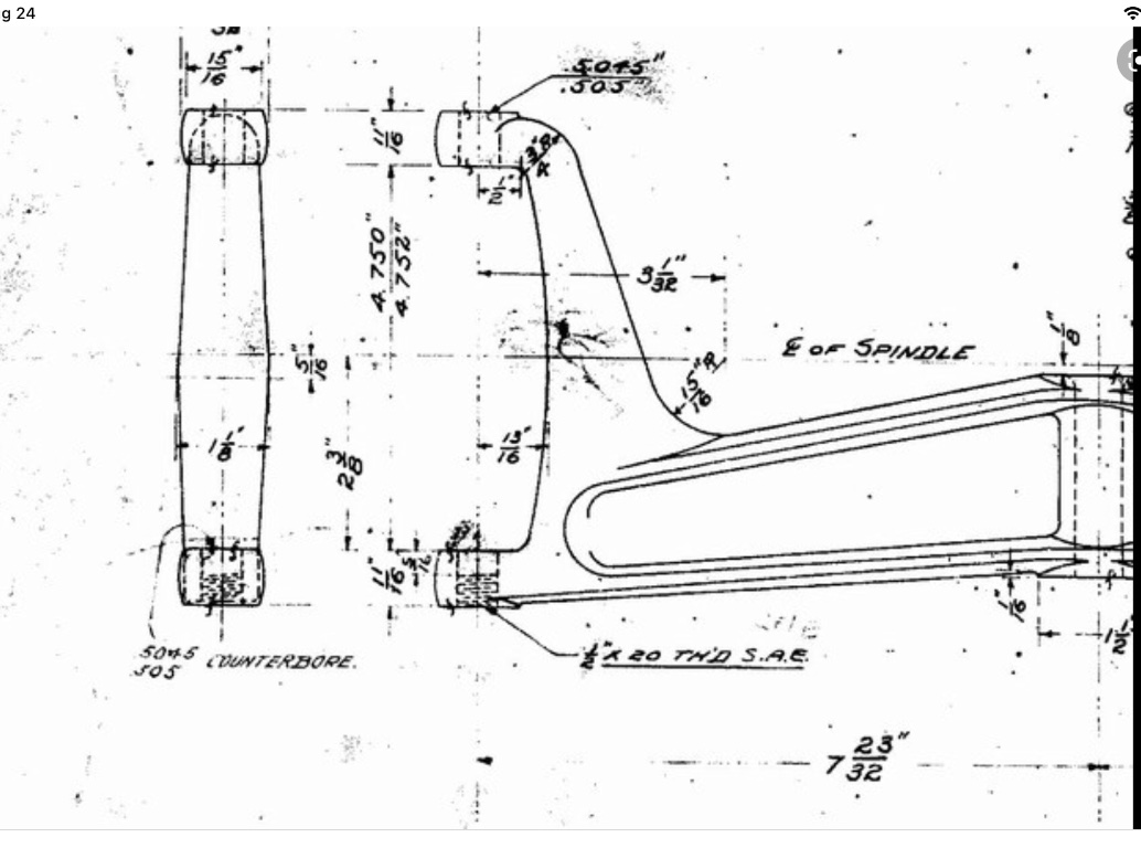

Posts: 4102
Re: Can this front axle be straightened with a 20-ton press?
Post by DanTreace » Fri Sep 03, 2021 9:48 am
Rather doubt that perch hole was drilled off center, print shows parallel of both perch and spindle holes in the axle.

Pat, the hole is not worn. It took heat and my press to remove the perch. I inspected the hole and it was drilled off center. I will get dimensions today. I compared the kingpin to kingpin distance of these two axles and they are the same.

Mark, how is the other end perch hole. Is it off centre as well?
Allan, yes but not as much. The black axle has perch holes 36 1/2" appart and the rusty one is 36 11/16". Kingpin spacing is the same between the two.
Edit: I mistakenly typed 36 11/32" rather than 36 11/16". The difference is 3/16".

TXGOAT2 wrote:
Fri Sep 03, 2021 7:11 pm
I'd think they'd have used some kind of gang drill arrangement. Ford invested in a lot of specialized equipment. Maybe a bit broke or spun in the chuck, and this axle was rejected and diverted to a repair station where it was hand drilled or put in a drill press, then put back on the line or sold as a replacement part.
Yes, automated process to control drill hole locations on the axle for the perch and spindle holes. Tight tolerances. Holes were drilled rough then reamed to precision size. Would be very odd to have an axle drilled poorly. This is from 1915, so you know better machines were later in place.
If the bore of those perches holes are off that much, I wouldn't use that axle.
I have an 'un-drilled' axle forging, taken I think off the line for QA, as it has a square cut out section on the channel rib, guess for metal checks.
Nice and NOS, but no way to use it ;)

Thanks Dan. I suspected as much. That is the best way to keep all the holes aligned and positioned relative to each other. So if one perch hole is out a bit, I figured the other may be as well. It just means that that particular forging may not have been mounted in the optimal position for the machining operation. It should not detract from its functionality. It would be interesting to see the relative positions of the king pin holes in the end yokes as well.
I did not expect the 5/32" variation in the spacing of the perch holes between the two axles, but it is not a lot in the scheme of things.

Allan, I mistyped my dimensions in an earlier post. I corrected that. The difference is 3/16", not 5/32".
I put the odd axle in the car and put weight on it. Everything looks like it will work OK. That axle has been used for many miles. It was repaired at some point with Steven's inserts and it is tight and straight. I plan to use it since the old one is unsafe. The old has 2 degrees negative camber on one end and 3.5 degrees on the other. That explains why I spent hours bending spindle arms to eliminate binding. I have other arms to use if I need them.
