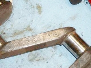

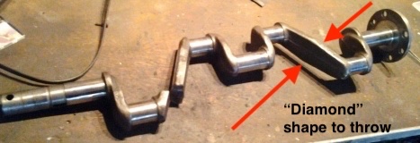

- Posts: 5273
Re: Crank counterweights
Of the 2 pix, the 2nd is the diamond crank. The center of the throw is wider than @ the rod or crank throw ends. Narrower also.
The first crank is the late style. The throw sides are parallel & heavier.

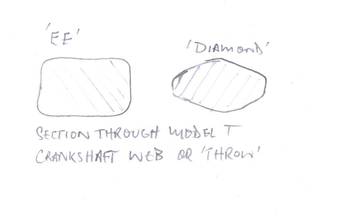

Luke
- Posts: 617
- First Name: Luke
- Last Name: P
- Location: New Zealand
Jonah,
They're not the best photographs to demonstrate the cranks differences. No doubt someone will come along with a broken piece that'll better show what they look like, but for the moment I've drawn a section of what the web (or 'throw') would look like for each crank if you were to cut through it.
This is clearly not to scale, and I've exaggerated the shape of the 'diamond' crank a little, but hopefully it'll make sense?

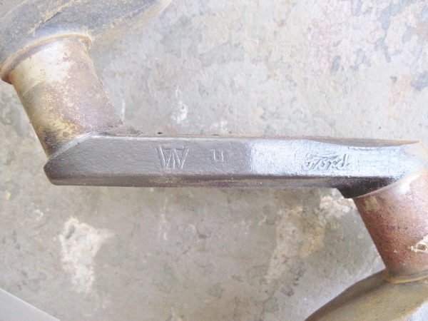

- Posts: 4098
From Bruce's encyclopedia
"from 1909 until about 1924 the crankshafts were made of Vanadium steel. These seemed to have the diamond-shaped throws between the connecting rod bearings.
About 1924 the material was changed to a heat- treated type and the throws became more rectangular in shape. These were imprinted with “AA” on one of the throws.
In 1927 the material was again changed and was identified by an “EE” on the throws. This final type is believed to the best of the cranks."
Generally the date of change to the 'EE" material happened after July 1926, with the start of 14,000,000 engine serial #s.
