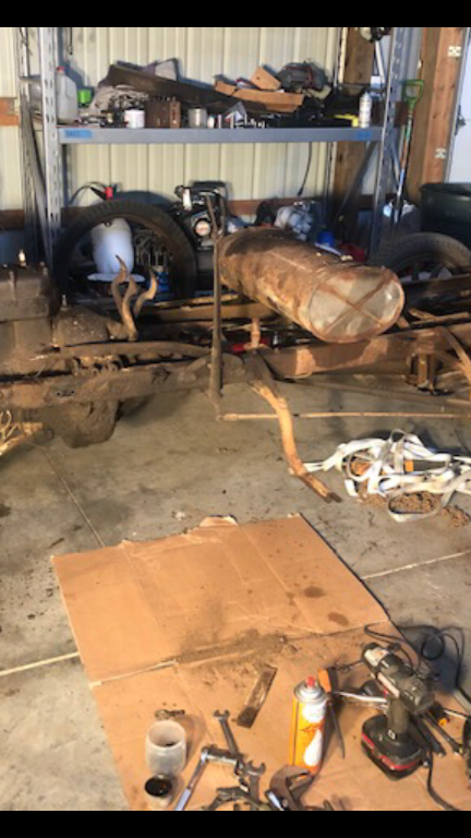

I put the 22 Touring body on the chassis today and noticed the starter switch with the extension on it is not high enough to extend thru the floorboard. Can someone post a picture of the starter switch mounting and how it comes thru the floorboard? Thanks, Art

The mounting plate is mounted under the top frame rail with the switch mounted to the bottom of the plate. Art

Here is the best picture I have of the switch before It was taken off. I put it back the same way. If the switch plate was mounted in top of the frame it might just correct the problem. Art

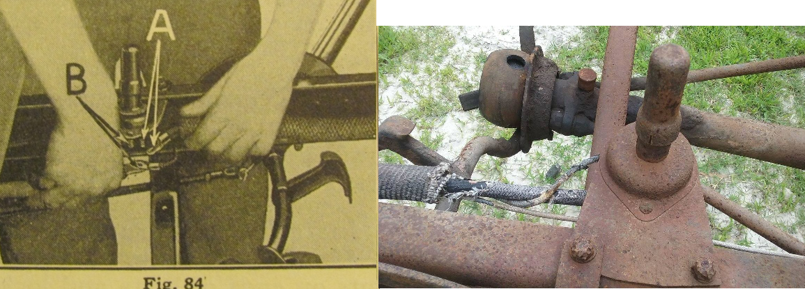

Post by TRDxB2 » Thu Sep 02, 2021 10:14 am

Seeing the pictures in the one link, is what I was thinking. When mounted under the frame rail, there was a jog in the bracket. When mounting on top, was flat. Is this 100%, probably not but might be good rule of thumb. :)
