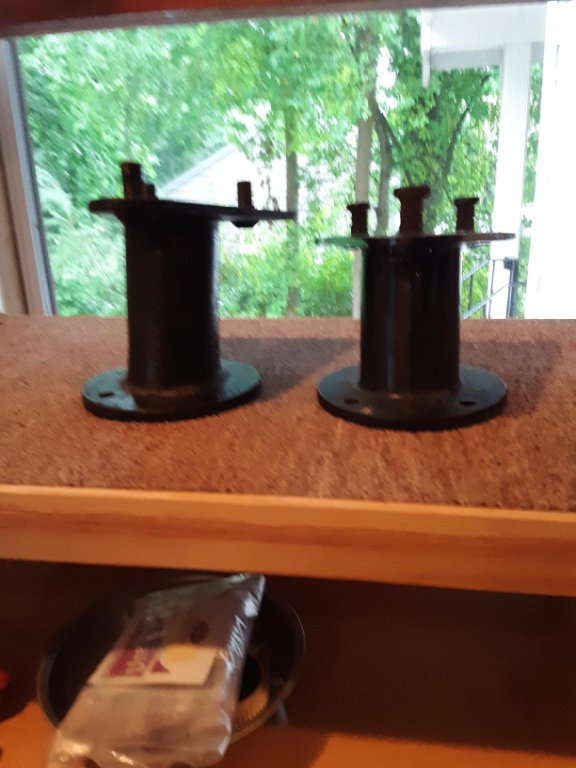

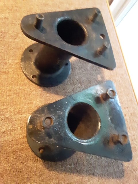

spare tire carrier year of service
The tall base has Ford script with PN T 7316 A1.
The small one is not Ford, however, has the same part number barely legible of PN T 7316 A1.
Same part number different height? What do these go to? What gives?
Thanks,
John.

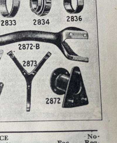

Re: spare tire carrier year of service
I believe the 4 bolt was used on the early '26 roadsters. My October '25 build of my 26 roadster had a 4 hole mount. The bracket was missing and I was able to get a nos three-hole spare rim bracket. I brazed the bottom whole closed and drilled two new holes to match the body. The Ford List of Parts shows the 4 hole image.

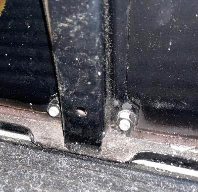

- Posts: 4113
Those mounts may have been used as available, the parts book shows the 4 hole, while my Nov. ‘25 runabout used the 3 hole. Note the single hole in the deck, the two lower holes are in the rear sub frame.
Wonder if the 4 hole was used mostly on coupes?
I definitely think the four hole ones were of early cars. I had a discussion with Donnie Brown about this and we decided that even though the parts book of 1928 shows the 4 hole one and that the later cars of '26 and '27 used three hole mounts, Ford never upgraded the illustration in the parts book even though the later cars were using the three bolt type. Why did they change? Just to save the cost of a single bolt, nut and washer? Well, two bolts at the bottom were not really needed, one would do. There would also be the labor cost of installing that extra bolt. The three bolts instead of four would save some money. Was it worth it to Ford? There are so many differences between the early 26s and the later ones. That topic is for another discussion.
So the single bolt was at the top in the later roadsters and coupes, not at the bottom. So that is why I adapted the tire carrier to a four bolt type for my early '26 because the reinforcement where it attached inside the trunk showed two places to attached two bolts.

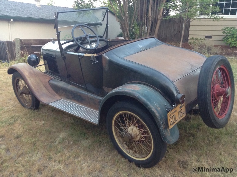

Kevin Pharis
- Posts: 1658
- First Name: Kevin
- Last Name: Pharis
- Location: Sacramento CA

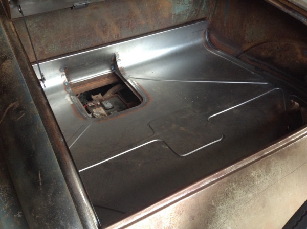

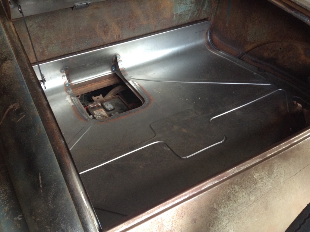

Dan, I have a feeling you’re trunk got swapped out with a later ‘27 model somewhere along the line... The ‘26 model cars had a simple trunk floor with a small dog house to clear the rear crossmember, that was attached to the sub frame. The ‘27 model had the embossed trunk floor that rolls up in the front, attached to the trunk.
Here’s a pic of the one I made, as the ‘27 model floors are not being reproduced
OK, I see the 3 v. 4 hole phenom. However, why are they different heights and the diameter of tubes are different sizes?
Just curious!
Just curious!
