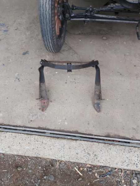

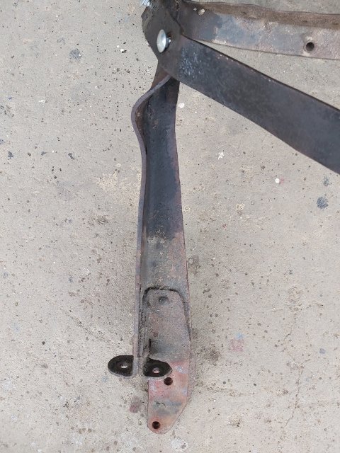

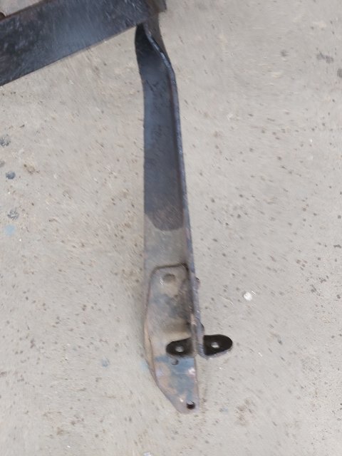

Up to the bit of the restoration where we put the Spare tyre carrier in place, before I pull it all to bits to start the paint.
Do the kinks in the arms look right? The left has a much more pronounced kink than the right.
Got a fair bit of straightening up of the lighter flat steel.
The angle brace across the top measures 17 1/2 inches, which I gather is correct for 21 inch rims.
Opinions on the distortions ( if that's what they are) in the arms would be appreciated.

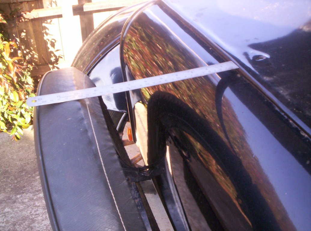

An easy one to answer, the kinks shouldn't be there at all. To give you an idea on the angle when things are all straight. Top of the spare is about 9" from the boot lid edge.

OK . Thanks for the quick reply. Appreciate much the photos. Out with the Oxy Acetylene torch and the anvil in the morning.
