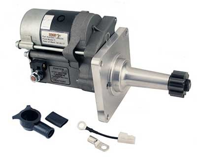

Ok.... I realize I'm on thin ice here but I found out something I thought I should share. I made the choice during the resurrection of of my 1917 to add a starter and go 12 volts. An original 6 volt starter worked...but not great. After a few tours I updated to a WOSP 12 volt geared starter that I absolutely love. With the original starter there were times when the car was hot that I had to get out and crank it off compression or the starter wouldn't turn it over (I have a Z head.) With the geared starter there is never a problem! I also don't have to worry about damaging the Bendix and all the problems associated with it. Am I missing the Model T experience? If you mean being stalled in the middle of a busy intersection and not being able to start my car, not at all....
As others have noted, the WOSP starters can be pricey. I decided to try to track them down to the source for a friend and here is what I found <http://www.wosperformance.com/stockists/wosp-usa/> I communicated with Ben at Raceparts USA and he quoted $356.25 plus shipping (approx. $20 for ground). Not a bad price in my book. $475 from Snyders. Your car, your choice.....
The starter is a WOSP LMS256

I know several people running them & very happy. If one HAS to run 12v, its an option. With the option of modifying a stock starter,(done it) Its not something I would run. If I did, I would not be in a hurry to show it off. It dont look right on a T IMO.
Good on ya for finding the source & saving big $$.

I am running 4 of these British starters
2 on t’s and 2 on a’s
This starter coupled with a good battery and you are good to go for a while. Bicker all you want, I like drivability.

FWIW: These starters are developed by Niel Tuckett and the WSOPerformace in a joint effort, according to Tuckett themselves.
https://www.modeltford.co.uk/product-pa ... rter-motor
The Tuckett brothers are some of the biggest supporters of the Model T hobby in the UK, Niel is author or co-author of several Model T books and runs courses in driving and maintaining the Model T. Now who does that in the US?
https://www.modeltford.co.uk/courses
So buying this starter from Tuckett Brothers in the UK is definately supporting the hobby WW.

That starter has been around for several years for a variety of cars and on a few new cars even.
The only new part is the adapter plate that was designed to bolt it to a Model T.
Buckeye Electric in Ohio is the official repair facility and has all the spare parts required that might be needed.
The last time I talked with Generator Joe there he told me they had never been sent a bad starter in need of repair.

I have a geared starter on my Model A. The gear at rest is in front of the ring gear. It has a built in solenoid that has 2 functions.
First it pushes the gear into mesh.
It then energizes the motor to turn the engine.
This eliminates clashing of the gear and the ring gear bevel is not used.
I put one in my A because the ring gear was walking forward and I did not want to pull the engine. I tapped the ring gear back. It has worked well for several years. Downside looks very untraditional.

Of the four I have installed two have leaked oil, problem is when machined cut into bolt counter bores,I spoke with the
man in Ca six months ago and made him aware of problem, remove allen bolts and look carefully in counterbores to see if the machining cut into bores , if so seal with ultra black no big deal to check and might save you from pulling starter back off!

FWIW - before deciding to buy the 12 volt starter I took my original six volt along with a diagram on how to rewire it for 12 volts to an old-time automotive electric shop. A fellow I have known for years flat out refused to do it and gave me several reasons why it was a bad idea. I know others have re-wired them successfully so I won't get into that. Regardless, I was committed to staying with 12 volts and wanted something reliable. My original starter had given me trouble on a number of occasions, often refusing to turn the engine over when it was hot. On the covered bridge tour I needed help repairing a bendix that failed because of an improperly installed (not by me) woodruff key. Before you ask, the starter was a recent rebuild by a reputable rebuilder so it should have been up to it. Since I was committed to 12 volts, a 12 volt starter seemed the smart choice rather than trying to make my original starter do something it wasn't designed to do. I've put over 2000 miles on my car since installing the geared starter - it has never given me the least trouble, starting my car quickly whether cold or hot.
The fact that it was designed by Model T people (Tuckett brothers) for Model T's makes me feel even better about my purchase, which was from Snyders BTW.
