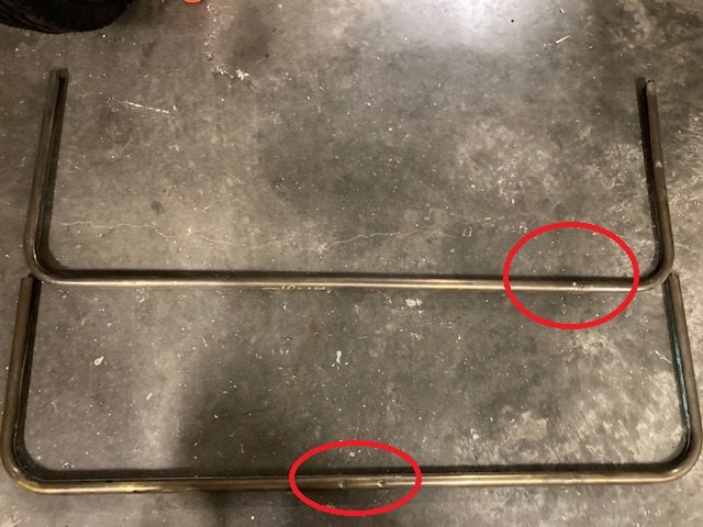

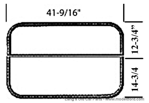

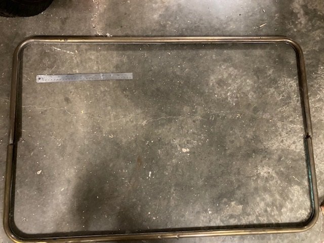

I have a used brass windshield frame pictured. So I have this diagram from Lang's which looks to be the proper dimensions but doesn't include how to tell the glass shop to cut the curves? I am intrigued of using Lexan, DYI'ing it and not having to do the glass shop. Lang's says 3/16th 0.1875 thickness but my home store only has 0.118 thickness or much larger.
Also the frame has only one through and through hole on one side of the larger bottom part and 2 holes in the middle of the upper part. I am thinking rear view mirror for the upper part? But only a single hole on the bottom, I wonder why?

The two holes may have been for the manufacturer's tag. The single hole was probably for a windshield wiper.

The two holes may have been for a review mirror.

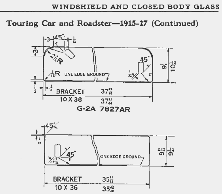

Is the windshield frame a Modet T part or is it unknown? If Motel T, the glass manual will have dimensions. Another option is to use cardboard or hardboard to make templates.
- Posts: 7411
Re: Time to get windshield glass or Lexan, what size and curves?
You want Ford's glass book. It gives measurements and diagrams. I don't recall the title, but I think you will find it here: http://acimorelli.readyhosting.com/mtdl/default.htm
Pay attention to the book. Significant parts of the design may not be obvious if you just have glass cut to fit the frames.

I found: "Specifications and Sizes of Ford Windshield and Closed BodyGlass" the closest thing I found was a 1915 but the lengths and widths are not the same. I wonder if this size pre-dates 1915?
Steve Jelf wrote: ↑Sun Sep 05, 2021 10:32 amYou want Ford's glass book. It gives measurements and diagrams. I don't recall the title, but I think you will find it here: http://acimorelli.readyhosting.com/mtdl/default.htm
- Posts: 7411
Possibly so. Compare it to photos of earlier cars. If you find any that seem to match you can ask the owners for measurements.

When I made the windshield for my speedster, I found an inexpensive frame at a swap meet and narrowed it to fit. I cut a piece of Luan plywood to fit the frame exactly how I wanted the glass to fit and gave it to a glass shop to use as a pattern. They cut a piece of laminated safety glass to match my pattern and it fit perfect.

Great idea. I have some luan.
Ed Fuller wrote: ↑Sun Sep 05, 2021 3:57 pmI agree, don’t bother with Lexan.
The same glass shop cut two pieces of laminated safety glass to replace the plate glass for the windshield in my late ‘13 Touring for around $100.
