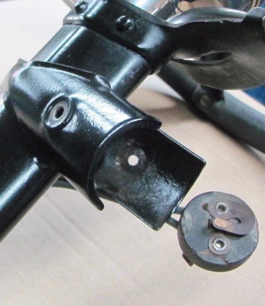

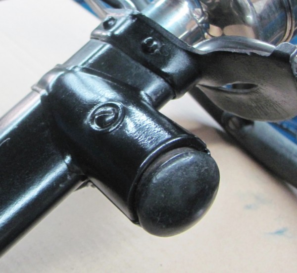

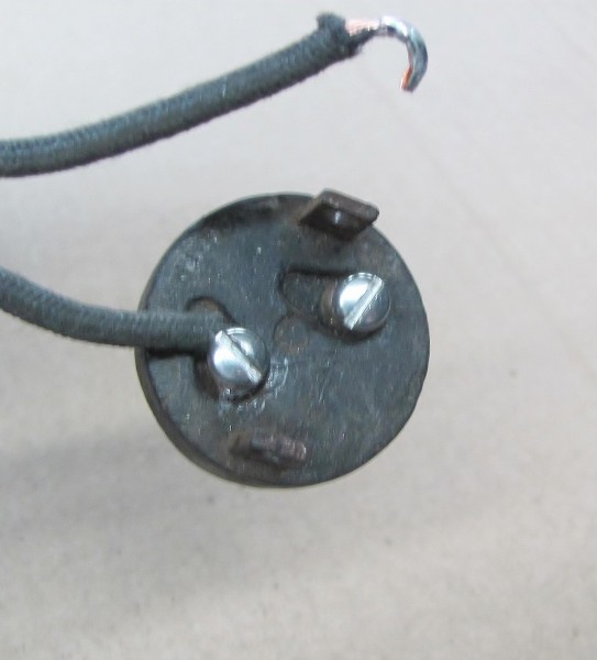

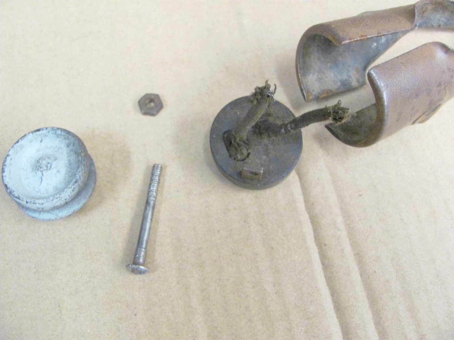

- Posts: 3952
Re: Need horn help
Jeff
You can repair your old switch, better than the reproduction steering column switch IMO.
