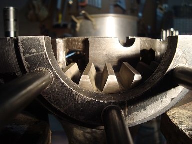

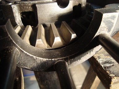

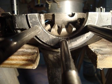

Re: Zero Ring and Pinion clearance - HELP!
Here are some pictures of the ring gear inside the housing. Does it appear that it's sitting a tad too high, or am I just seeing things? Does it look like it's sitting in the housing correctly?
- Posts: 5620
- First Name: Henry
- Last Name: Lee
It might be high but just go back and reinspect those spacers. You wil win the battle. I have always after everything is assembled, install the other housing, bolt down to verify there is no binding or other issue before setting the lash.

Scott, when doing this test do I leave a roller bearing inside the left housing?
- Posts: 6806
Bill, if you did that, you would have the most accurate reading, as the axle will not be trying to wander all over the place under the indicator gauge's probe.
remember to lift the inner assembly via the axle that is pointed toward the floor...if you mistakenly lift by the axle pointed "up", you will also be measuring whatever slack there is inside the differential (there should be a fiber or maybe metal shim between the axle ends), and you don't want that amount of measurement to mistakenly be taken as movement of the differential which is what is being shimmed.
RGould1910
- Posts: 1241
- Last Name: Gould
- Location: Folsom, CA
The two quietist rear ends I have put together averaged .015" ring and pinion lash. I was told the lash from the factory was .025". One of the problems is you never get an uniform reading when checking gear lash in varying positions. The usual variation is about 5 thou. Minimum clearance in any position should never been less than 6 thou. For me, even that is too close. With rear ends, looser is better than tighter.
