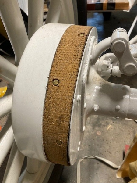

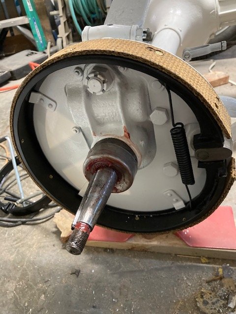

Hi, the rear brake linings are on but now the wheel won't go on. The other side went on snugly and does not roll freely. This side doesn't seem to go on at all. What am I doing wrong?

Re: 26-27 Rear brake linings are on but wheel won't go on.
From the pix, I see your shoe IS NOT ROUND.
Note the relation between the cam end & shoe end. They are squeezed in. Tight @ top & bottom.
Pull the shoe & fit inside the drum. Bend round, like you do for transmission bands.
There may be some unnecessary, excess lining @ the ends. Chamfer those edges.
Dont be to quick to grind on the lining face. Over the rivet holes to remove created burs yes.
The lining I have been getting from the vendors doesnt need to be thinned to fit.
When you get the wheel on all the way, you may need to chamfer the outer lining edges.
Your outer seal cup may not be in/on all the way.

I agree that the ends of the linings don't look like they are rounded with the shoes. From the second picture, it is hard to tell whether the drum has slipped on a fraction of an inch or if it is butted right against the lining. In the picture, it looks like the drum is lower than the shoe, because I can see a space between the lining and the drum, but on the top, it looks like the drum is either very thin or the edge is below the lining.
This is what I would do first 1. work on the ends of the lining to get them even with the rest of the lining, such as grinding them off. Then try on the wheel again. Be sure it fits all the way around. Lastly, if the other steps don't work, use a flat sander or a rasp and work on the surface of the lining. try to take off only the small amount it takes to get the drum to fit all the way around remembering that as you push on the wheel the taper will center the wheel on the lining.

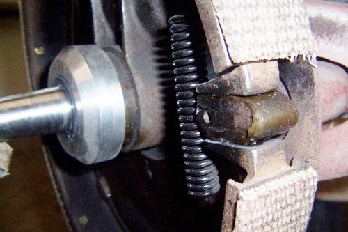

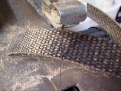

The first photo shows the standing up edges of the new lining on the shoe.
Have used before a coping saw blade and cut the edges at an angle so they don't stand up. Think the issue is those two leading edges, as they should be flush.
Or these edges can be sanded down, a bench sander works or a bench grinder. Take care of the dust made and the brass wire contents as you grind away.
