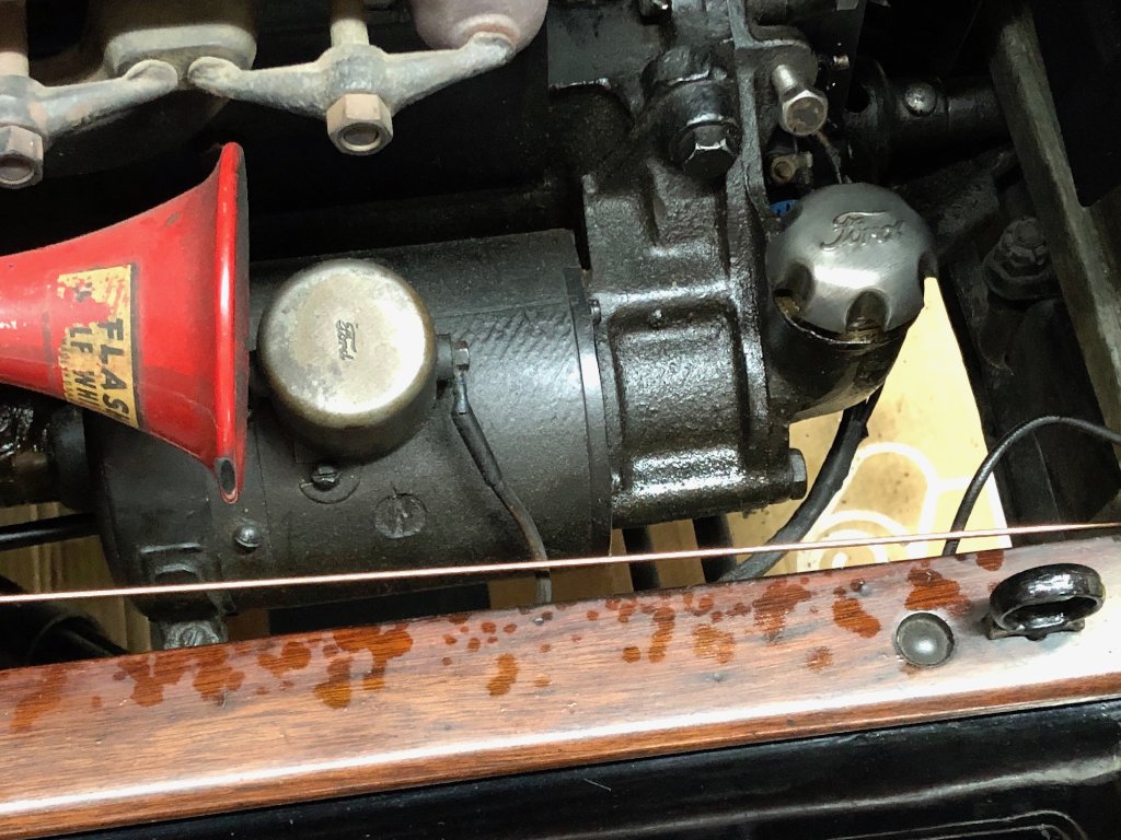

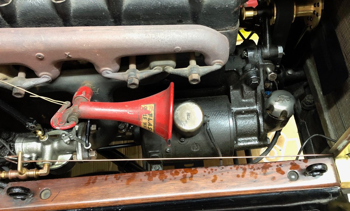

Oil Droplets Out of the Breather?
I changed out the fan hub to a ball bearing model because the hub was slinging grease out over the hood & wooden hood clash strips. It works great, no more messy grease. There are still deposits of oil on the wood. It looks like it might be coming from the oil breather/filler cap. My '23 with a fresh engine does not offer to lube the outside of the motor like this one does.
The motor in this '14 car is a '19 and possibly it is somewhat tired and allowing blowby, exhaust gases passing into the crankcase which might tend to force air & oil droplets out. If so, it hasn't shown up with dark oil in the 100 or so miles since the last oil change.
Are these oil droplets normal?

It's probably blowby escaping from the oil cap or the hole where the throttle rod goes through the block. But it could be a front seal leak or a pan leak. It's not exactly normal, but is not uncommon on engines with miles on them. I'd be sure the oil level is normal, and if the engine runs well I wouldn't worry about it. You might try running the car with the fan belt off for a while and see if you can get a better idea exactly where the oil is coming from. Could it be coming from the timer?

The pictures shown were taken after an easy run of 25 or so miles to get the cooling system flush good & warm. It did that in low 80s weather the motor got hot enough to split a little when I stopped to shoot some pictures.

It could leak at the generator, too, or the valve cover plates. The rings could be sticky. They're probably worn to some degree and may have lost tension. But I'd look carefully for leaks. If the rings are worn or sticky, the blowby will aggravate any leaks. Changing the oil won't hurt it, and it might help.

You could look at this as a positive! You know you ARE getting oil to the front of the motor.
If you take the breather cap off you will get some spray even with a good engine at speed. Between the pistons going up and down and the cam/generator gears spinning, some does come out.
