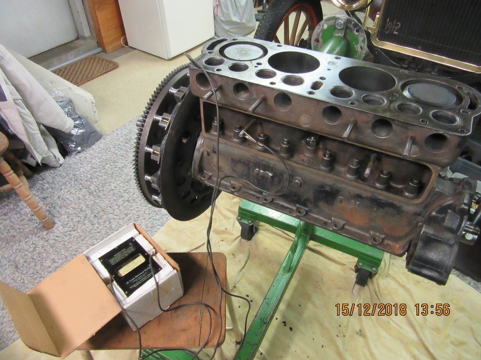

I have my engine out and partly apart to fix an issue with the clutch. The top terminal of the coilring was broke and now when that is fixed - how do I verify that there is no shorts to ground?
My plan is to set 6 or 12 volt to the terminal and ground and then test every coil with a piece of sheet steel to see if it gets attrackted to every one of the 16 coils. I may also use a compas. If the coils suddenly stops working there is a short to ground. If non of them works, there is a broken connection somewhere.

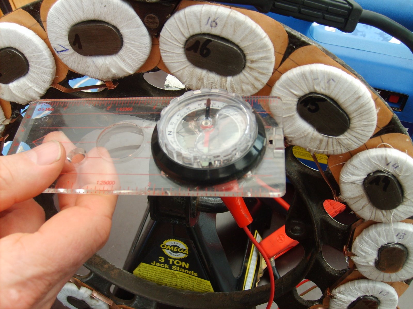

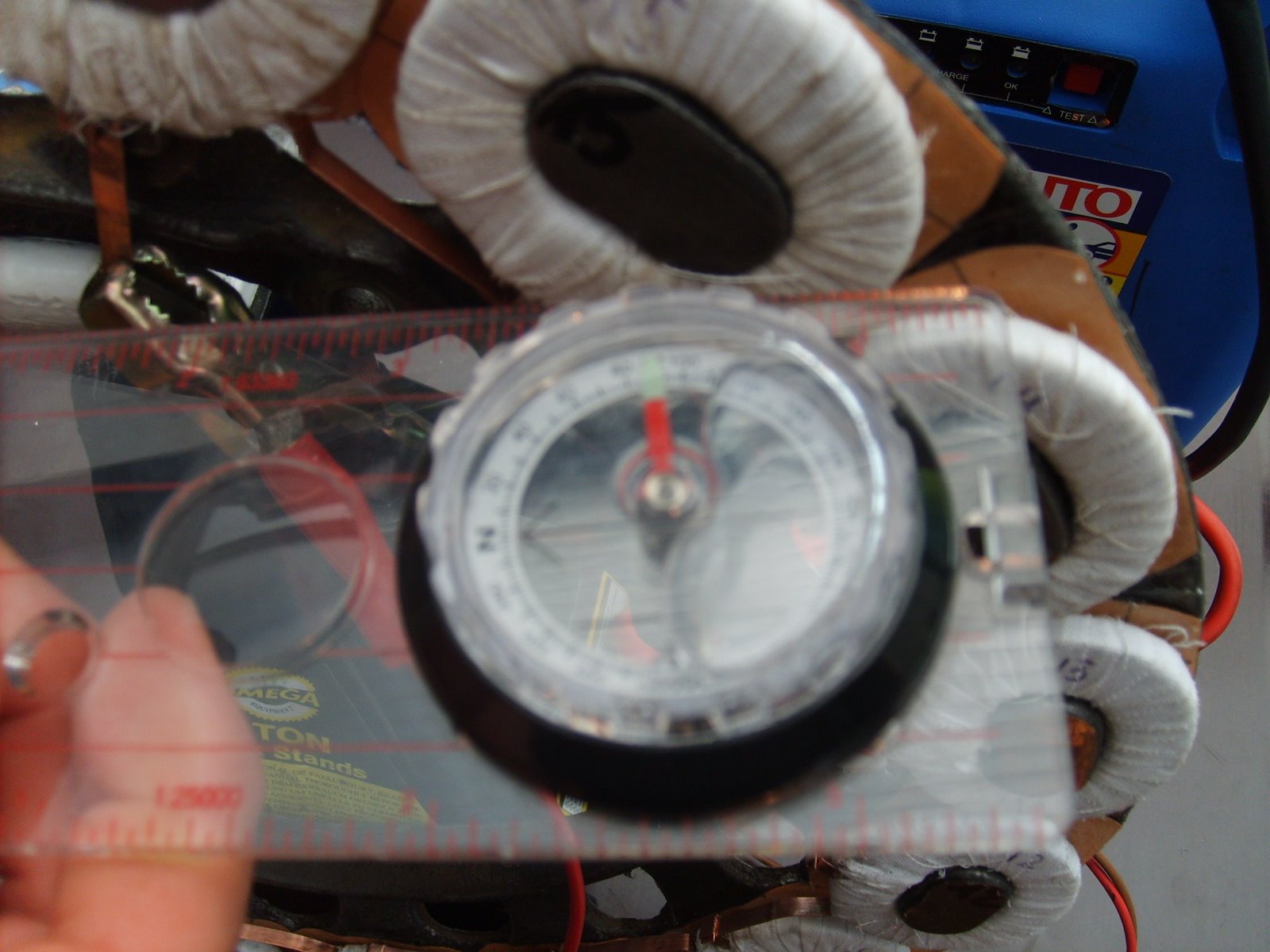

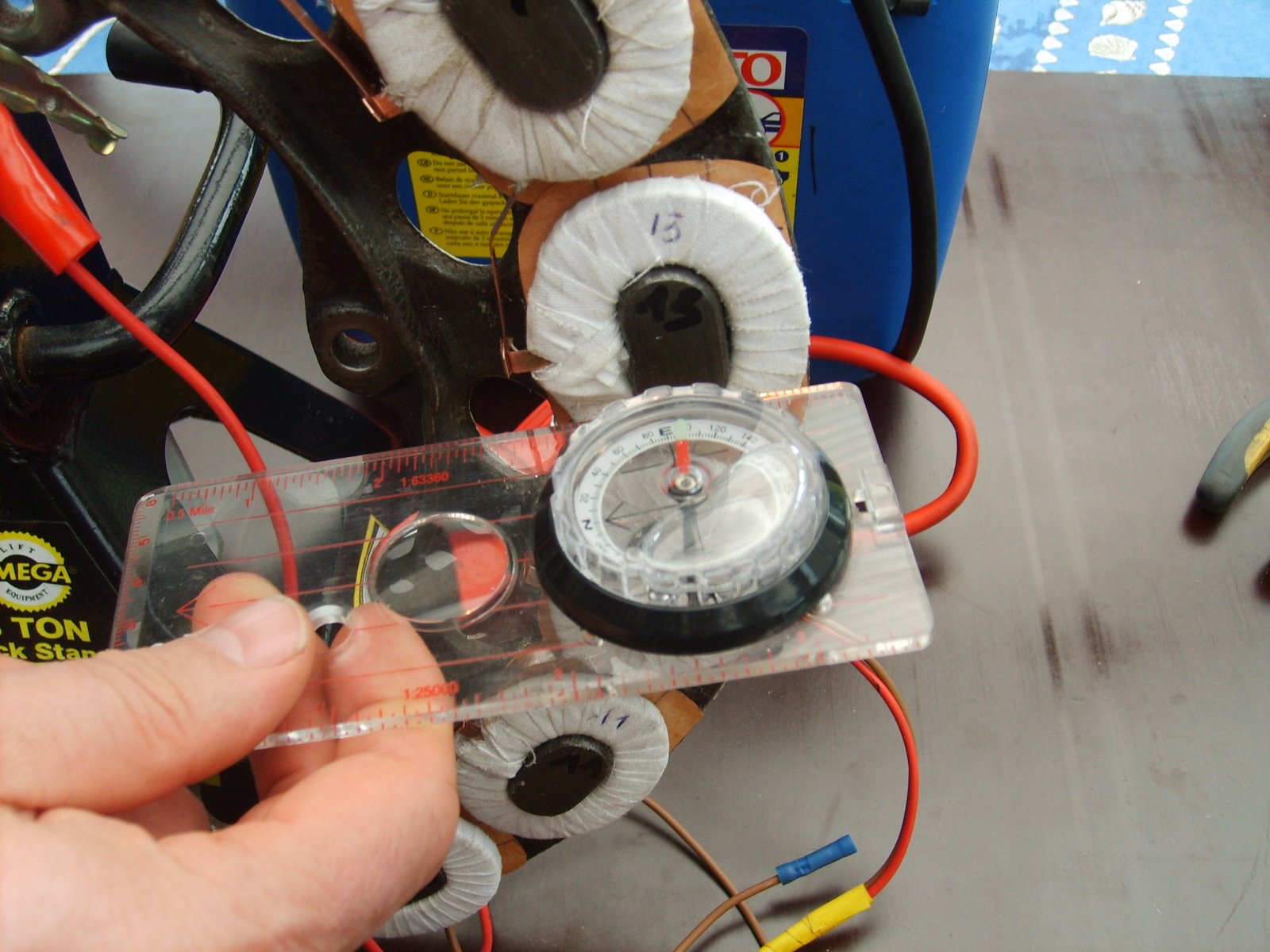

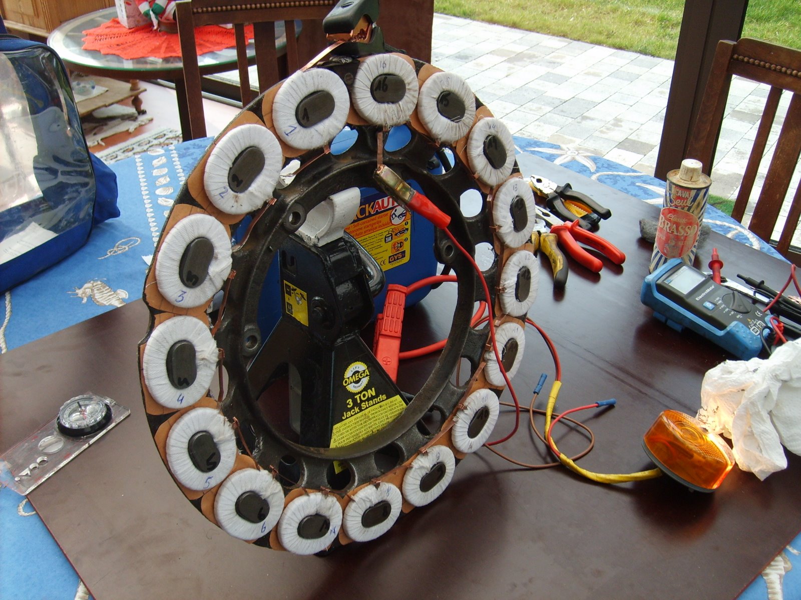

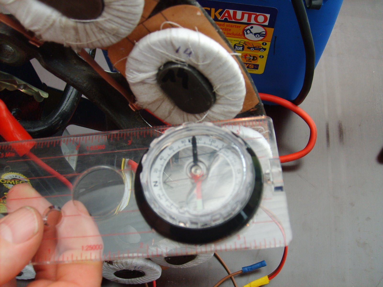

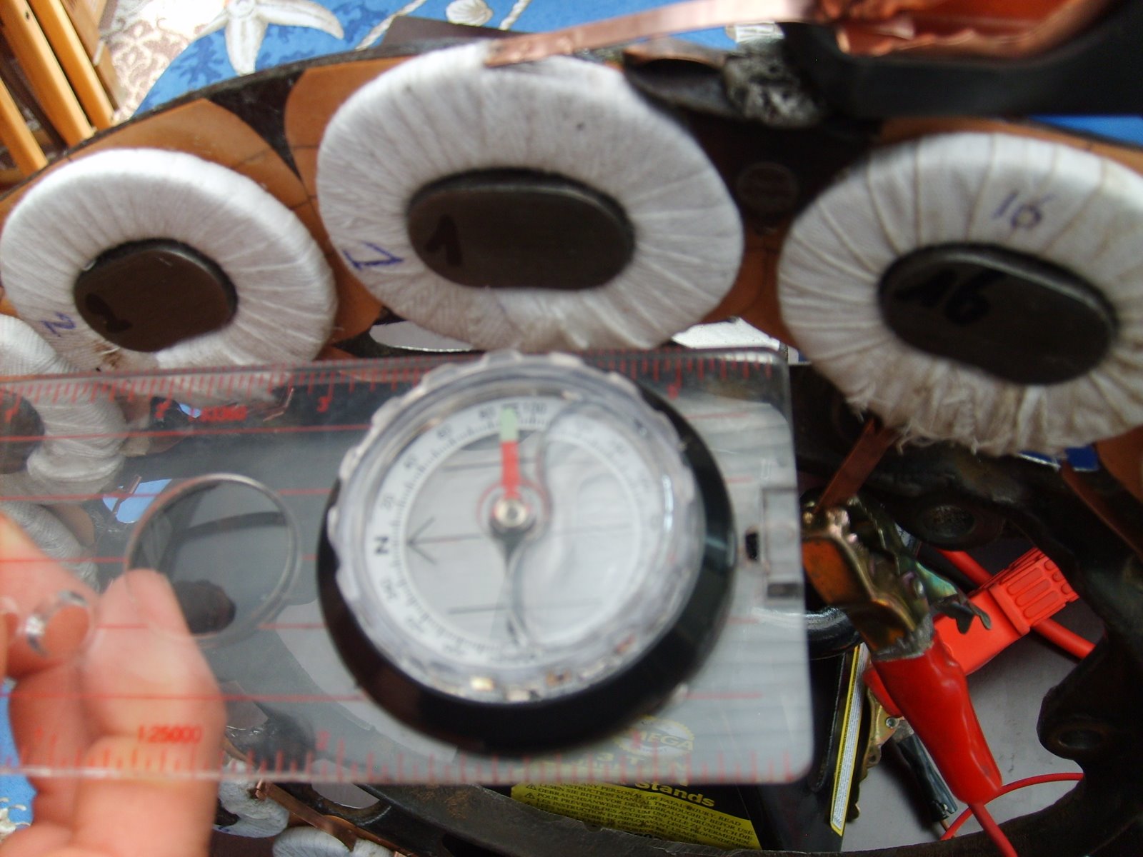

You not only need magnetisme on each coil but the magnetisme also need to change N-S between each coil.
To control this make a loop with a 12V 21W light bulb, your magneto coil ring and a 12V battery. Use a compass to check the magnetisme and the change N-S.
Good luck
