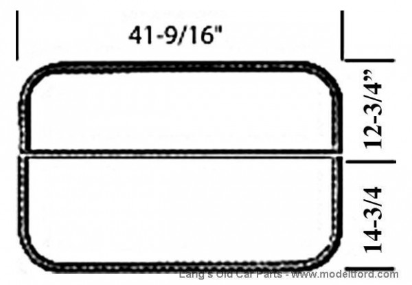

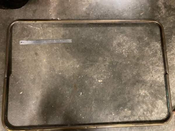

I have a used brass windshield frame pictured. So I have this diagram from Lang's which looks to be the proper dimensions but doesn't include how to tell the glass shop to cut the curves? I am intrigued of using Lexan, DYI'ing it and not having to do the glass shop. Lang's says 3/16th 0.1875 thickness but my home store only has 0.118 thickness or much larger.

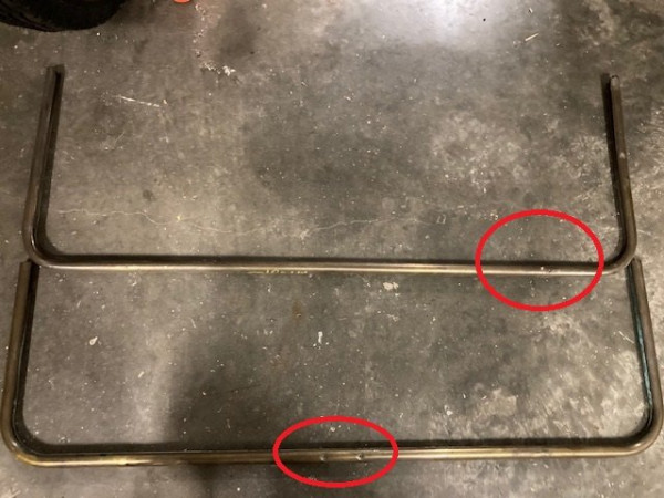

Also the frame has only one through and through hole on one side of the larger bottom part and 2 holes in the middle of the upper part. I am thinking rear view mirror for the upper part? But only a single hole on the bottom, I wonder why?

I would get it cut out of laminated glass. If you give the glass place the frame they can fit it for you.

The two holes may have been for the manufacturer's tag. The single hole was probably for a windshield wiper.

The two holes may have been for a review mirror.

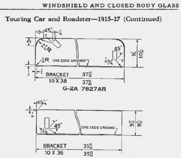

I found: "Specifications and Sizes of Ford Windshield and Closed BodyGlass" the closest thing I found was a 1915 but the lengths and widths are not the same. I wonder if this size pre-dates 1915?
Steve Jelf wrote:
Sun Sep 05, 2021 10:32 am
You want Ford's glass book. It gives measurements and diagrams. I don't recall the title, but I think you will find it here: http://acimorelli.readyhosting.com/mtdl/default.htm
Pay attention to the book. Significant parts of the design may not be obvious if you just have glass cut to fit the frames.
Posts: 7411
Re: Time to get windshield glass or Lexan, what size and curves?
Post by Steve Jelf » Sun Sep 05, 2021 3:34 pm
Possibly so. Compare it to photos of earlier cars. If you find any that seem to match you can ask the owners for measurements.

When I made the windshield for my speedster, I found an inexpensive frame at a swap meet and narrowed it to fit. I cut a piece of Luan plywood to fit the frame exactly how I wanted the glass to fit and gave it to a glass shop to use as a pattern. They cut a piece of laminated safety glass to match my pattern and it fit perfect.

When I did my touring, I had an auto glass shop fit the glass to my original glass channels. 110 bucks total for both frames.
I told them to cut the glass in such a way that there's no modern markings on the glass.

You don't need a pattern or any specifications as to size, or any factory specifications which may not even apply to your particular screen, if you just deliver the frames to the shop for them to cut the glass to fit. Job done!
