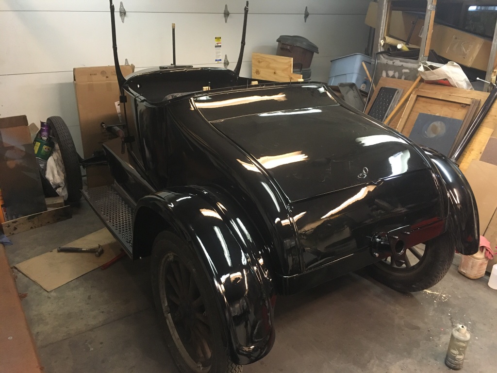

I used a single stage urethane "Boulevard Black" from Eastwood paint and it really turned out well. I am planning on using a single stage urethane again on my next restoration project.Myxr6turbo wrote: ↑Thu Sep 09, 2021 3:07 amWhats everyone thoughts and experiences who have painted theirs?
Here is a post that I wrote two years ago summarizing my painting experience that you may find helpful.
viewtopic.php?f=2&t=6764&p=51027#p51027

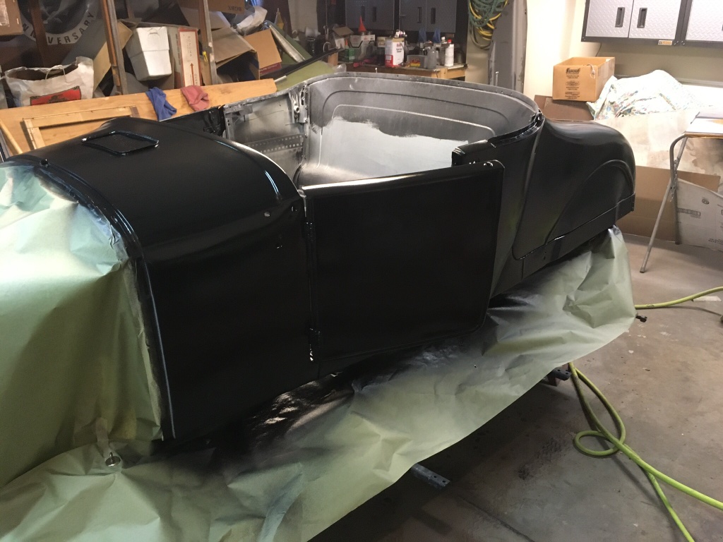

]Last year I shot my’26 Runabout at home with Summit Racing’s single stage acrylic urethane in black. I used their epoxy primer and then their high build primer. Their website has a check the box shopping list so you know what you need to buy for each paint system they sell.I went with Summit after my DuPont paint supplier retired.
I ended up buying a pneumatic paint shaker after breaking off the stirring stick in the paint. It was the best $100US I ever spent. My wife often brings me her house paints so it gets used on other jobs.
As others have said, the new paints are toxic. I wore a Tyvek suit and moved my missus and her dog out of the house. I have a Hobby Air breather that forces clean air through a hose pipe into my fireman’s mask that covers my eyes, nose, and mouth. Several have advised me that carbon masks are no longer safe.
I have painted my cars with acrylic lacquer and acrylic enamel over my 40 years in the hobby. I won’t use those materials again as I am delighted with the new stuff available to me.

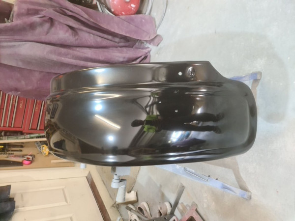

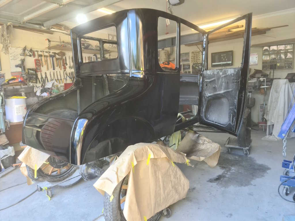

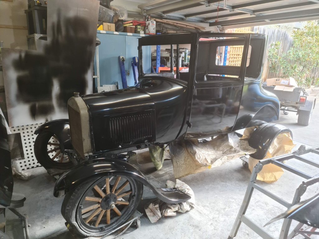

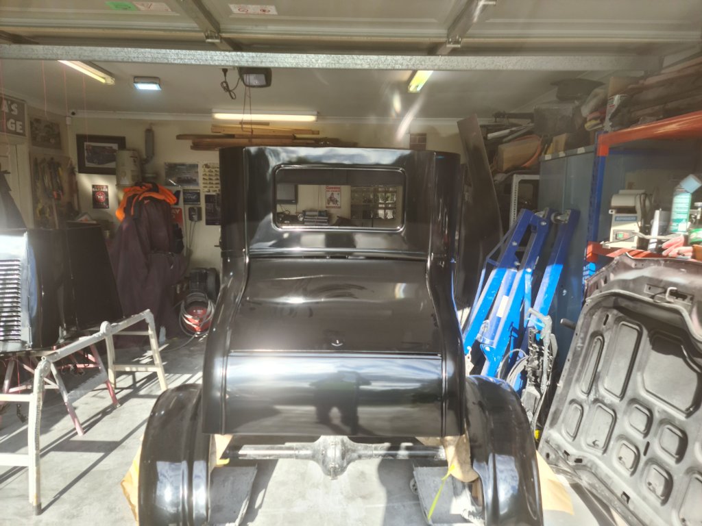

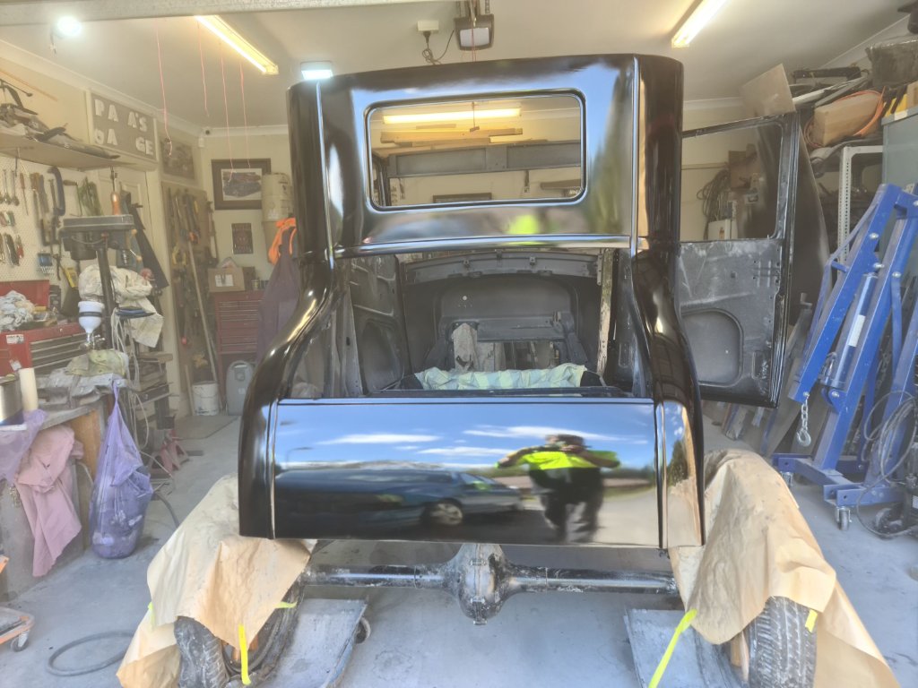

Here is yesterday and today's progress. Im happy considering it's first spray job.This is before a final rubdown and last coat.
Big big thank you to Luxford for his time on Saturday on the phone. What a wealth of knowledge.

Luxford
- Posts: 290
- First Name: Peter
- Last Name: Kable
- Location: Australia
Re: Paint
Hi Shawn,
Just noticed your post.
Congratulations, full marks, wish all my students listened as well as you have.
email first part, pskable@
- Posts: 7038
Re: Paint
Nice job Shawn.!
You should be grinning from ear to ear.
