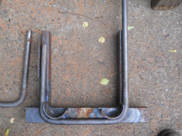

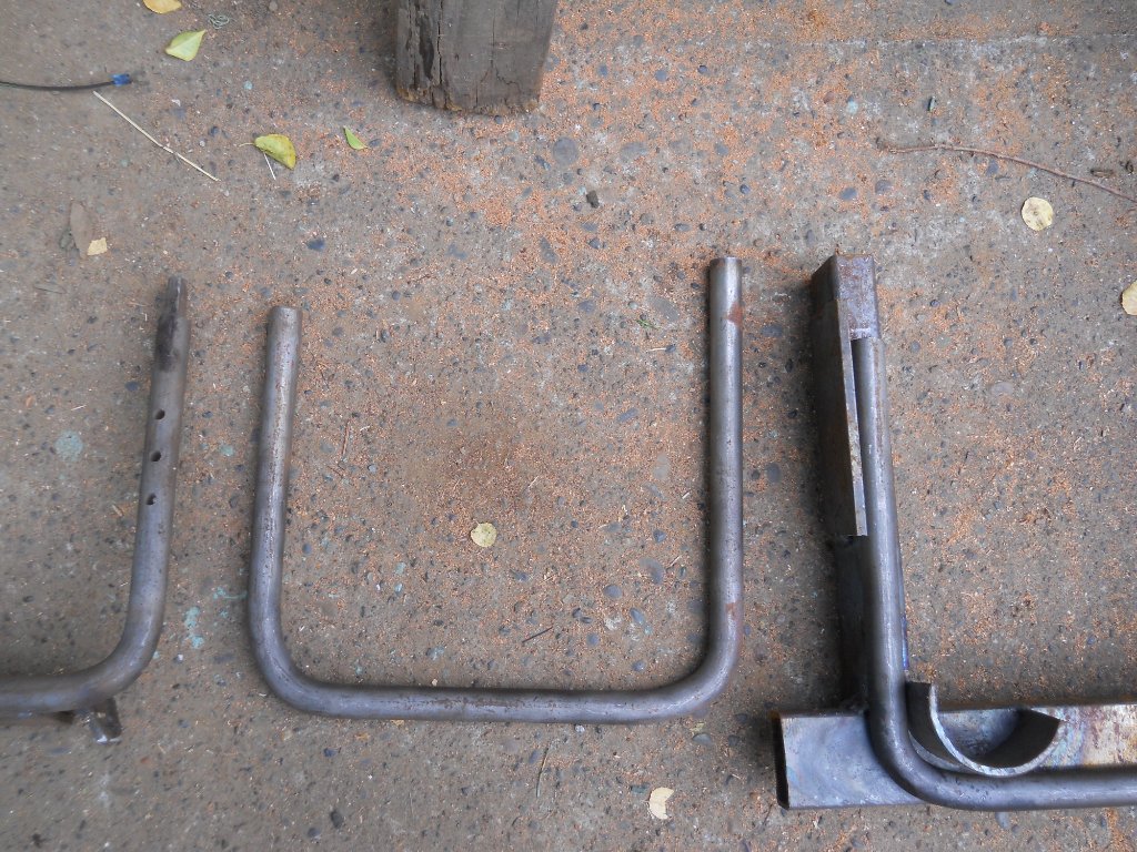

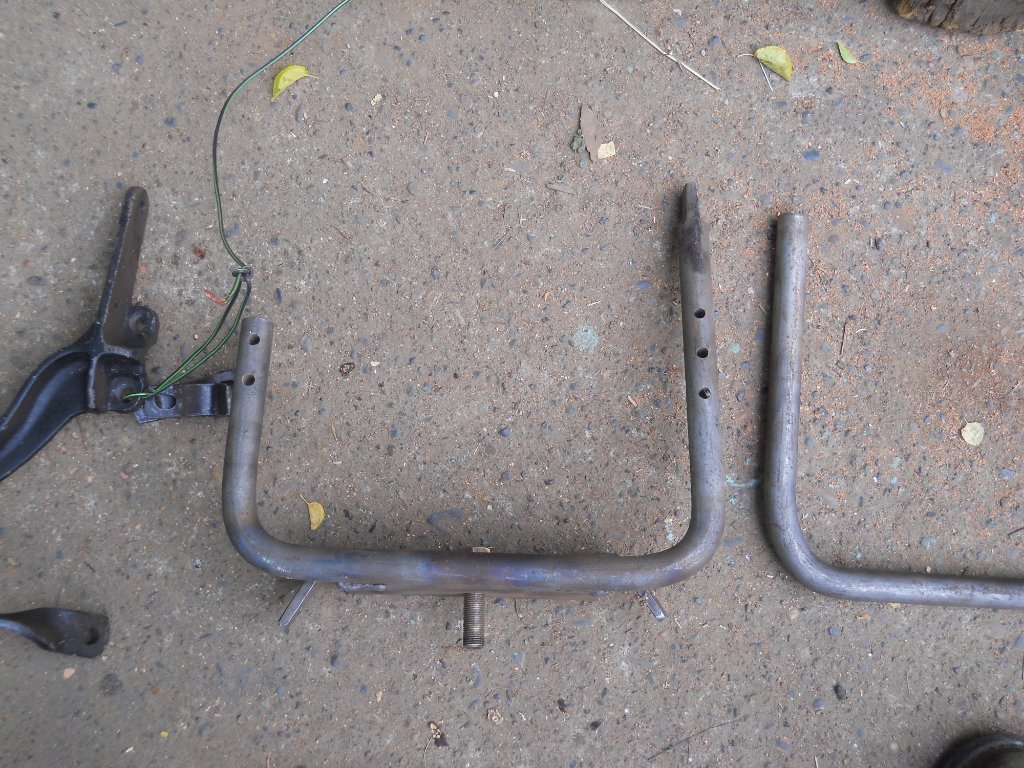

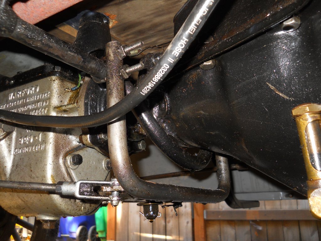

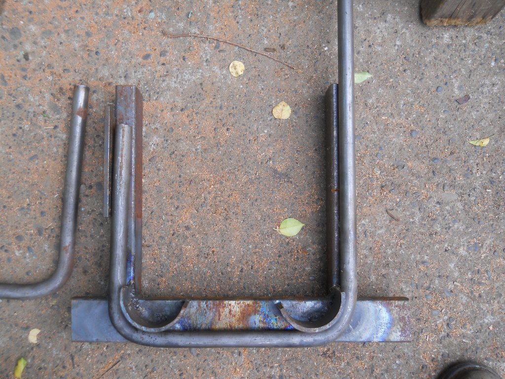

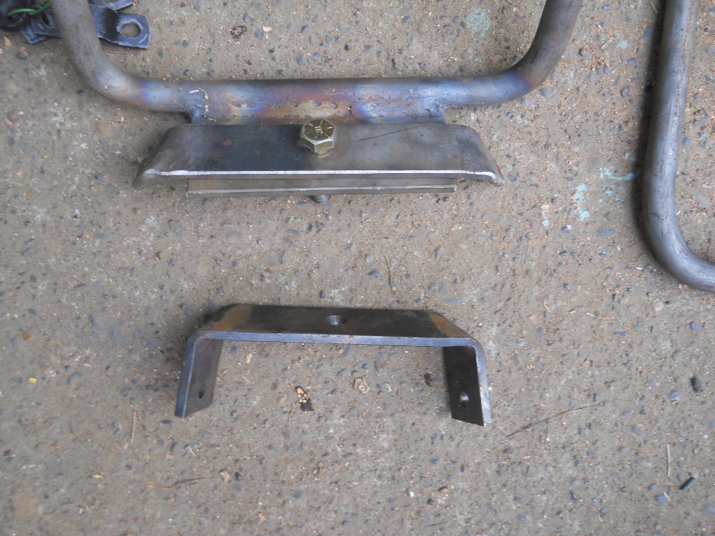

Posts: 5472
Last Name: Gregush
Location: Portland Or
Re: 26/27 Brake equalizer kit - RHD?
Post by Mark Gregush » Thu Sep 09, 2021 12:55 pm

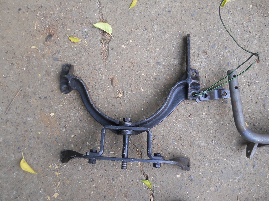

All dimensions are approx. 11" across, 4" from top clevis hole to center of parking brake cross shaft, 6" to center of sliding crossbar. Tab to mount equalizer, 2 1/2" flat stock by 4" long. Equalizer bar 10" center to center for clevis pinholes 1-1/2" flat stock. I bent the ends down on the first ones I make, but found worked just fine leaving flat. For the adjustable rod between the brake pedal and equalizer, notched it using a saws-all to fit the clevis I was using, allowing a bit of wiggle room. For mounting to parking brake cross shaft, U-bolts were used. Do not need an eazy-slider with this setup, it clears the pan and dip in the parking brake cross shaft, so does not move the brake pedal when parking brake is applied.
Posts: 5472
Last Name: Gregush
Post by Mark Gregush » Thu Sep 09, 2021 12:57 pm
The force torque should be about the same as the equalizer sold. Mounted on the car;
