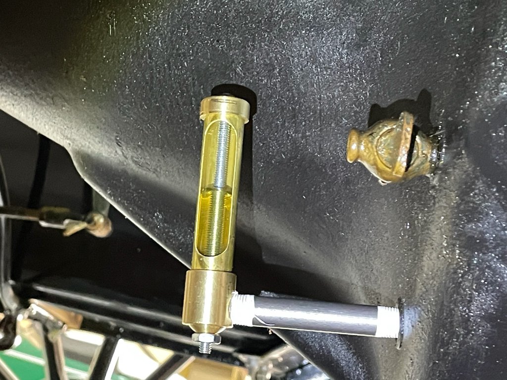

Hello....I put an oil sight gauge that I purchased from Snyder's on my car during the last oil change. It seemed to make checking the oil level very quick and easy because it is easy to see the oil level. Last night I started draining the oil out of the car when I realized how late it was and decided to call it quits for the night without refilling the oil. This morning I took a peek under the car and noticed the oil level in the Oil Sight Gauge had only gone down a little bit from where it was even though the oil pan was empty.
All I could think of was the engine running with no oil while I was thinking it was full of oil.
Anyone else have this problem? I am thinking about a dipstick to assure accuracy. What works best?

Looks like an air lock issue. You oil is perfectly clean and that only is like that until you start the motor.

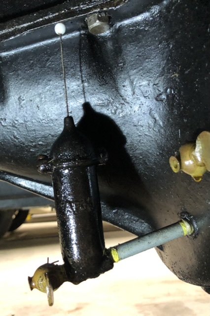

I have two of those units on my cars and they work quite well. What you need to do is drill a teeny tiny hole in the top of the cap so that the oil equalizes in the tube. By teeny tiny hole I mean the type of drill bit that folks use to build model trains. You will have folks probably come on and tell you that the next rock that goes underneath your car is going to break the glass and drain all the oil and you were going to ruin your engine. What I did was take the glass out and substitute plastic tubing. I have been using them for over 20 years and I’ve had no problems.
It’s too bad they have to be modified with the tiny hole and plastic tubing but it is what it is. Mine were free in a box of spare parts so I paid nothing to begin with.

I drilled mine a bit bigger. Once the engine starts, the oil is pulled out of the sight glass anyway.

Make sure the top of the sight glass housing is vented, otherwise you'll get the air lock issue that someone else mentioned.

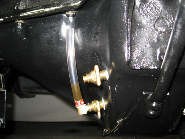

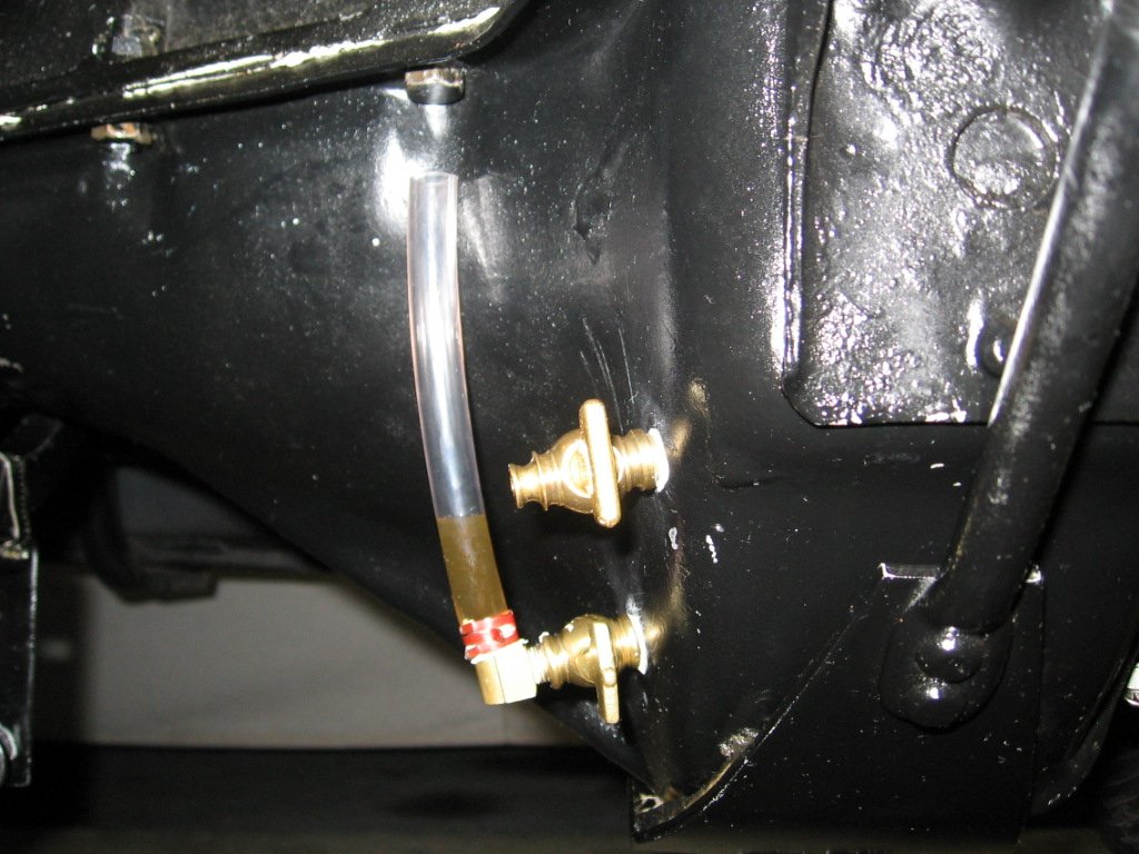

I made my own sight glass from a double male thread petcock (not easy to find), a right angle fitting, and a piece of clear vinyl tubing. The tubing is completely open on top for maximum venting. I only open the petcock when I want to check the oil level, otherwise it is closed.

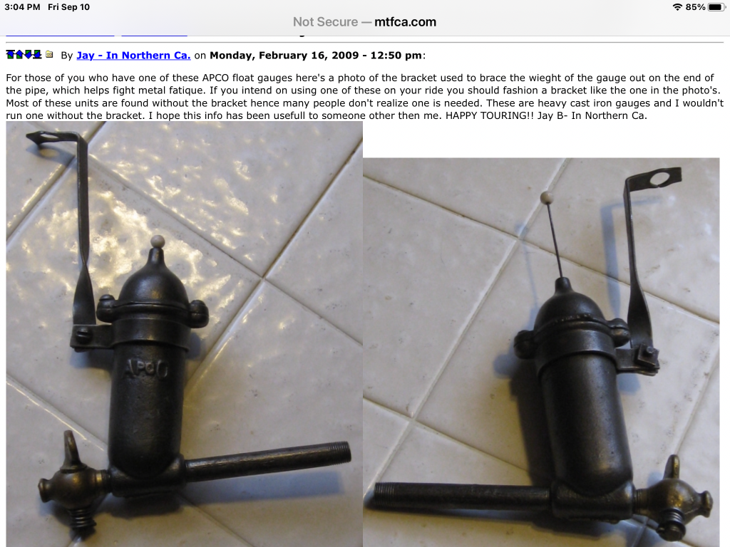

Michael, I like that APCO unit, but there is a small metal strap missing in your photo. That pipe will fatigue and break over time. The unit is too heavy to be without it. The metal strap attached it securely to the pan bolt. If you cannot find a pic, I’ll do some digging.

Thanks for the heads up… I had no idea there was a strap. Most have probably been thrown in the trash because they look like spare bent metal for no particular purpose. I will make one from “plumbers strapping”. I’d bet no one under 60 years old knows what plumber’s strapping is……Dropacent wrote: ↑Fri Sep 10, 2021 1:14 pmMichael, I like that APCO unit, but there is a small metal strap missing in your photo. That pipe will fatigue and break over time. The unit is too heavy to be without it. The metal strap attached it securely to the pan bolt. If you cannot find a pic, I’ll do some digging.

Courtesy of Dr. Jay

I run a sight glass on my firetruck because some one stripped the top petcock hole out so I had to weld a plug in it. My sight glass has a small hole in the top to let air in and out so it reads accuratly. The issue you will find with the hole is if you tow on a open trailer the wind from high way speeds will syphon the oil out of the hole all over your trailer. Mine has a hex cap so I put a plastic cap on it to solve this. Yours will probably need a small hole in the cap also. As far as rocks hitting it and breaking the glass, I would limit my speed in reverse to under 20 mph.

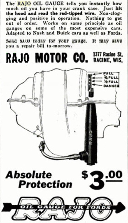

WOW....thank you everyone for the feedback. I really like the idea of the RAJO oil gauge and I may look into that some time in the future. I still like the idea of this glass gauge and I want to see if I can make it work. Based on the advice all of you have given me it seems like my logical path forward would be to drill a very small hole in the top to create a true vent. I should also check the level after the car starts because the oil level should drop when you start the car...if it drops it is working and if it does not it is not working. Lastly, the top valve is still in place...so I should manually open it and see if a little oil will drip out just to make sure the gauge is telling the truth.

I have an early/period sight glass on mine, it has a small hole in the top....if you park unlevel with it full, she leaves some behind.
I have never had any problems. I will say, if it’s 1/4”-1/2” down, it needs close to a quart.

Make sure it has a vent hole
And it's clear when engine is running good chance it show low or empty as oil is elsewhere
Could have blockage in the tube to the pan
If that glass breaks youl wish you didn't have one

Don't the new sight glasses already have a vent hole in them? bobt

Mark’s set up is the ultimate addition / improvement to the original factory parts. I use the same but just push on
the plastic tube over the original lower style valve every time I check the oil level. Clear accurate reading.

I would extend the plastic tube up into the engine compartment and secure it with a downward facing half-loop at the end to keep out dirt and water. The extension could be made of steel or copper tubing which could be routed and secured easily. The plastic section could have a slotted section of metal or hard plastic tubing slipped over it to keep it straight and give some protection. I would attach the extension to a point near the sight glass and above the oil level to prevent flexing at the point where it connects to the engine pan.

Holes the size of a human hair have a way of getting clogged up, especially if they are under a car and oil is present, and a plugged vent is likely the cause of the OP's issue. The correct oil for use in sight glasses is Marvel Mystery Oil. I take reasonable precautions to keep dust and grit out of my engine. That includes using a carburetor air filter and placing a filter (a metallic mesh pot scrubber, ScotchBrite brand ) over the hole in the block where the throttle rod would be if it had the earlier style linkage. The scrubber pad is wedged between # 2 and # 3 cylinder and is held in place by the main bearing bolt head. It allows air to pass, but picks up enough oil to trap most dust. Keeps bugs out, too. Beyond that, I avoid driving behind other vehicles in dusty conditions. My car has a fan, which I believe helps reduce the amnount of road dust that gets into the engine compartment, but it still gets some dust. The fan pulls clean air from ahead of the wheels through the radiator and pushes it into the engine compartment, which probably helps keep the much of the heavy dust kicked up by the front tires out.

I'll ask again. Aren't the sight glasses already vented? It seems if they were not vented none of them would work.
- Posts: 8440
Re: Oil Sight Gauge problem
They are supposed to be vented, since they cannot possibley work if they aren't. The only way to know if yours is, or if the vent is clear, is to examine it.
