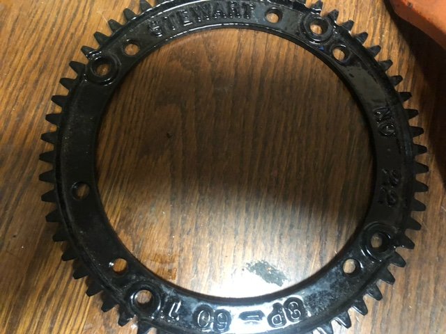

I need to mount the Stewart gear on the wheel of my 1911. Has anyone made a tool to center the gear on the wheel? Would someone have one I can borrow? Thanks, Art

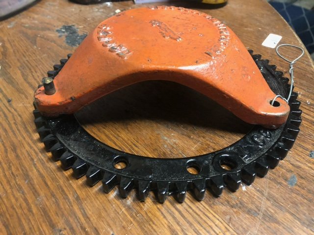

I just received Kims tool, Can some one explain how to use it? I just aint seeeing it. There are four mounting holes in the gear. Art

Art, the earlier gears do have four mounting holes. It looks like Kim's tool is for the three hole gear which came later. I have in my bits, a 4 hole gear which has never been drilled at the mounting bosses. It is drilled elsewhere with just the three holes, so it looks like Stewart were also not wasting older materials.
You may still be able to use Kim's tool. The whole idea of the tool is to fit the gear concentrically to the hub so the swivel gear meshes constantly. If you mark just one point with the tool, it will be at the correct spot. Let the gear tell you where the opposite one needs to be and let the tool tell you how far it needs to be located out from the hub. Then the other two should fall into line in the same way.

Try the tool in the three holes in your road gear I marked below.
Be sure the three slight "marks" you make on the spokes with the tool are just
outside the wheel hub so the spacers sit vertical to the spoke right next to the hub.
I used the four hole in the 1322 gear on my car.
With the spacers, they fit just outside the wheel hub
and can be done easy enough without the tool.
In any case, lay the wheel horizontal, set the spacers on the wheel and the gear on
top of the spacers to be sure it fits before drilling.

That helps a lot. Thank you. Do you line it up with the three holes and then mark the four holes to mount it? Art

Art,
I believe you are correct. Be nice if someone would chime in.
I've mounted the road gears but didn't have the tool, however.... see if this approach aligns the road gear.
Lay the wheel horizontal with the hub cap side down and supported so it doesn't wobble.
With the inner bearing in the hub, set several spacers on a few spokes. The bearing lines the tool up on the wheel.
Run the three pins in the tool down an equal amount. I assume they are threaded and coned to line up the road gear.
Then set the tool on top of the road gear with the pins in the three tool alignment holes.
Take some wire ties, rubber bands or string, and attach the road gear to the tool at the three pins*.
Set the "tool/road gear" into the hub inner bearing and down on the rough positioned spacers.
Move the spacers in proper position under the four "bossed" mounting hole locations.
Mark the hole location on the four spokes.
*Would be easier to shift back and forth to get the spacers where you want them
with the tool "attached" to the road gear.

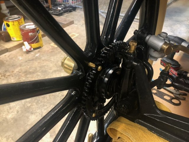

Thanks for the advice. I just finished getting the gear installed. Now I need to find a metal driven gear for the swivel. Art
