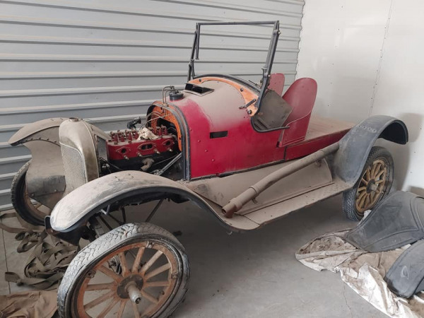

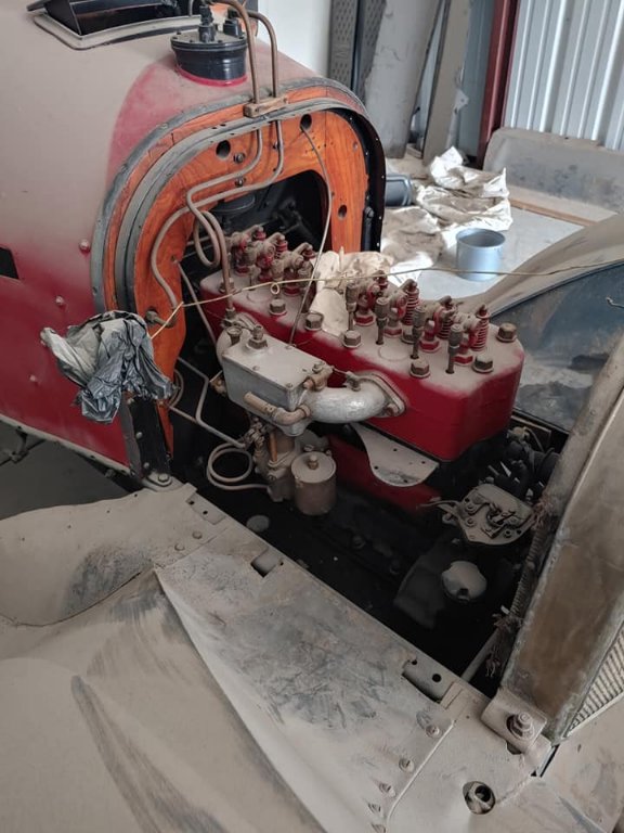

Trying to get the guy that posted this to show it here. But encase, he doesn't. Note lack of water outlet on front of head. Guessing, maybe it was moved to rear?

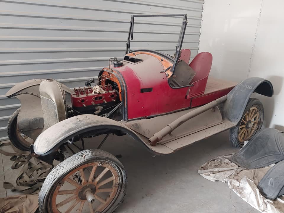

Re: Cool speedster on Facebook
For a while, Duncan and Fraser offered that front skirt from fender to fender on their special wide body roadsters. Thankfully, mine did not have one, as they were quite ugly in my eyes.
Is the head a Roof?
I don't know my overheads as well as I should...
An interesting overhead no doubt... and have no idea what it is. The Roof 8 valve heads had 3 exhaust ports, and definitely had a water outlet in front. I suspect that the wad of paper towels stuffed between the rockers are plugging the upper water outlet...?
