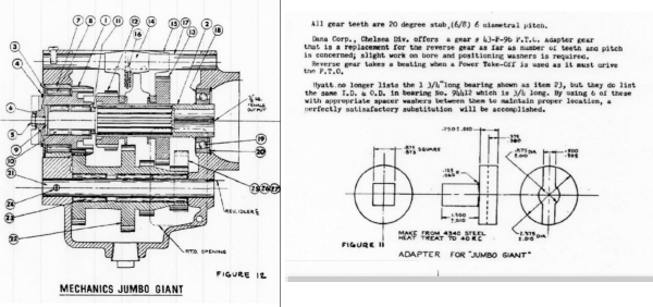

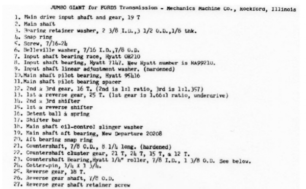

Would anyone have a list of replacement bearings for this transmission?
- Posts: 5273
Re: Jumbo Giant transmission 3 speed with reverse
Had it apart yet? Hyatte bearings in cluster? Did disassemble one with bronze bushings in cluster. Early version? Restored one years ago. Was able to get all new bearings over the counter. Surprised me. Not like a warford. Didnt keep the part #'s. Good luck, I like em.
Topic author - Posts: 5557
I have not pulled it all the way down yet. Kinda doing an early search to see if there is a list like the cast iron Warfords.
- Posts: 6592
Not done searching appears to be another reference that this was taken from http://www.mtfca.com/discus/messages/50 ... 1420996116
Thank you Frank. That information is very helpful.
