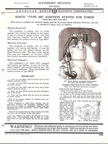

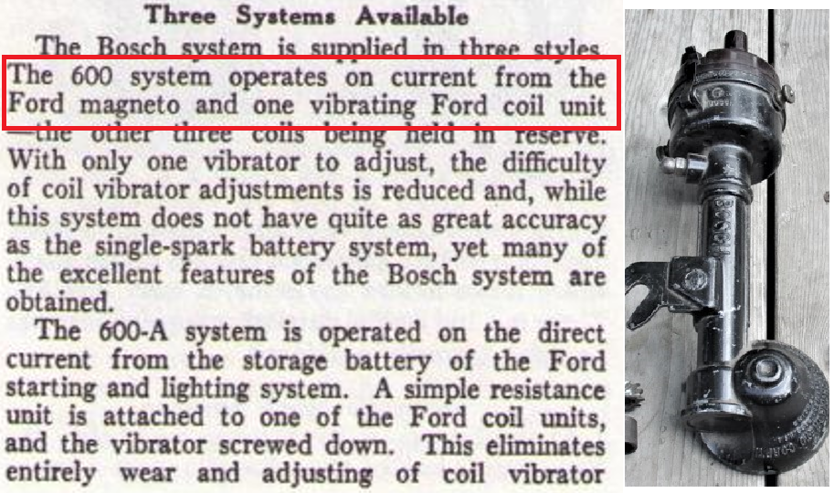

What Brand/model distributor is it? A period correct distributor such as the American Bosch 600 is documented on running on one buzz coil and magneto. Not sure of the other popular ones of the time. The instructions for the Bosch 600 do say not to use the Bosch Coil and run on magneto. As stated above changing the ignition system to use a distributor and run on battery is a good sign that there are issues with the magneto. It could have even been removed. So pictures and answers to the questions (coil box, modern or buzz coil to the distributor, etc). There are also some additional reasons why there is a distributor besides Magneto issues: a set of new coils may have prompted the switch or if its a Bosch 600 it has centrifugal advance to no need to play with the spark leever
Here are the setup's - don't see why it wouldn't work for any distributor made for a T.
There are some discussion on the internet on setting up a automotive coil to run on AC. Basically it involves using a dimmer capacitor and coil (similar components to a buzz coil)
