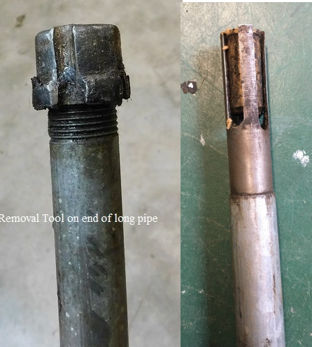

Got this tool with some model T parts. It came in a Snyder’s tube package don’t know if it came from Snyder’s though. If anyone is interested in it I’ll sell it to you.

Would that be to drive out the drive shaft bushing, and miss the rivets? Could you list some dimensions? Solid or hollow tube/pipe?

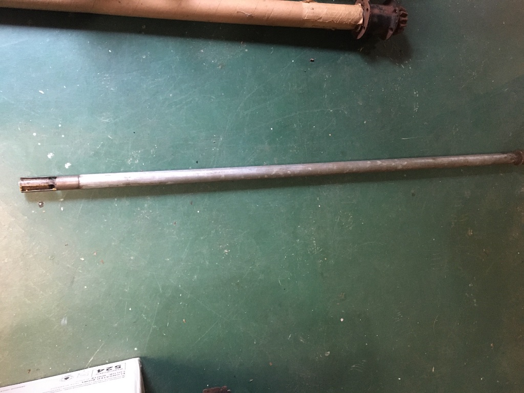

Dimensions:
From end to end it’s 53” long. It does have a threaded cap on the other end so that number could be different if the cap is off or threaded all the way down
Just the pipe length with the cap is 48 5/16” long
Hollow pipe

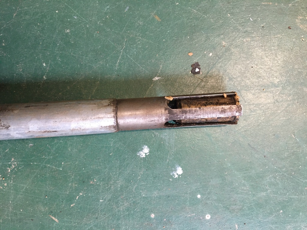

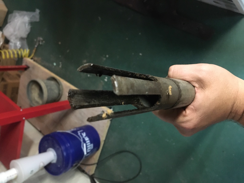

Post by TRDxB2 » Tue Sep 14, 2021 11:16 am
I agree with Pep. I made a tool to remove the drive shaft bushing from a MTFCA or Fordfix - looks functionally the same to pass around the rivets on the ball cap end. The description: length and a threaded pipe cap end would also follow as something to pound on
