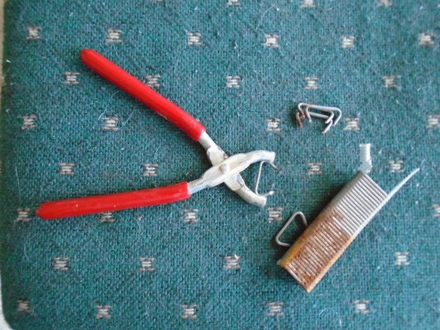

There is a tool called a Hog tie for fastening the springs try Langs[attachment=0]DSC01039.JPG

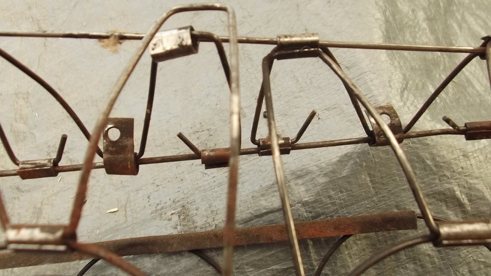

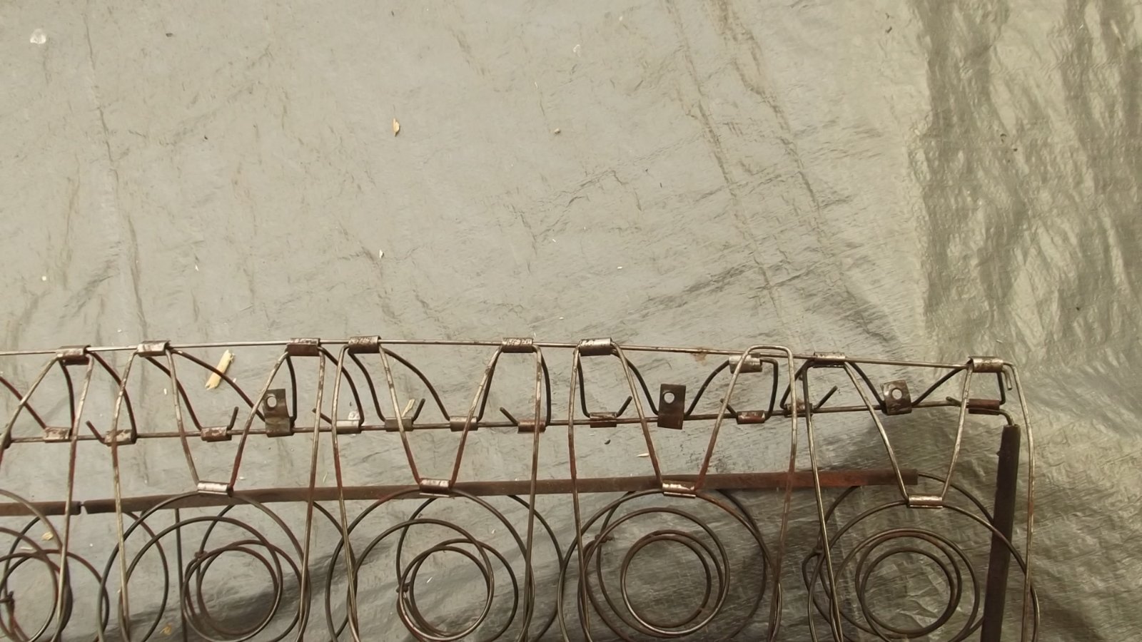

The hog rings are for attaching the material to the springs that can be taken out. Most all the Model T open cars used a channel in the bottom spring to clamp the fabric. The back rest spring would be attached with a strip(s) of material or there would be little bent metal hangers that are screwed to the belt rail. The bottom of the back rest spring is not attached, it just hangs there. Then the padding and cover are attached to the belt rail. The photos are of a 1920ish back rest spring clips.
