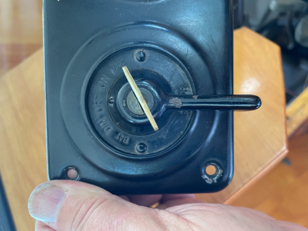

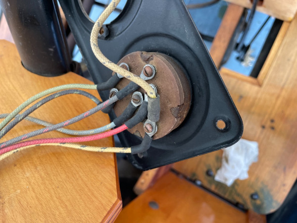

Newbie here, both to Model T’s and to these forums, and this is my first post. I’ve successfully used the search function for several other issues, but I haven’t been successful in finding much on repairing the ignition switch.
I’ve had my 1925 Express Wagon for a couple of months now, and the engine runs fine on battery, but won’t run on magneto. The magneto is producing an AC voltage; the problem seems to be that there is no continuity from the magneto wire (red) to the coil wire (blue/yellow) on the ignition switch when it’s in the MAG position. Is repairing this switch something that someone with average mechanical skills and decent electrical skills can do without destroying it (I successfully repaired my ammeter), or should I send it to an expert? I lean a little toward being an originalist, so I want to save the new repro option for last.

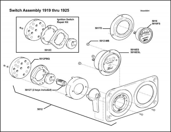

Looks like your switch hasn’t been apart in a while. They aren’t hard to repair but if you haven’t had one apart send it to Ben Martin. If you have another switch like the one you have you can carefully pry back the tabs and the switch back will come off and you can see how they work. Another style that’s used a lot is the twist in type that’s identical other than the way it attaches to the back of the switch. Those two styles are the most common to the 17-25 T’s.

Hopefully your mag switch issue is in the switch. If it turns out it still won’t work on Mag it could be it’s the top contact post where the issue is.

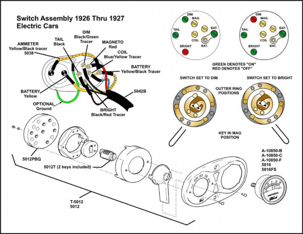

Model T ignition switches Both the 1919-1925 and 1926-27 operate exactly the same, the key operates the inner ring of contacts to select the voltage source and handle operates the outer ring to select the light preference. The contact in the center of the inner ring makes contact to the corresponding coil contact on the switch backing plate, It is the outer contact the positions itself to one of three places when you turn the key - there is a small indent that it rests in when OFF -turn the key to the left to MAG or right to to BAT. So if you didn't have continuity in the MAG position it is possible that the brass on the bottom of the MAG post is oxidized. A quick fix is a rubbing the entire backing plate on a some fine sand paper. Or purchase a new backing plate if yours is warped. Note groves form in the underside of the backing plate and should be on no consequence. There is no point in bending the outer contact since it makes contact with the BAT position. NOTE the backing plate is in its correct position flipped over, thr inner contact ring is turned to MAG

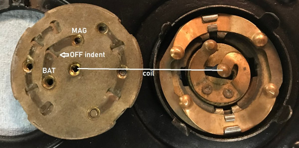

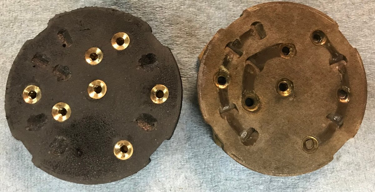

Your switch looks like this one with the clips...even though the one below it is a 26-27 switch, all plate switches work exactly the same and are wired the same too (with the exception of that green ground wire, that's not really on any of them).
Sometimes your magneto doesn't work because you over shoot when switching to it, this is usually because the detentes in the switch wire plate are not deep enough to hold your switch lever from going past the magneto contacts (the detentes are the holes without the contacts in them). This happens because over time they get worn almost smooth, so drilling them a might deeper may fix this problem, at least that's what I did to mine to fix that problem.
Personally I'm not big on keeping original parts, because they DO wear out (eventually) and sometimes you've got to admit there's no fixing it. You could wait for a local swap meet to happen and see if you could find an NOS switch plate there or you could buy that new repop switch, which I know you don't want to, but you may have to consider that option anyway. Those tabs on your switch housing look a might too rusted to bend without breaking off entirely. Anyhoo, you could always buy the new switch and remove the new switch lock barrel and key and replace it with your old switches parts and you can paint those shiny nickel plated rivets on the front with black fingernail polish (brand Finger Paints, color Black Vinyl...it's the blackest black I've seen in fingernail polish), scar the shiny black surface of the new plate and switch handle with a piece of 0000 steel wool and it wiill look just like your old switch. And don't cheap out and get the one with the plastic backs, they're crap...get the ones with the factory style heavy card. The detent holes are deep and hold really well.
