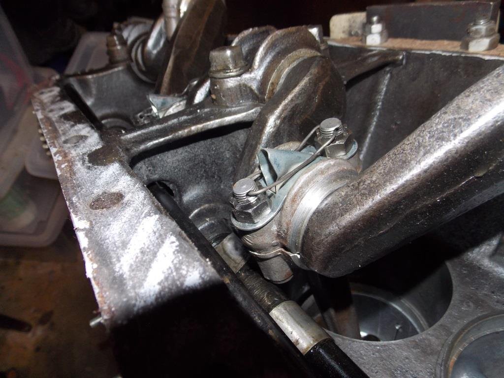

Motor is a fresh rebuild by someone else. I dissembled & fixed what was missed, like slightly bent rods & completed. New time saver bearings. All new. DM bronze gear @ .006. Stipe 280 super (all cyls ckecked to perfect spec)Piston/head clearance checked W/O head gasket. Rods checked .004 piston clearance. Sounded like a loose crank pully? Possible over advancement on timing lever. possibly worse on bat. Set up for mag (15 motor)
Didnt hear any unusual noise before I released it. Had a Montana buddy confirm this. Idont know if the noise is gotten worse. I do know it can be made noisy @ full(over?) advance. I suspect more so on battery. New day timer. I saw 3 videos today & have not gotten feed back to my questions yet.
This more complete picture may have you guys figure it out before I even see it for myself. I will also follow this thread for possible issues missed.
This is more MY problem than his. Its unfortunate that he cant enjoy his T right now.
I just got out of the hospital Tuesday form a 6 day vacation & havent got to see it yet. I hope to be able to lay hands this weekend with my seeing eye dog.

Craig installed the motor & alt. Ran it with no issue or noise, I believe. I removed the alt(not charging), replaced pulley. Fan position changed W new belt. A bit small for my taste. @ acceleration horrible noise. Fan sucked into radiator wire mount tab, Fixed that? Fan pulley got loose & clangy. Replaced that. Newer pully loosed again?? If so, why? Maybe a new billet unit?

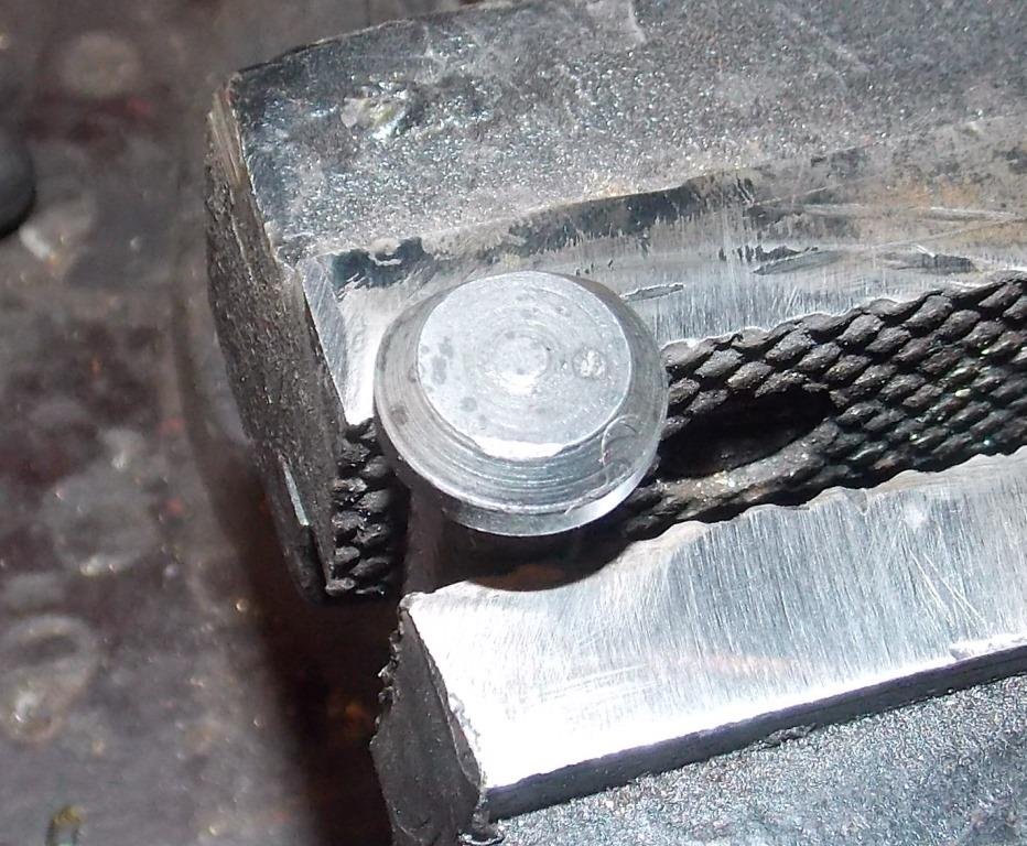

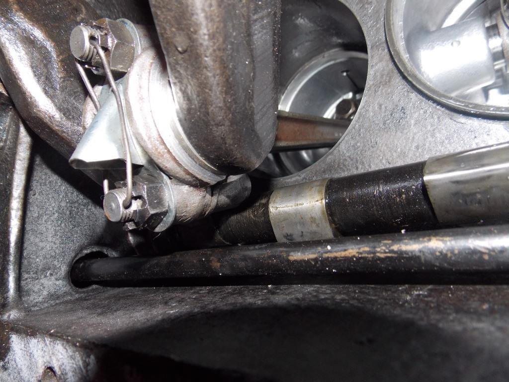

A while ago I was working on an engine that made about the same noice when running.
Took it all apart and only when I put the second piston back in place I found the noice.
I was one of the rod bolt head that touched the camshaft. Grinded the head and the noice was gone. See photos .
Just a sugestion where to look.
Good luck
Andre

- Posts: 6669
Re: Engine noise from freshly rebuilt engine.
Andre
that is an astute observation. Considering most every other suggestion has already been checked for, this is quite plausible.
- Posts: 5045
Head was checked for clearance without a gasket in all directions of head bolt slop by hand cranking. No hint of contact. Adding the thickness of the compressed head gasket, Do you still think pistons hitting is possible?? This may be possible. I may be able to check with a bore scope in each cyl.
