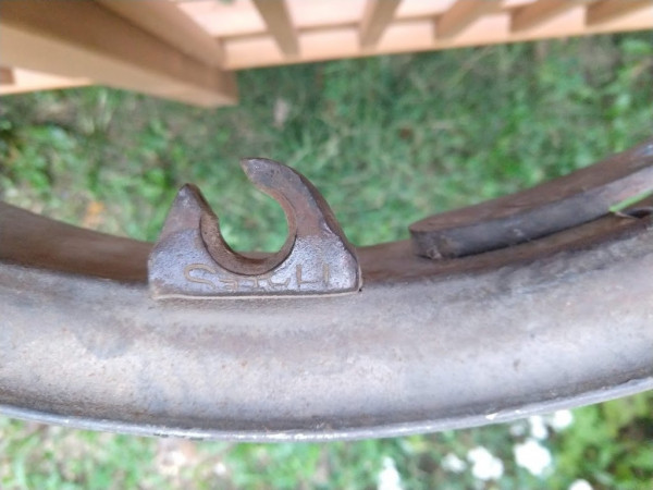

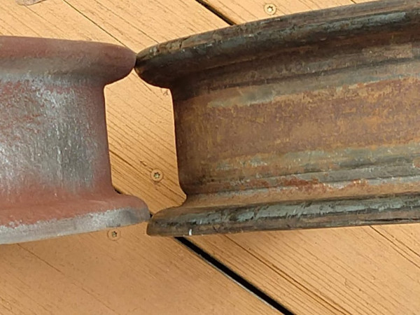

I need help identifying a rim I just purchased. It is a split rim Hayes, advertised as a 21 inch. However, it is different from other split rims that I have. The overall size from outer edge to outer edge of the new rim (on the right) is 21 and 3/8ths and the width is 3 3/4 inches. My other rims are 22 1/4 outer edge to outer edge and only 3 1/2 wide. Also the rim weighs about 11 pounds as opposed to one of my other rims which is about 7 pounds. The Hayes rim has a bolt for the rim lock and my others have the flat lip which slides sideways. Can somebody educate me on the rim? Is it for a truck or a different (non-model T) car? Why is there a cut in the lug? Will my 4:50x21 tires fit this rim? The lugs of the new rim do NOT line up with the other lugs when I place the rims on top of each other. Will this rim bolt fit on to my other non-Hayes felloes? Here are a couple of pictures. I'm planning on using this new rim for a spare. Thanks so much,

Probably a Chevy rim.
If the lugs are in a different position the valve stem won’t line up with the wheel.

Most likely a Chevy rim. They can be identified by the cut out lug as shown. As was said, the valve stem hole wont line up on a Model T wheel, but the hole can be relocated to fit a Hayes T wheel. The Model T Hayes rims have one of the lug holes just reamed out a bit so they will fit on the wheel. Some think that lug has been worn from being run loose. Not so. Dave

The "worn" lug hole is in the lug nearest to the valve stem hole. It is slightly elongated, towards the valve. This allows the rim to e fitted Valve stem first, then lowered down, keeping the rim at an angle to the wheel, and when lowered, it can be pushed back over the felloe, the oblong lug hole allowing the lug to pass over the mounting bolt.
Because the Chev rims have the valve stems much closer to the lug, that nearest lug needs to be slotted to lower the rim and stem over the felloe
