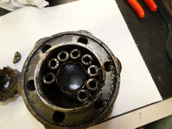

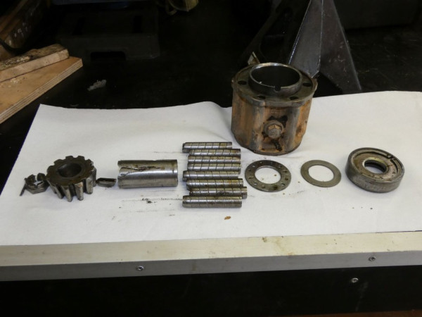

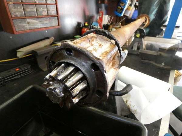

"The car was barn find and driven as it was for a few miles.
Than there was some noice the car lost traction and the brake failed".
Here is what I found.
Next step will be the rear axle inspection but I think it will be no better.

Re: There was some noice on the driveshaft and the car stopped.
babbit washers failed on either side of the ring gear causing the ring gear and pinion to go half mesh which stripped things.
