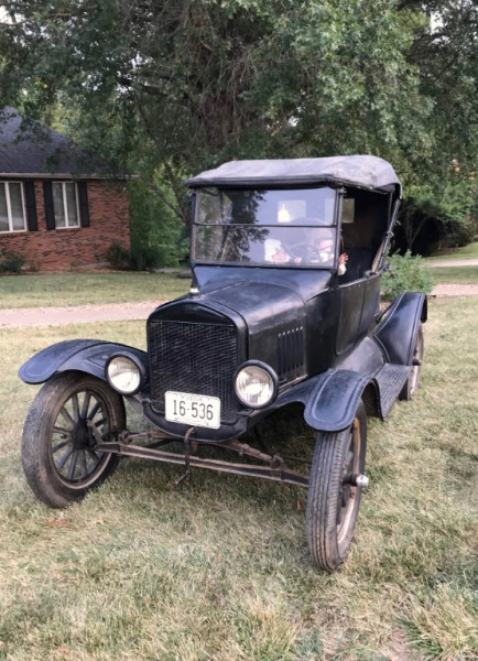

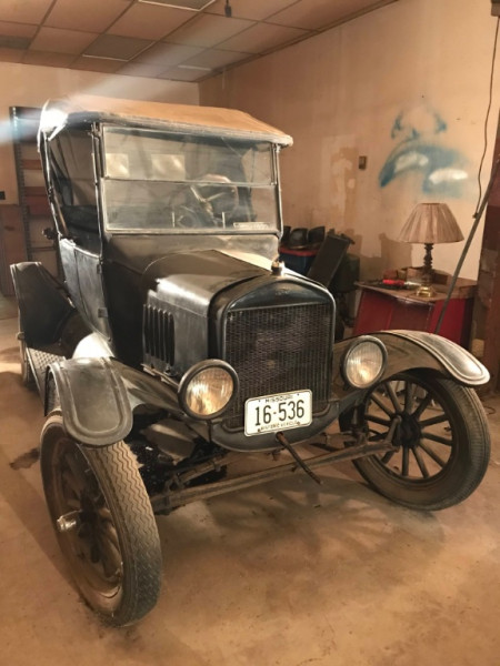

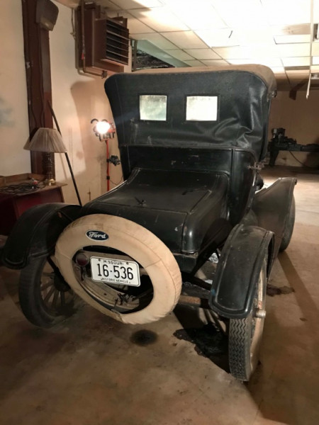

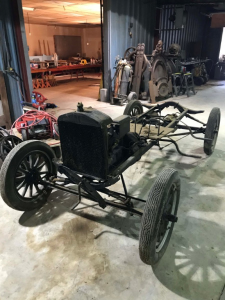

Hello all!
My dad found this car being sold from an estate and we hope to have some fun with it. It was a runner when parked so far as we know, but has sat for at least five years. A complete spare chassis was included that appears to be in fairly good shape, so we have plenty to mess with.
The engine serial dates to December 1923. Curious as to what we have here, and how much is original. First step is getting some tubes that hold air for a couple tires; what's a good source for 21" x 4.4 tubes? Next step is going through the usual deferred maintenance.

Welcome! Looks pretty original, I would say a 1925 roadster. If you can provide the engine number I can give you the date the engine was assembled. That engine number should be the VIN that matches the title (if you have one).

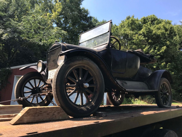

I noticed in your pictures that you have the car tied on to the trailer with a cable/ winch. If you tied it around the axle and not the frame please check to make sure you didn't pull the wishbone out of the ball socket on te oil pan.

The left front tire on that chassis, looks like a INSA tire Hecho en Chili. If it is, you have one of the longest wearing tires ever made for a T. I have 4 of them on one of my T's and they have been on it for 30 years and the sidewalls have not even cracked. I have taken that car on quite a few week long tours.

Yes, tires on the chassis are marked INSA, and there's a full set plus spare. I think we'll swap those over; they look unused and have been in a dark garage for years. The tires on the car are Allstate, and have a fair amount of cracking.

Looks like a late 24 or 25 Roadster in pretty good shape. The lips on the front fenders just under the headlights make it a 24-25. Looks like it was repainted years ago and that’s OK. It’s close enough to be a 25 just giving it a general going over by your pics. The larger 21” tires came out in Late 24 to give a T a little smoother ride. I have a late 24 Coupe that has them and it does make the car ride a little smoother.
If the engine number is in the 23 range I wouldn’t worry about. Lots of T’s have earlier or later T engines in them that were replaced down through the years. Reason being is that they pretty much all interchange in that part of the T era. Good luck with you ‘new’ T!
I would get it to going like it is after checking the oil, water and brakes and see how it drives.

Micah, Welcome to the affliction, I hope you have as much fun with yours as I have with mine. It looks to me that your spare chassis is an Improved car meaning 1926-27 it has the coil box on the engine and the wide pedals for the clutch and brake plus the wider rear crossmember. Good start for a speedster! Jim

I second checking the ball joint on the wishbone. It needs to be fairly tight and the cap needs to be secured to the oil pan with studs and castellated nuts which must be safety-wired together. Do not use cotter pins. If you are going to winch the car I would recommend attaching the strap to the front frame crossmember and not the axle. As to the coils - If they buzz when the key is turned to Battery, they will probably provide enough spark for the engine to run. Be aware that the coils only buzz in certain crankshaft (timer) positions, so if at first they don't buzz, turn the crankshaft a bit with either the starter or the hand crank. Since the car has been sitting for a long time, at some point in the future I would recommend having the coils gone over. There are several businesses that do this that advertise in the MTFCA magazine. Welcome to the affliction!
