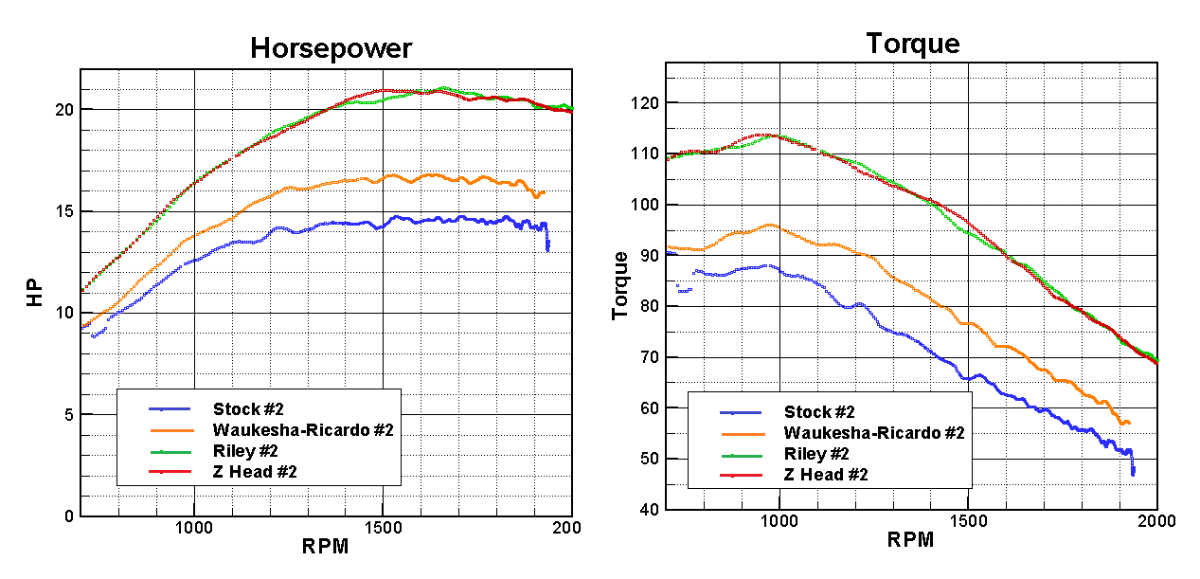

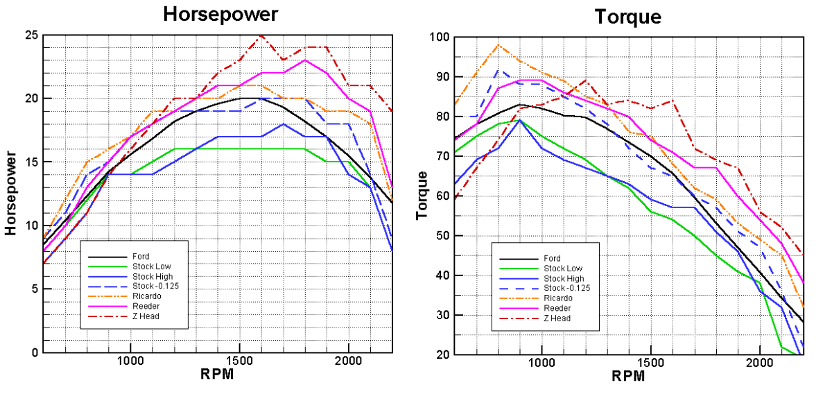

There are many ways to increase engine performance. Carbonation, intake and exhaust manifolds, exhaust system, cams, pistons, high compression heads, crankshafts. and various combinations of them are needed to gain the bang for the buck. The Tulsa Club has a good article on High compression head and design https://mtfctulsa.com/Tech/heads.htm
The charts show that Torque is what gets you doing at low RPM and Horsepower is gives you a higher Top end speed. Unfortunately the results don't mention what other modifications where made besides swapping heads Clicking on the charts should make them larger
