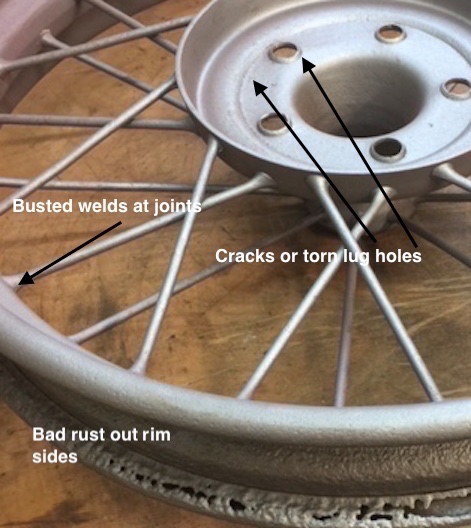

Fix for me is to drill a pair of 1/4" holes equal distance around, on both inner rim edges. Then using air pressure nozzle, and eye and nose protection, blow out the fine rust pieces and dust. I do it after the rim has been sandblasted and powder coated. Lots of stuff will fly out, continue until only minimal dust emits.
Then I have sprayed with silicone into each hole, maybe doesn't do much to stop future rust, but seemed like good idea. :)
Finally, close the holes with a dab of black silicone adhesive, that will dry and close off the holes. The tire casing will cover those areas away and you can't see those holes you made inside the rim.

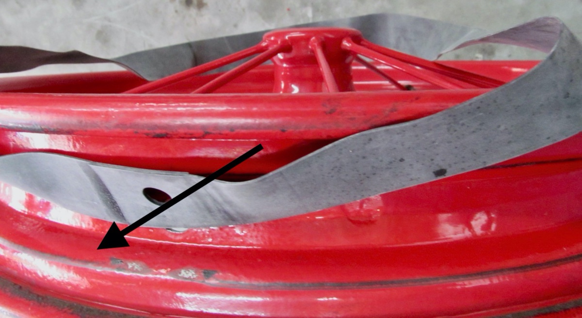

Visual inspection is the better way, unless you have x-ray eyes ;)
Some of the key points: Busted welds at the spoke joints, broken spokes, rim won't roll true on flat surface and wobbles, sure sign of bent wheel.
Look for rust out at the rim sides, and cracks at the hub, esp. the cone shape at the wheel drum area, and between lug holes. Look for flattened rim, sign the wheel was used without a tire, like on a farm wagon, and flattened the rolled edge, that would let a tire come off. Worn out, cracked or oval shape lug holes are also bad news. All the above should be checked before buying or using the Ford welded spoke wire wheel.
